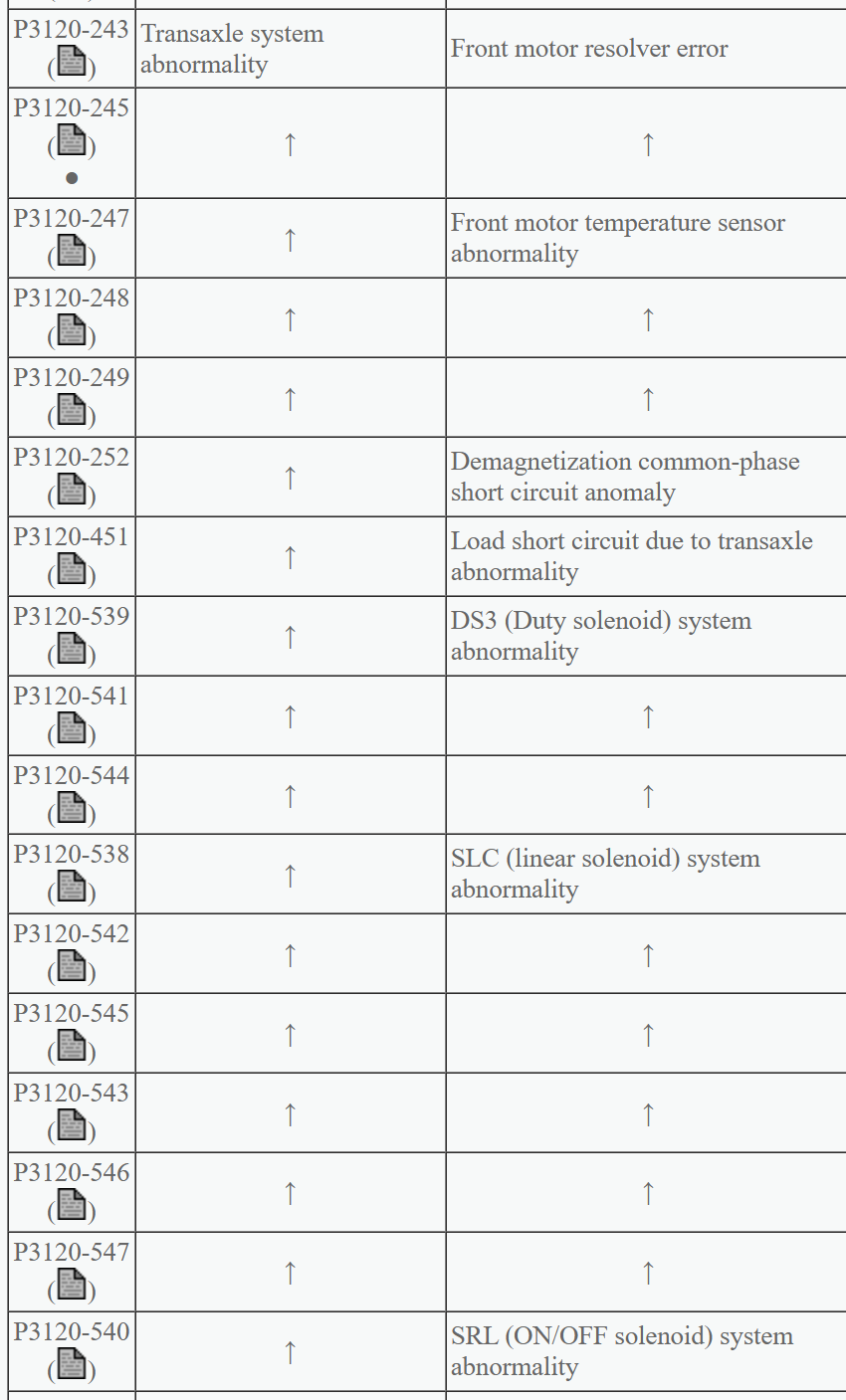

got plugged in and error code is P3120 HV Tranaxle Assay, ws told needs new gearbox. Symptoms are engine reving when trying to change gear and then jerks when gear selected. Any experience of this and where to get gearbox, would invertor need changed as well?

I have same code P3120.
Car starts(ready mode) once I put in drive/reverse cuts off. And flashing lights all over.
If I disconect 12V battery 3B1EAFF6-46F9-429F-9FDE-E064F0ED53C8.thumb.jpeg.63d11e98423d3be59f77f5a0ef00589b.jpegIMG_1799.thumb.jpeg.0ec44de077824e887cb79a8717622328.jpegCBE3CDE6-4CE2-459D-AEE5-EF417BBCF013.thumb.jpeg.35823073e0c403dd8638c214f8b51374.jpegfor +30min starts and drives as normal.
do you have any sub codes for P3120- xxxx as this will narrow down the fault
