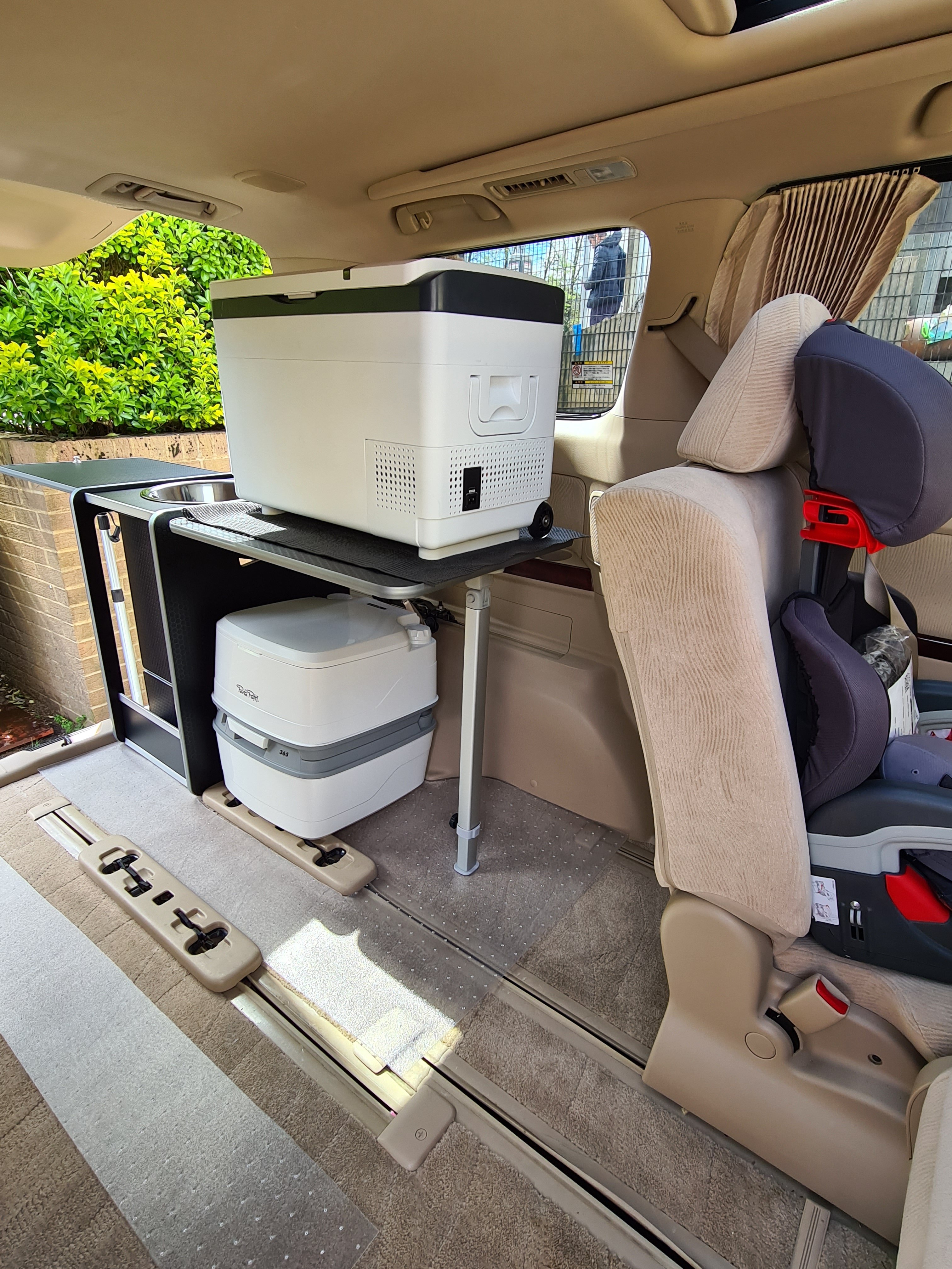

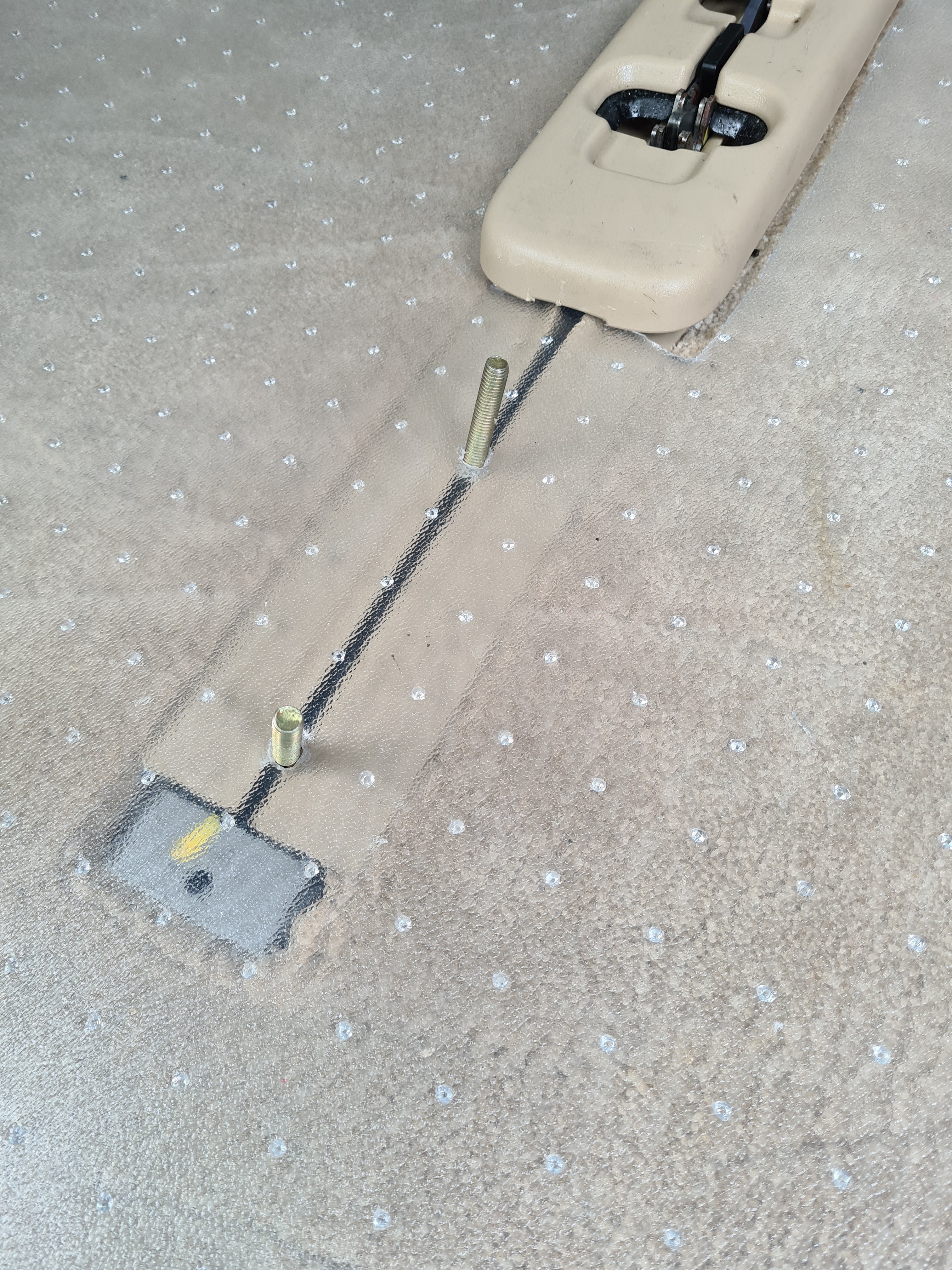

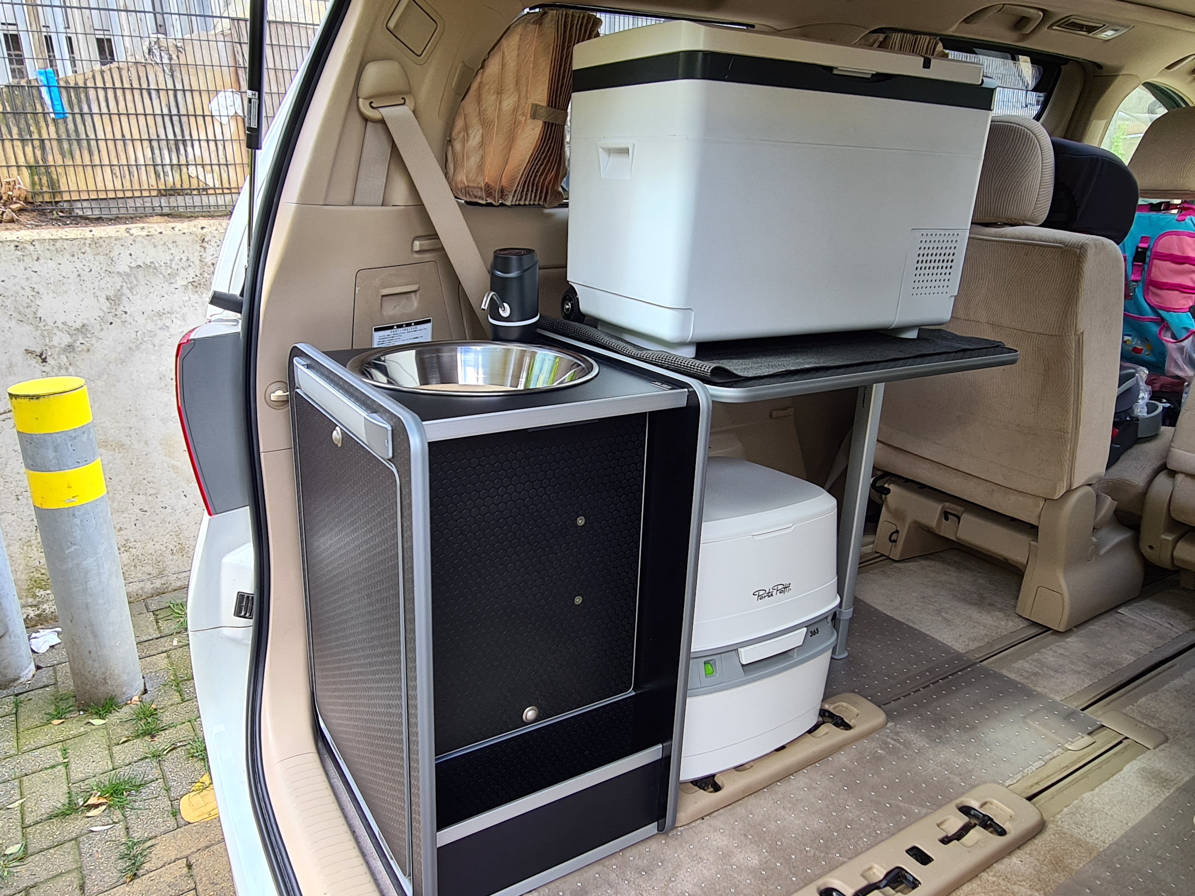

I just wanted to share pictures and details of the Vangear mini pod I just brought and installed in my Alphard.
There were some members who were interested in this so I thought I'd start a new topic.
I ordered the unit about 3 weeks ago and requested they fit an extra rail for an additional table I wanted.

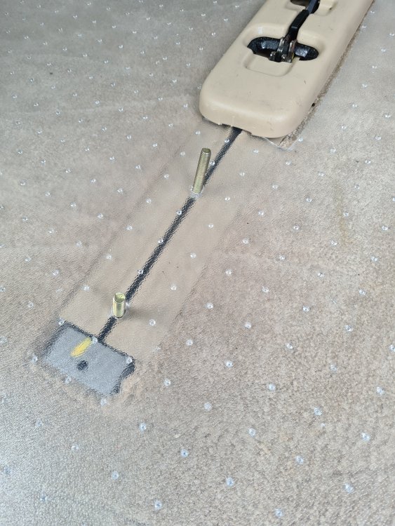

I had removed one of the rear seats and placed a plastic mat before fitting the pod.. which took about 20 minutes to fit.

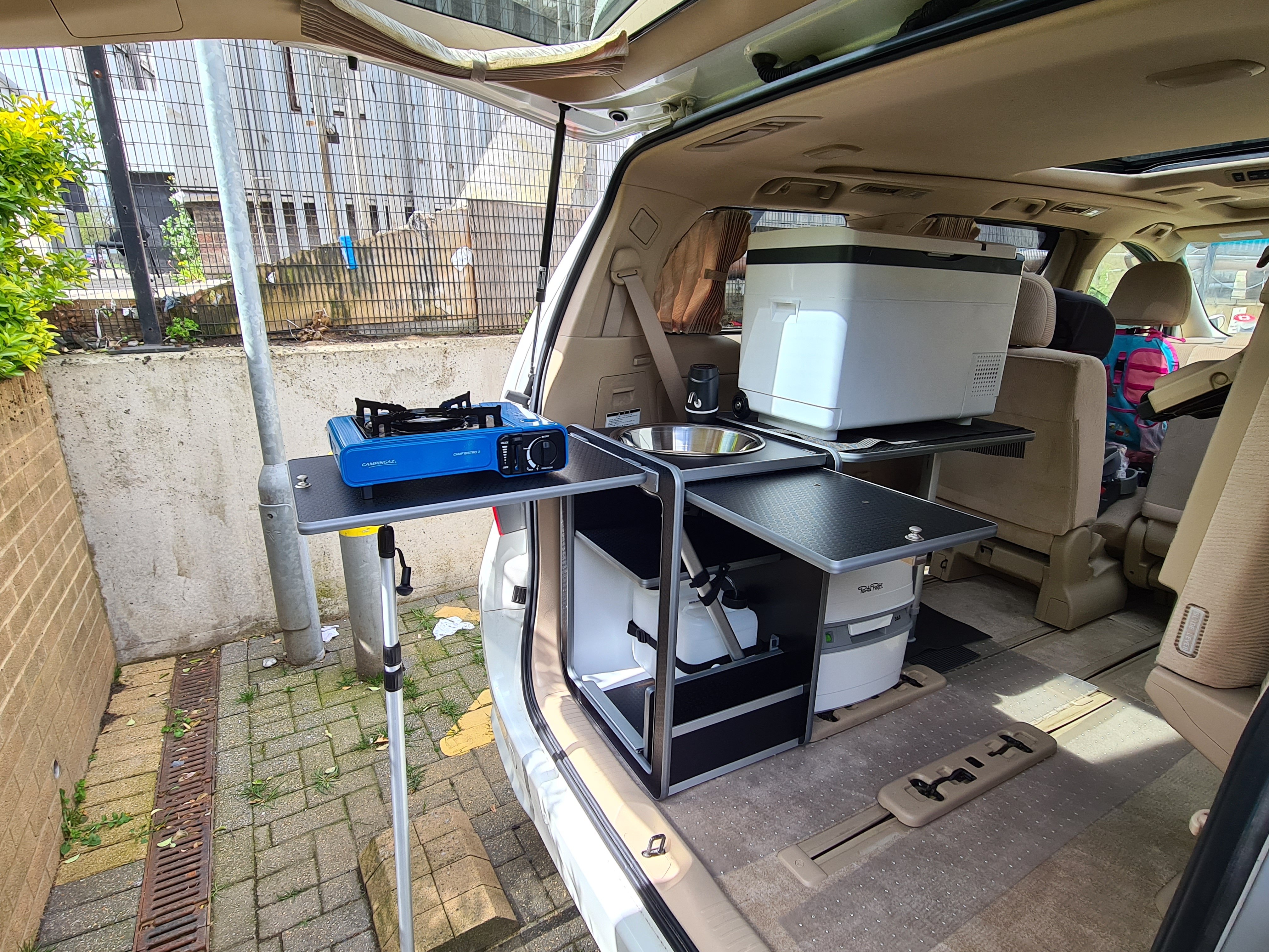

I've placed all my utensils, ridgemonkey, camping bits in the cupboard and behind the unit. I have enough space under the table to put my Thetford loo and my poweroak power station, with space on top to put my stove, picnic rugs and blankets etc..My 30L fridge sits on top when I'm parked up.
The only issue I had was that the leg for the table facing the tailgate was not meant to be long enough to reach the floor outside. I instead used an extended tent pole which I already had.. this was perfect.
The pictures I've attached were taken when I fitted the unit.
I placed all the above items and more in and around it afterwards.
This still give me the use of 6 seats 😀
I can remove the whole unit and bolt back the seat in 40 minutes if I had to.
It's a brilliant unit.
I hope this inspires you all to get out and to enjoy these brilliant vehicles.

The unit is called the black mini pod, which includes the sink, usb tap and 2x 5 L water containers. I had an extra rail fitted opposite the original table/door. That way I could have another large table inside (extra cost) -2 large and one smaller one for the stove inside altogether-
I also ordered the bamboo cutting board which fits neatly inside the sink plus 2 J bolts to secure the unit down. The black unit is slightly more expensive than the grey.
I think the total amount I paid was £680 ish.
I already had 4 extendable tent/awning poles. I use one of these to hold the outside table up. This is needed as the table sits much higher of the ground than the inside one.
I use the other 3 poles for my makeshift awning. I think I paid around £45 for these on Amazon. They're really useful and highly recommended 👌

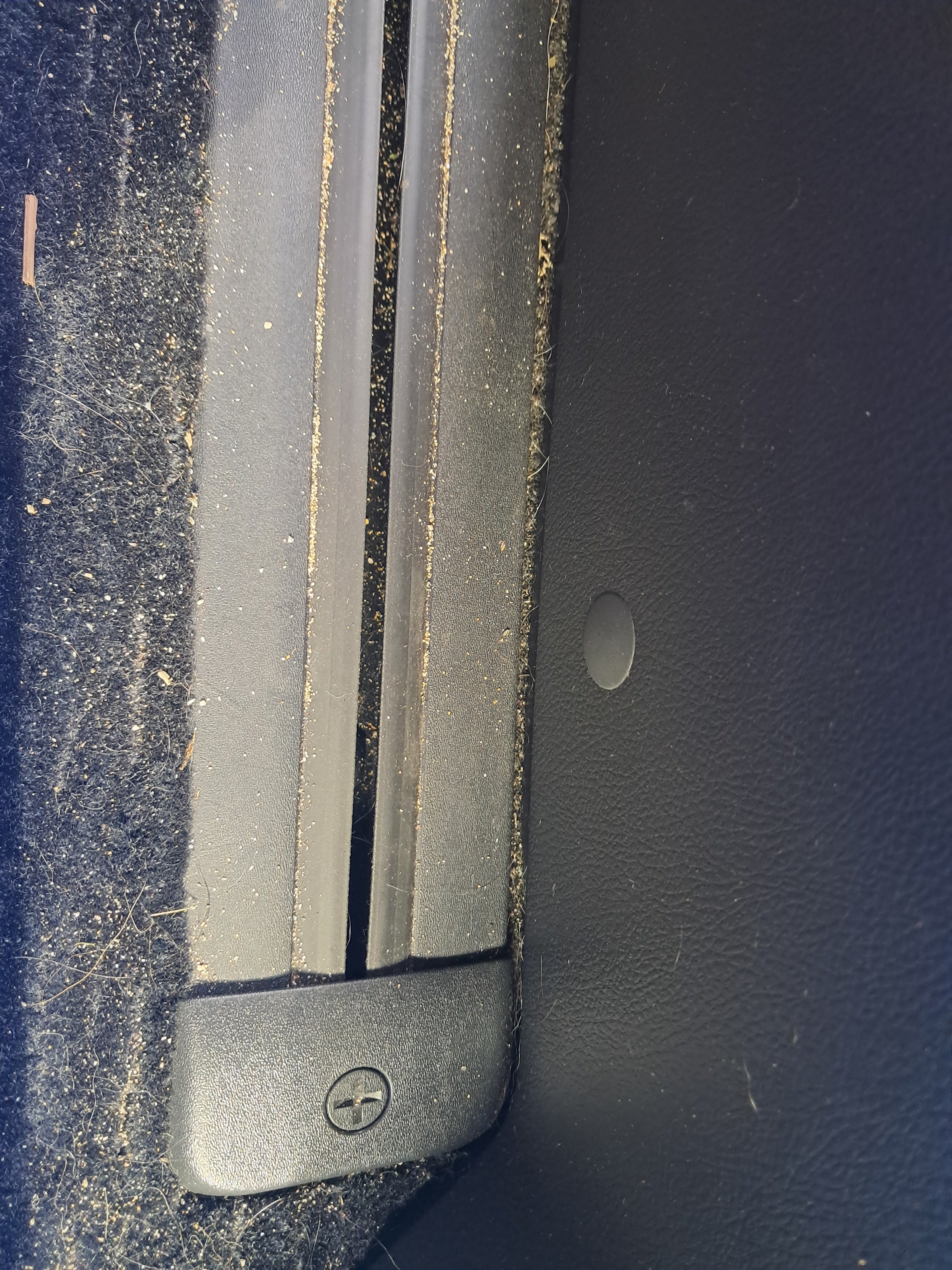

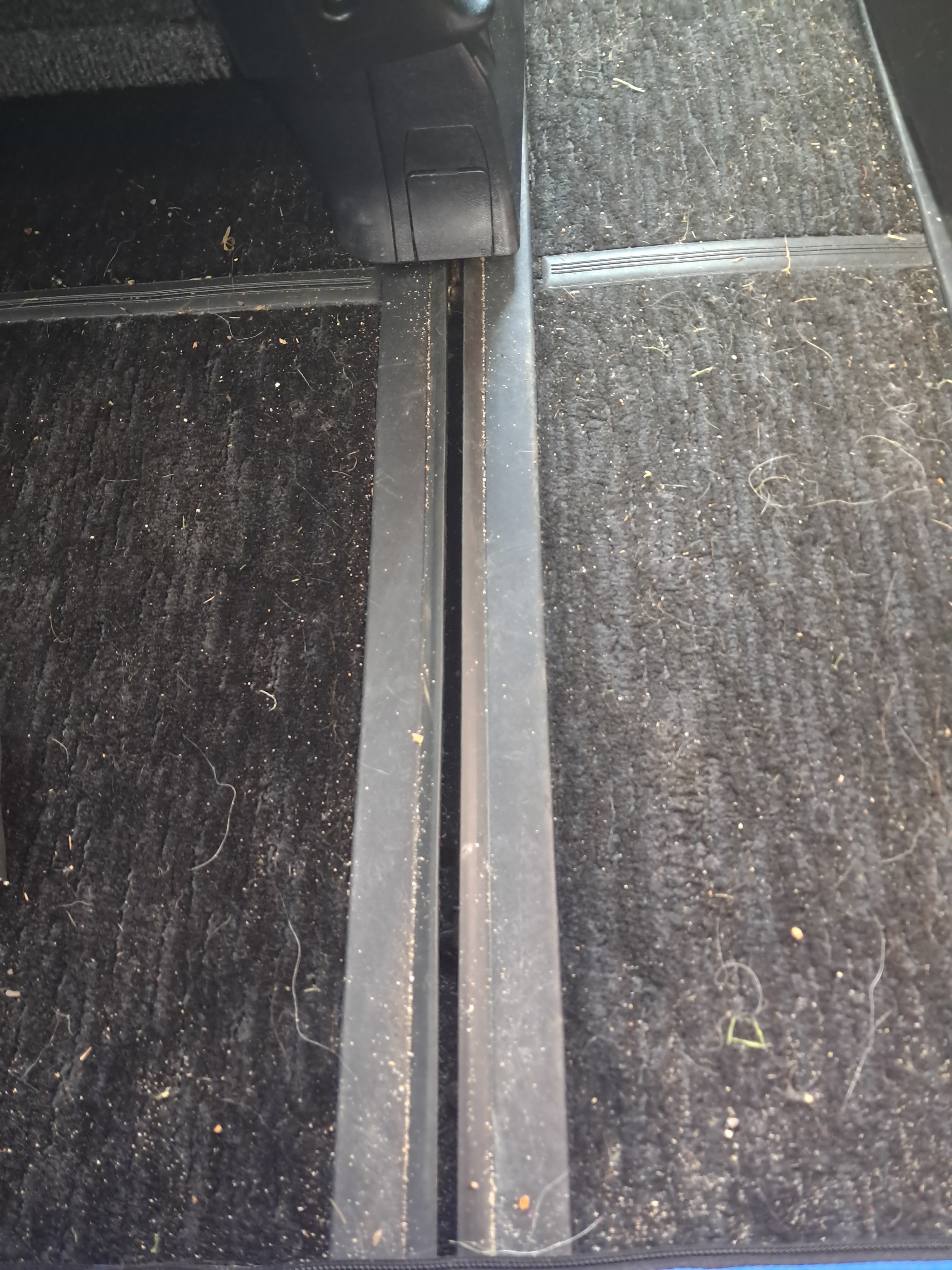

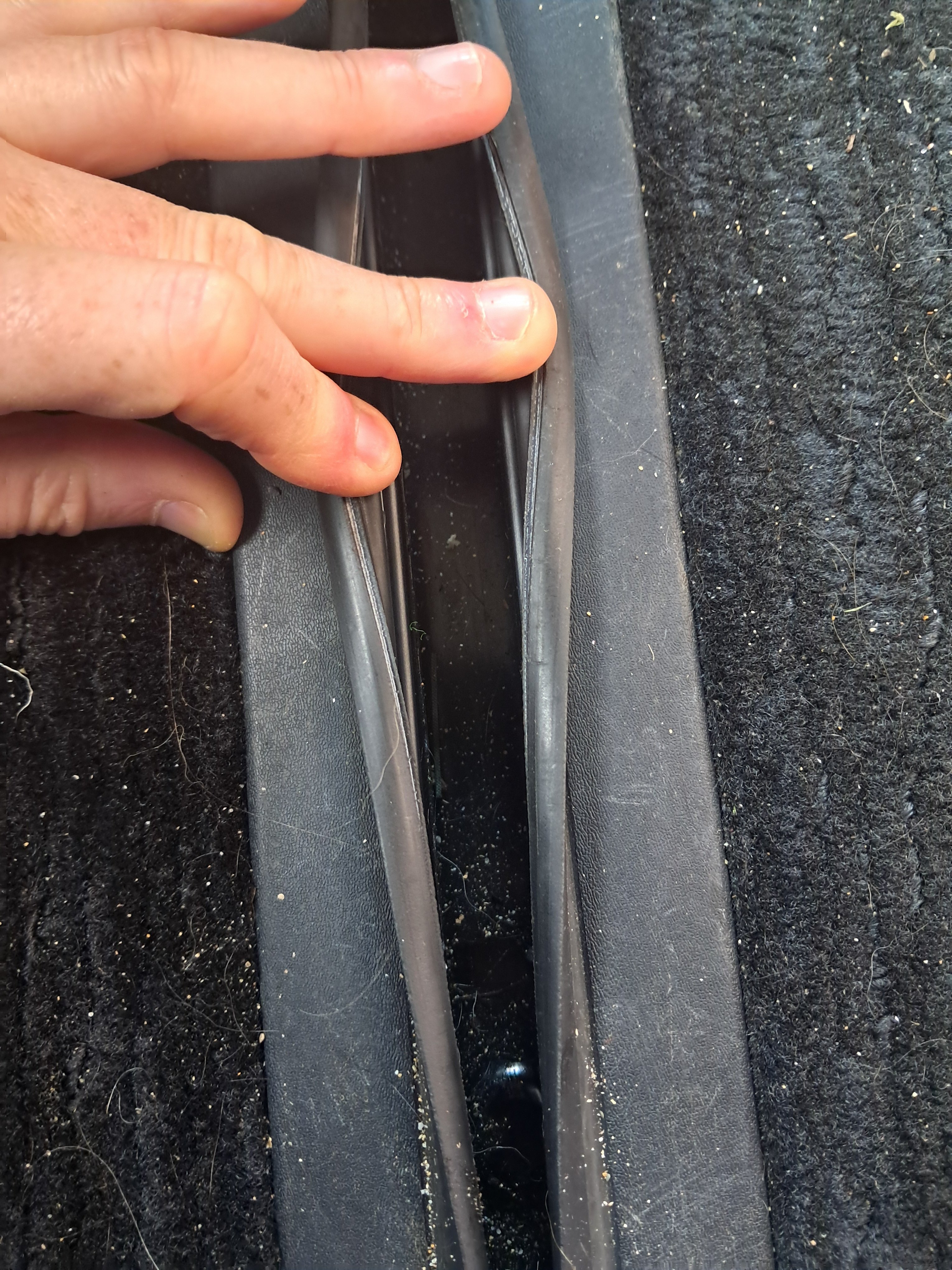

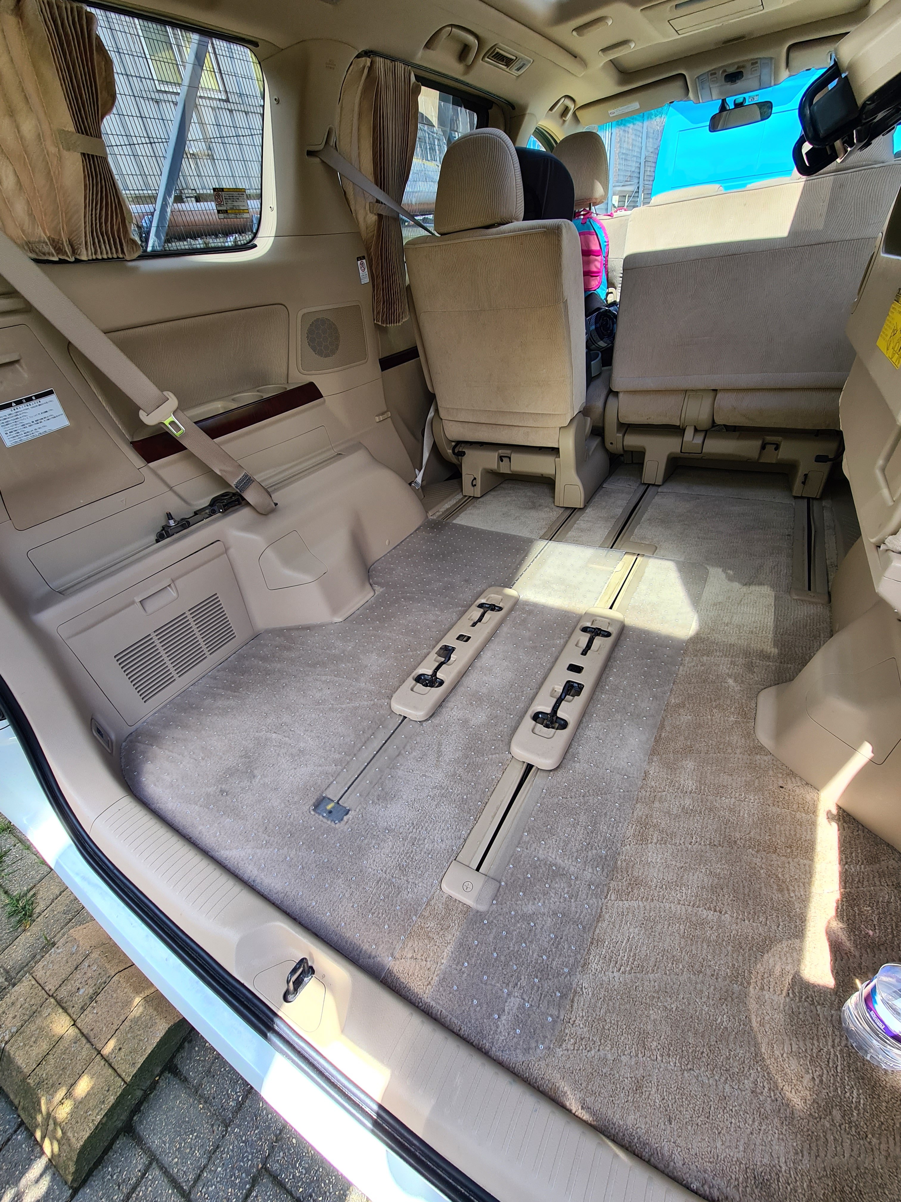

Hello, I have a 2009 vellfire and thinking about adding my own little home made teeny kitchen that can be taken in and out. I was wondering if anyone knew what clips/cleats etc I would need to attach my unit in, so it's safe? I'll add a picture of which rails I have.
