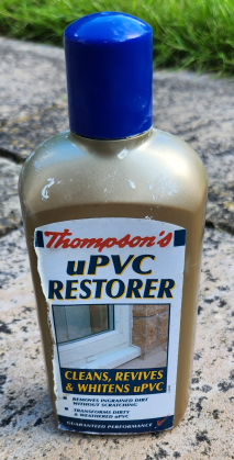

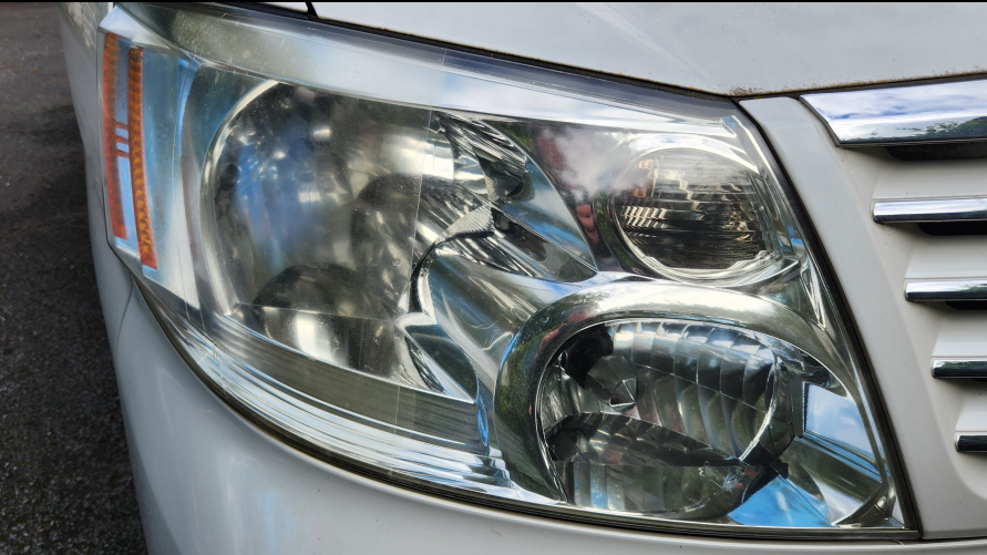

Thompson's uPVC Restorer. It's available at £7 from B&Q but these results are from my ten year old bottle. The formula may have changed since then.
The job cost me about 15 mins for both lights plus 2 J cloths. Here's my before and after picture:
Edited by Geralt
Added pic of bottle.
