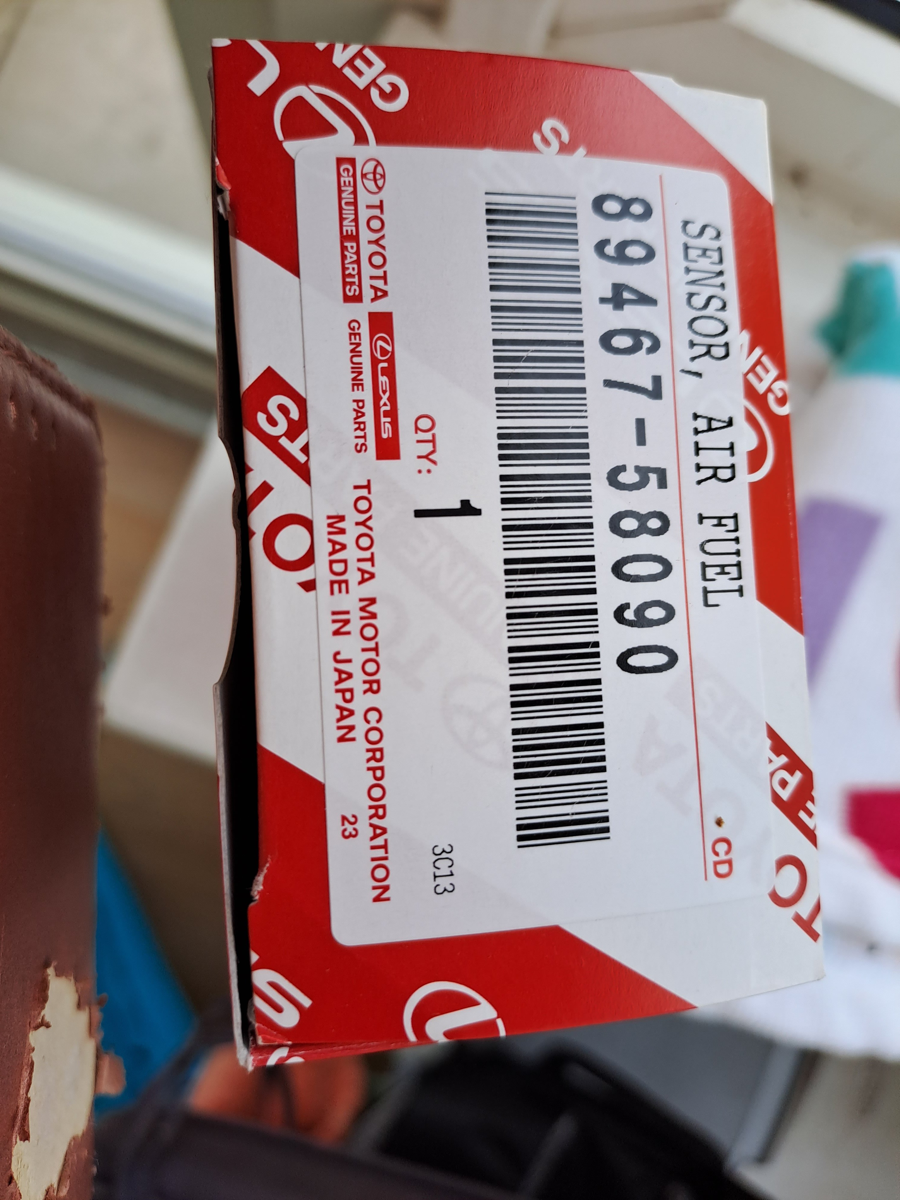

Hi,picasso looked at box that sensor came in.is a fuel sensor.trying to send photo.If this is case would cleaning Mass a,f. Be next step.Thank you yet again.Phil.20230906_124043.thumb.jpg.914193b22c6777beb4f37cbe475ed992.jpg

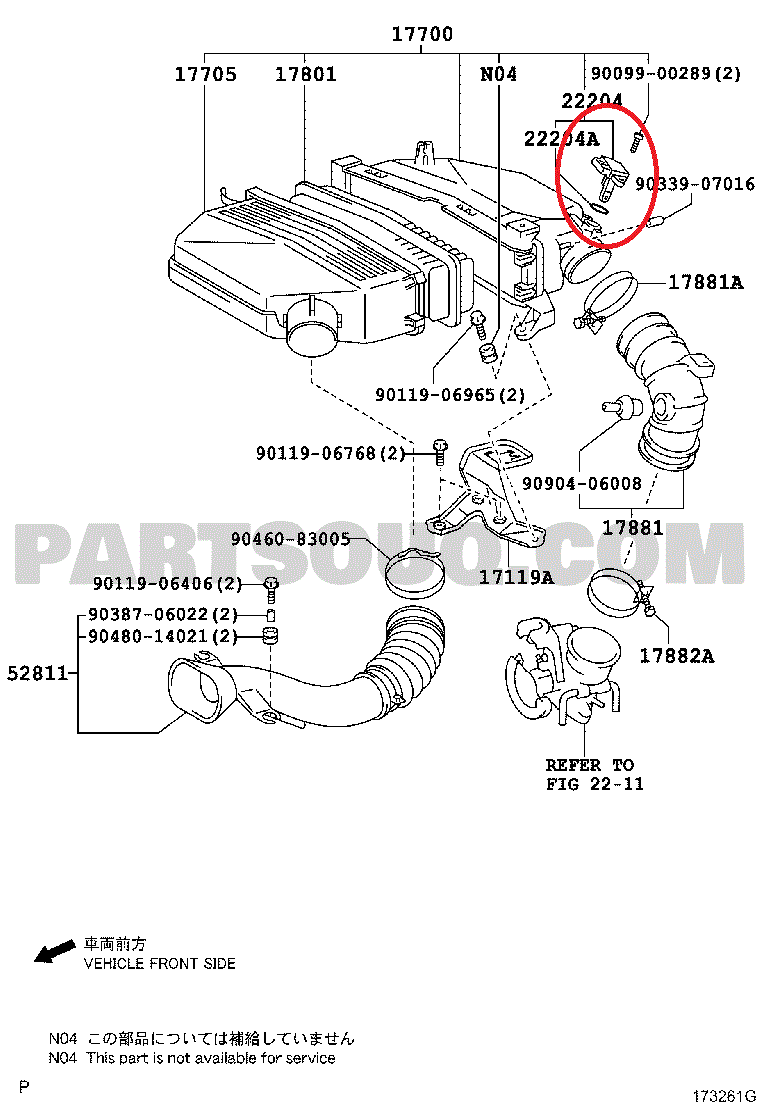

phil sorry yes you got the correct fuel sensor if i was you i would not bother cleaning the maf sensor i had this problem with my 3.0 alphard best route is to replace the maff sensor they not exspensive put oe no. into ebay  2220422010   maff sensor circled in red in the drawing
