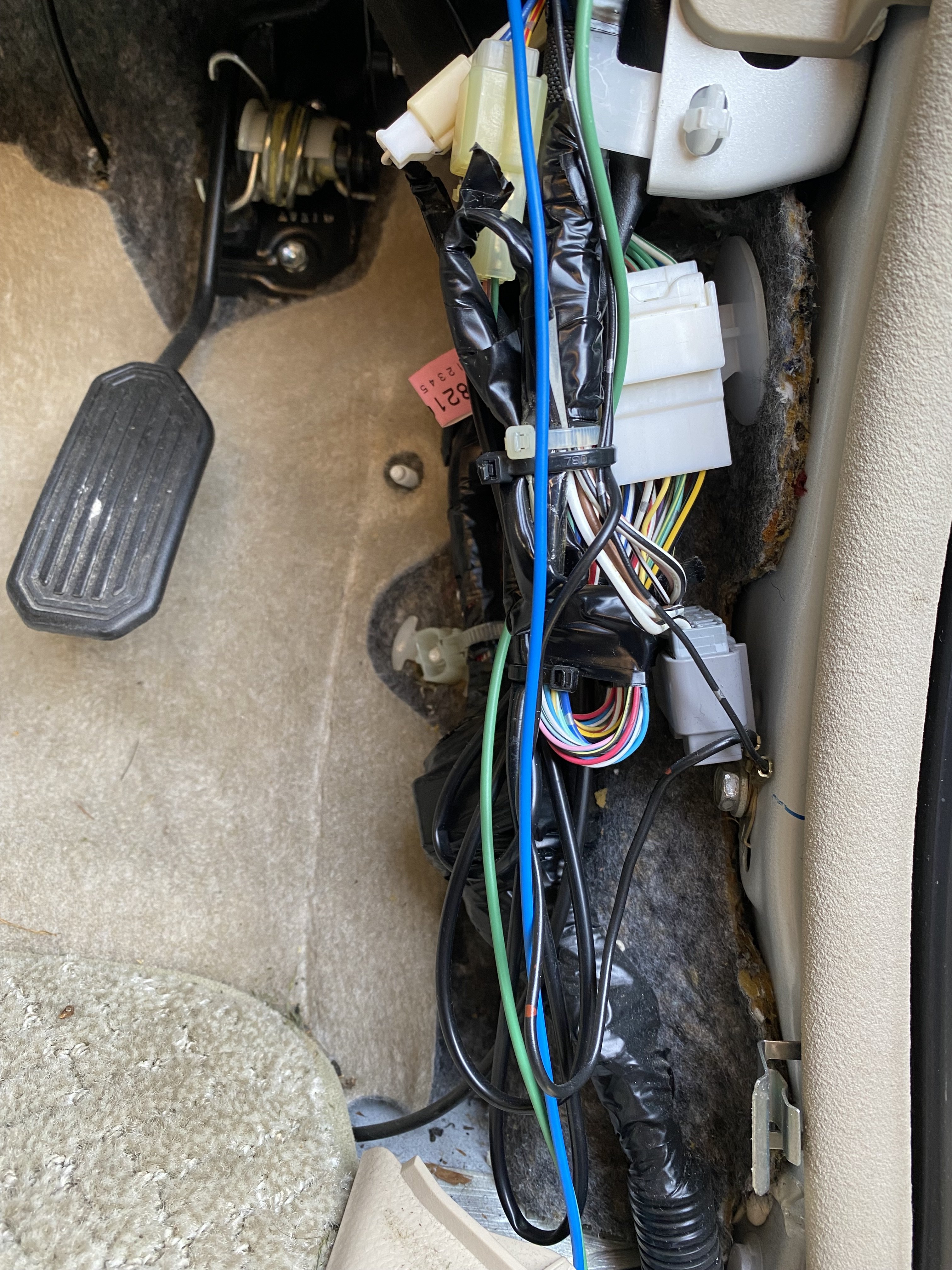

Went to start up our 2007 3.0 Alphie today but the battery was completely flat. ☹️ Thankfully the jump start pack which I’d purchased for such an eventuality worked impeccably. 👍However, there is now a beep, beep, beep, pause sound emanating from the right hand side of the driver’s footwell.
The ‘alarm’ stops when the ignition is started but starts again as soon as the engine is turned off. I’ve had the car since February 2022 and have not encountered this problem previously (but the battery has never been flat before).
Before I seek the services of an auto electrician can anyone advise whether they have encountered a similar problem or suggest what the problem maybe - something that needs to be reset perhaps following reconnection of a re charged battery?
I’m hoping someone can prove just how smart our fellow forum members are.IMG_1214.thumb.jpeg.4e8550c11524252b6f7e1fb779ca94e8.jpeg

Hi. The room lights were off when power was restored and I don’t have non-factory fitted driving lights.  Something had drained the ignition battery entirely as nothing worked for about 20 minutes after I jump started and the charge level improved through the alternator.
I have a battery condition meter in the camper conversion which showed that the ignition battery was on zero whilst the leisure battery was on max. We’d been to Anglesey and back twice the previous week so everything should have been tickety boo and I had a new battery fitted by Calder Campers when we got the vehicle 18 months ago.
Whether the ‘alarm’ is being generated by the current drainer or whether there is something else causing the drain I don’t know but nothing had been accidentally left on. The car came with an after market ‘remote auto starter’ (20 page instruction booklet in Japanese 🤷‍♂️) which I have never used but is obviously still connected and whether this is the guilty party only the auto electrician will be able to tell me. I’ll check to see if the car starts today and update the forum with investigation results.

So… disconnected the negative terminal on the car battery and left for 15 minutes to ensure all capacitors drained. Reconnected, and left ignition in position 1 for another 15 minutes then started the engine and took the car for a 30 minute blast up the motorway. Got back and turned off. No alarm sounding. No idea what the alarm was nor original cause for the battery to drain but everything seems to be ok 🤞
