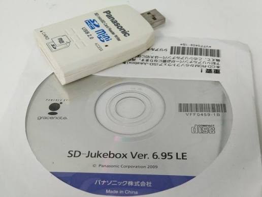

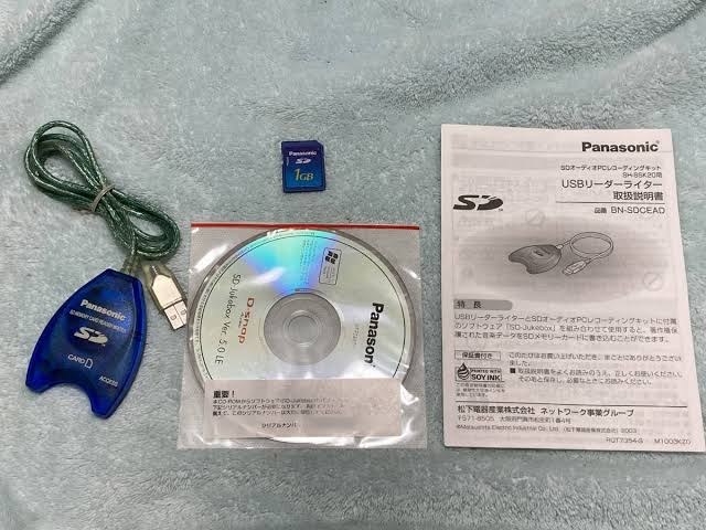

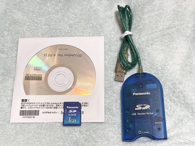

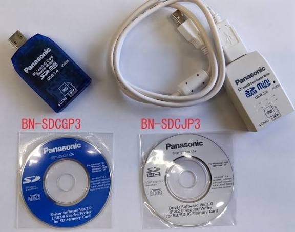

Some of you may not know why the Panasonic Jukebox PC windows software you have tried in the past to put songs onto the 2GB usb card didn't work i.e card not recognised. Because you NEED a very specific Panasonic card reader / writer in order to do it!
Panasonic CPRM compatible card readers (Content Protection for Recordable Media)
Example Panasonic BN-SDUSB2E
Or any Panasonic USB 1.1 or 2.0 SD reader that supports the "secure" (SDMI) specification.
Or If you do not have a Panasonic reader, you can sometimes use the Panasonic MP3 player (e.g., SV-AV30) itself connected via USB in "PC Access" mode.

▪︎▪︎▪︎ The only version of PANASONIC JUKEBOX that will work with Windows 7 and 10 is version 6.95 ▪︎▪︎▪︎ see the links
https://av.jpn.support.panasonic.com/support/software/sdjb/prod/versions.html
https://subiebear.com/2023/11/01/sd-jukebox/
https://megalodon.jp/2010-0502-1053-52/panasonic.jp/support/software/sdjb/download/sdjb_v6.html
