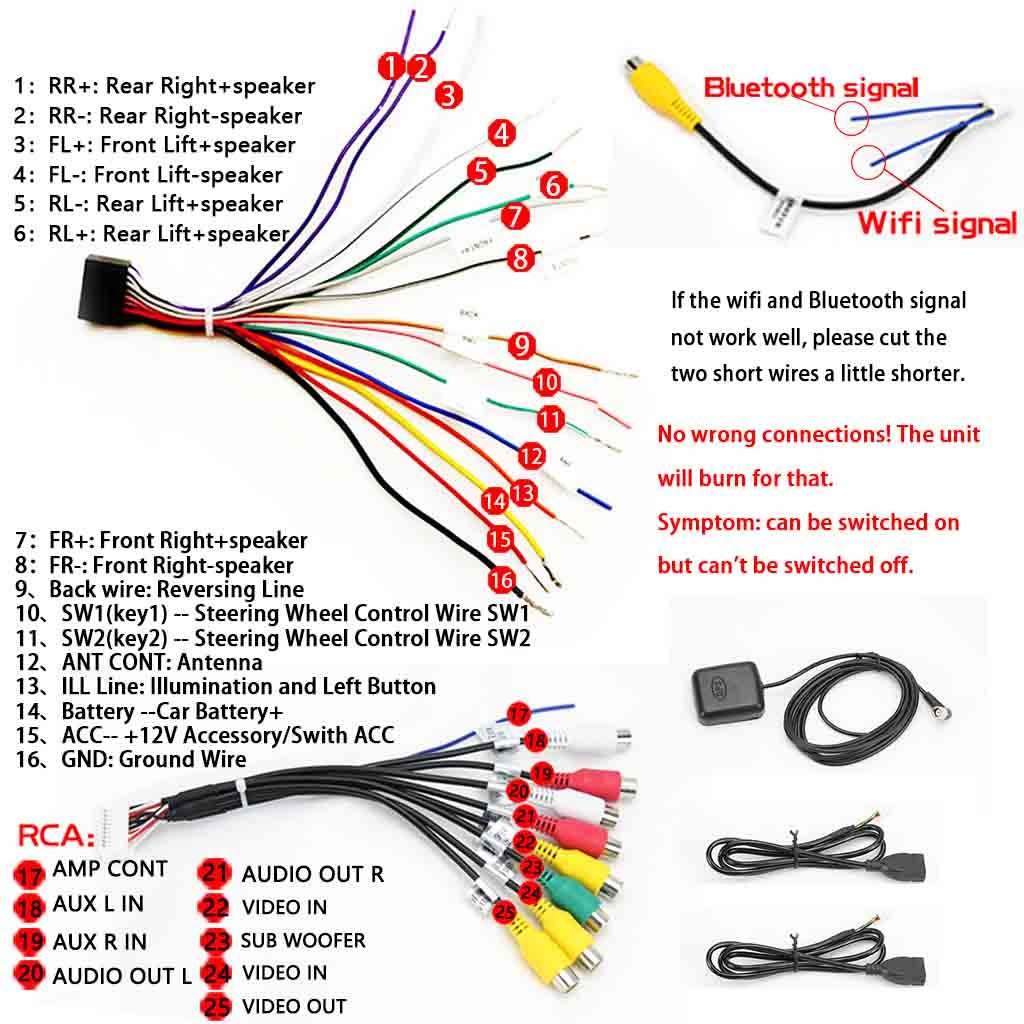

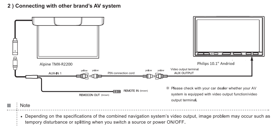

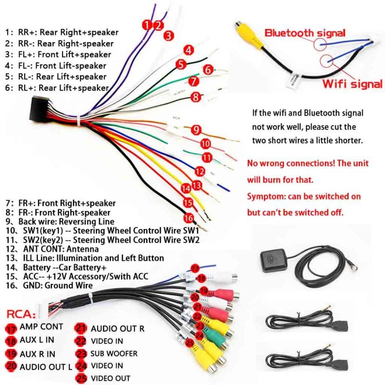

Has anyone had success with aftermarket roof monitor and Android Head unit?  I,e the Remote wire to trigger the signal?
