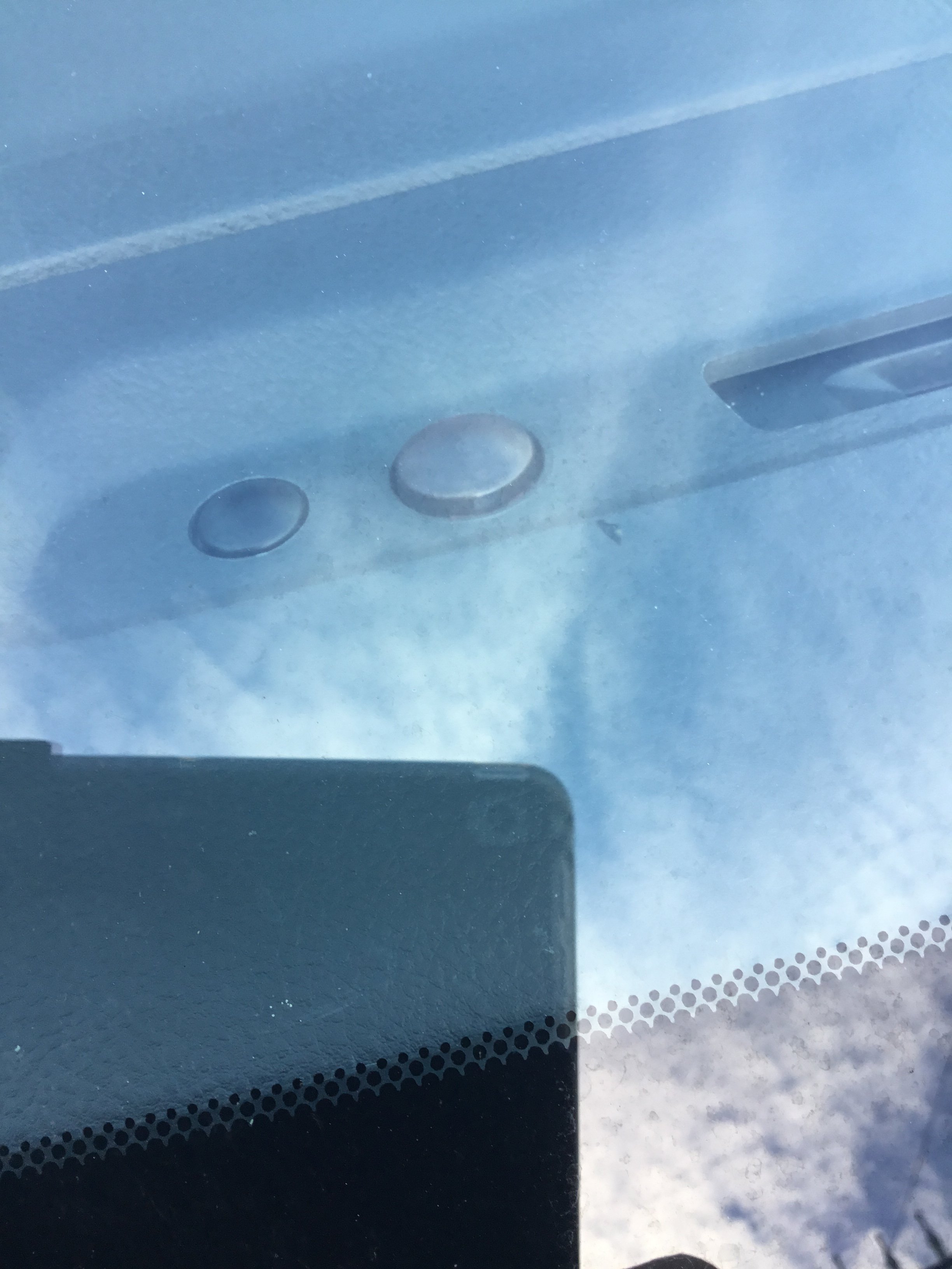

As I continue learning about my newly acquired 2007 Alphard 2.4, I find (to me) mysterious objects here and there. The first things to tax my ignorance are shown in the pics in this message. The question is: what are they? They aren’t a problem. They seems to sit there minding their own business, but I am curious. The first two are button shaped, sitting far forward on the right hand side of the dash, close to the windscreen, thus preventing me seeing if there are any marks on them. They are rigid, they do not press.

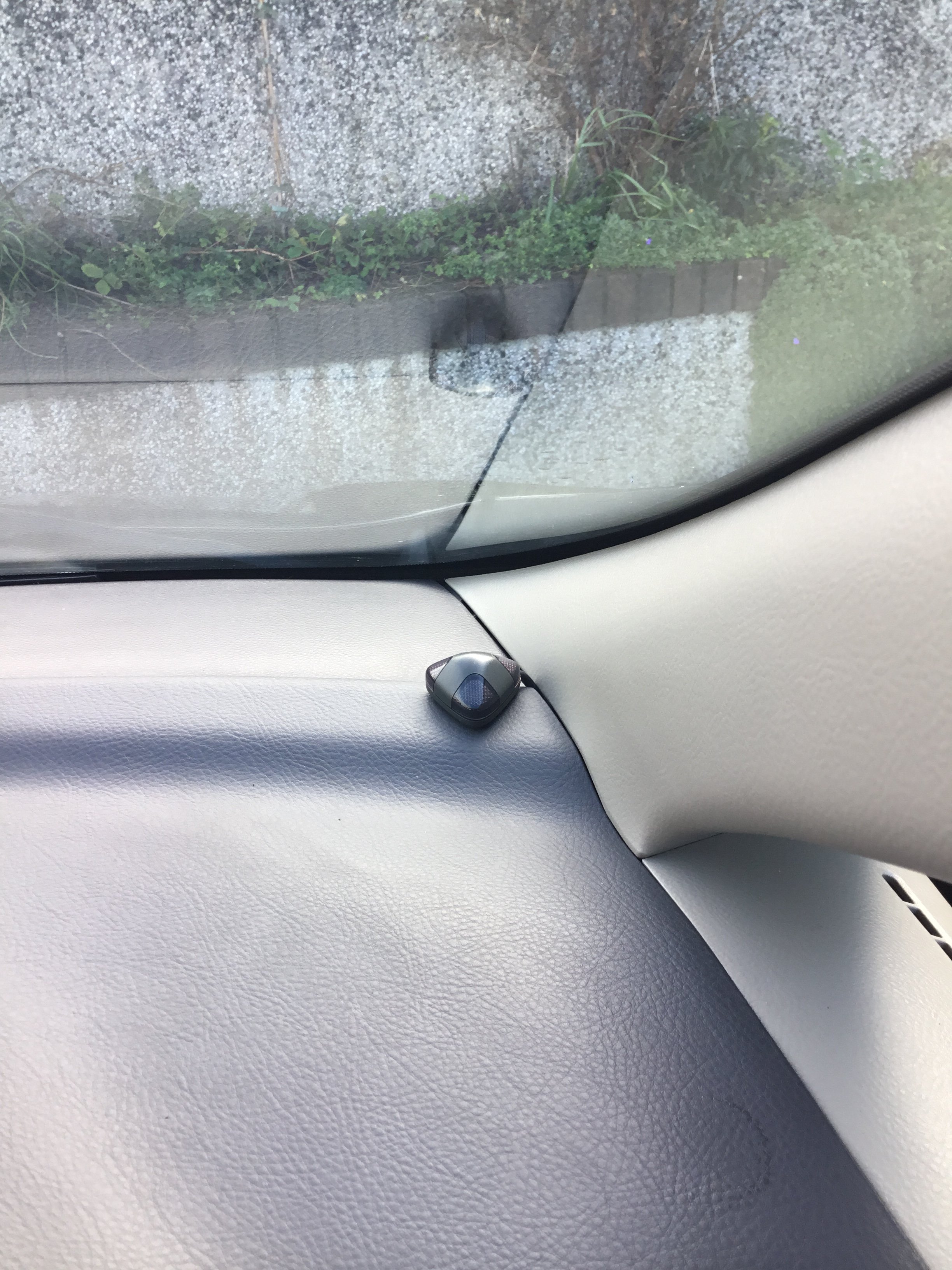

The second pic is of something that seems to be a sensor, again resting on the right hand side of the dash, with wiring feeding up the column between door and windscreen.

I think the first photo is light sensors.
The second appears to be a switch or, more likely, a microphone for some piece of add on kit accessory they had.
Most accessories are removed before sale, auction or export.

Roger and Lee, thank you, you’re spot on accurate with the light sensors. Tried the card trick and, yes, they work perfectly. As for the other bits and pieces I shall, indeed, ignore them, at least until they start to bother me too much 🙂

Sensors.
One for auto lights.
One for the climate control.
The little triangle is a dealer option Toyota security system.
Depending on the setup, you may find you have a bonnet sensor ( check if there are electrical wires on the bonnet clasp)
You should have an extra horn.
It should have come with an extra fob to activate/deactivate.
Basic alarm system for doors.
It should have flashing LEDs on it if active.

1 Yes I have the sensor for the auto lights, although I suspect its sensitivity need adjusting somehow because the lights won’t come on in the Dartmoor gloom, just when nightfall makes it sufficiently dark.
2 I clearly have the other sensor which you identify as ‘climate control’ but which then begs the question: what is climate control when I have fans aplenty and air conditioning, no other switch that is marked climate control and I can find no reference to it in the manual?
3 OK yes, I can see that the little triangle thing is a sensor for an after market alarm system but, like so much else, I’m not immediately clear how it operates. In fact, I have inadvertently set the alarm off a couple of times and switched it off by simply putting the key into the ignition.

on later models, the light sensor is a single one.
On older vehicles, you had one for the auto lights, and one that detects sunlight in order to determine if the ac comes on automatically.
The light sensitivity is able to be changed on 2008 onwards, but not sure if this is the same for earlier.
If you google toyota auto light sensitivity you should find some youtube vids showing how to adjust.

There is a manual for that alarm, its in japanese, i will see if i can find it again
Good morning Roger and Chris and thank you once again for the information. I think I’m fairly well sorted now as regards those sensors and the alarm. The triangular one now blinks away like a good ‘un and I’m happy with the A/C: Climate Control operation although it doesn’t seem to help much where this dreadful winter weather is concerned🤕.

The other sensor on the dash for the climate control is a solar sensor......it adjusts the air distribution depending on how the light is shining into the vehicle, I believe to try to eliminate any heat build up that might occur when the vehicle is in direct sunlight.
Most Alphards have UV/Solar glass anyway which also helps with this.
