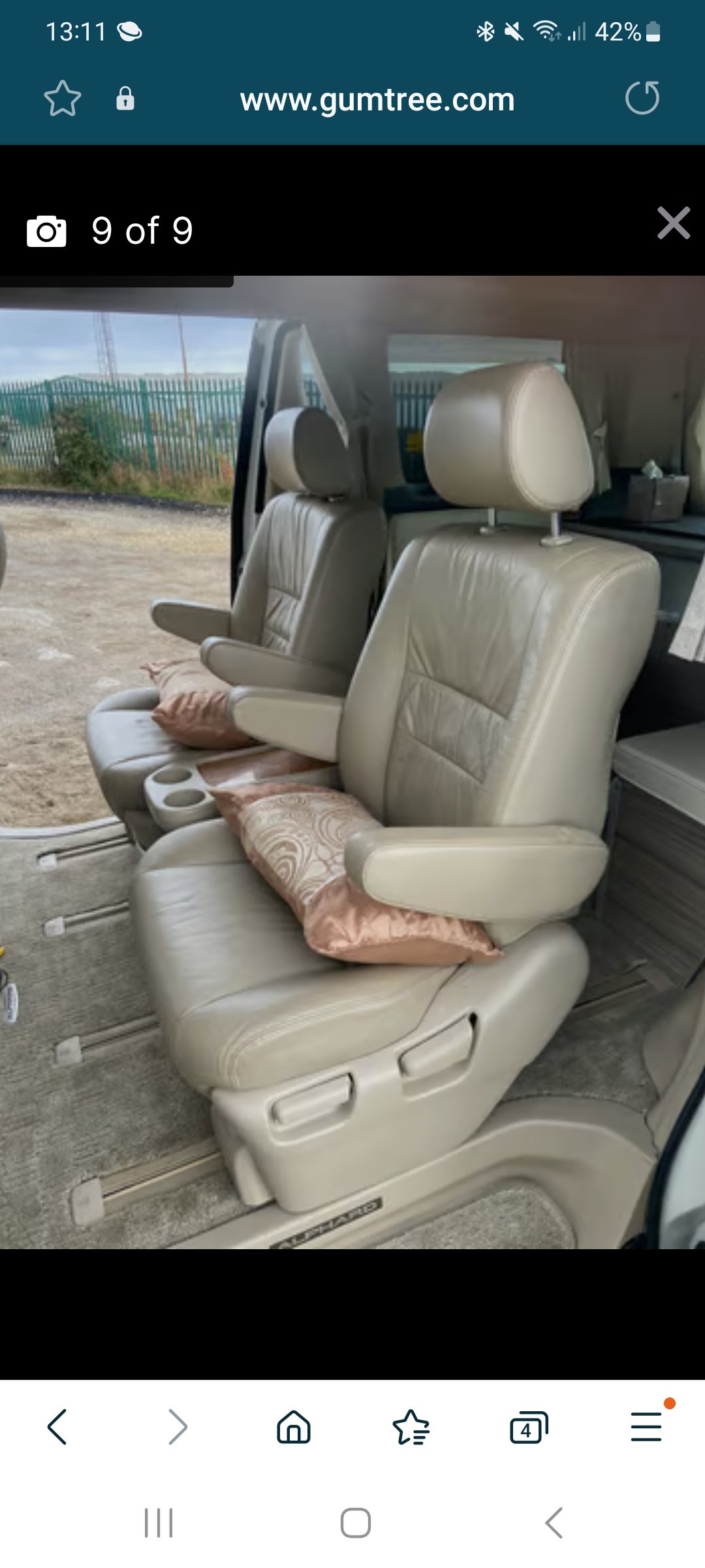

Hi,
I picked it up Saturday.  The seats are in the photo if that helps. It is a rear conversion so the 3rd row has been removed.
Thanks 👍 Screenshot_20230608_141555_Gallery.thumb.jpg.a4c489b012f9e74af956097336150920.jpg
Just now, SYL said:
Hi,
Sorry I am picking it up Saturday
Looks really nice, just like mine.
Take care of the leather is does 'stretch' quite easily.
The answer to your question is very complicated, so I will send you a PM.
Why do you want them to swivel ?
Sleeping or Dining, or other reason ?
I expect you will be absolutely delighted with it.

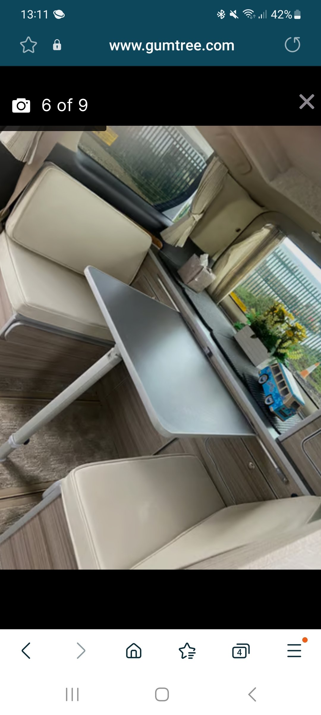

Hi,
No reason really but it may be useful and more comfortable to sleep on......maybe.
I will be covering the seats we have a lurcher so I don't want them damaging. She has a hammock so won't be directly on the seats but, I don't want them damaging.
Thank you so much for your time. We are really excited to collect it and drive her 150 miles home!

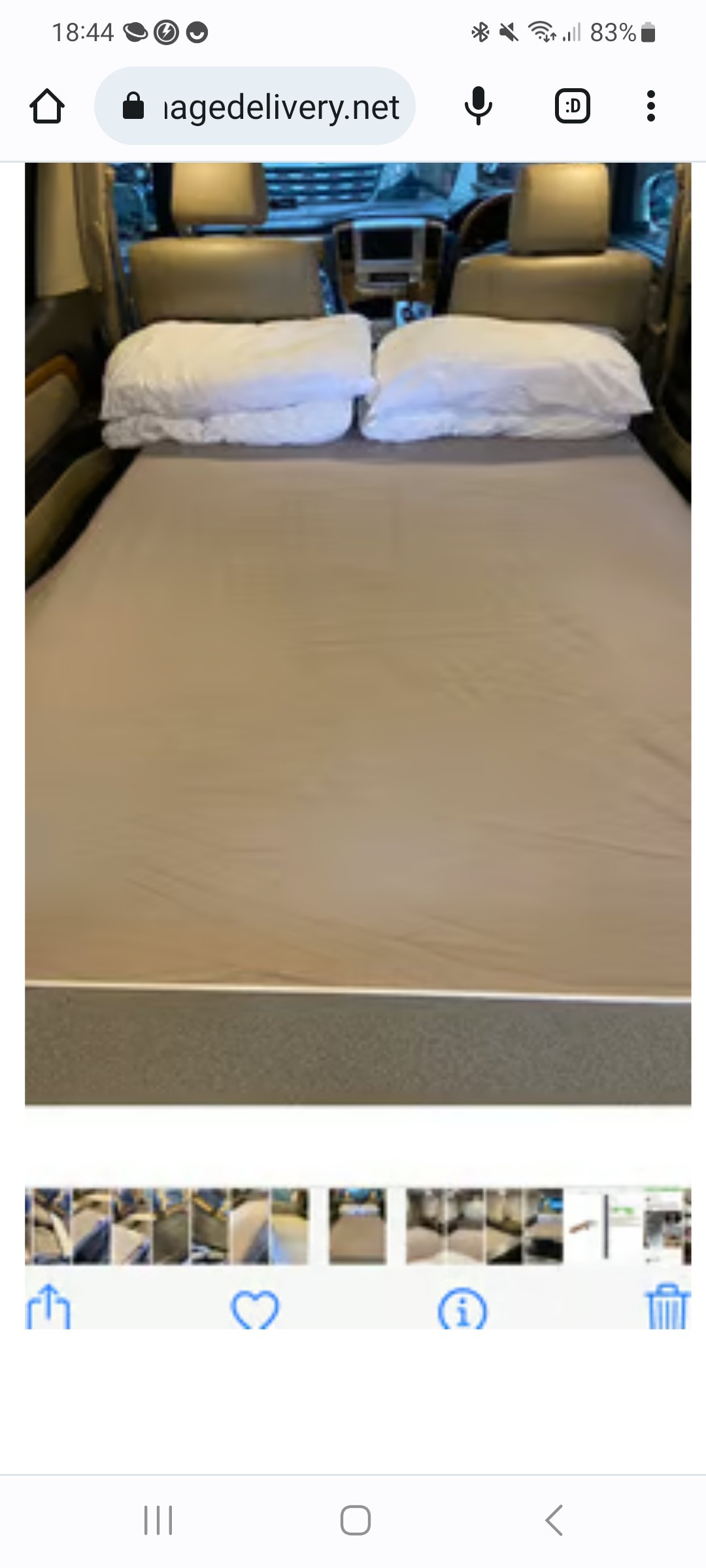

Everything is coming with the van, so got the cushions and self inflatable mattress, awning, sun canopy,  loo and loo tent and a towing rack. The bed when down looks fabulous.
You have been so helpful, can't wait to do some wild off grid camping for a couple of days cos not got a solar panel.

On 6/8/2023 at 2:18 PM, SYL said:
Hi,
Hi, do these seats rotate? Sorry I am still unclear on which middle seats rotate and which don't. This looks to be an MZG with the two separate middle seats rather than a 3 seater bench. Do these two separate seats rotate?
Thanks in advance
(Looking to buy an Alphard first gen but the rotating seat option is non negotiable!)
Thanks in advance
No, they don't.
The 1 and 1/2 plus one seats do rotate, but are only found on the Gen 1 machines; up to 2008.
If you must have rotating seats forget the MZ G edition and any other version with only four seat rails.
The rotating seats sit on 5 seat rails.
I believe the later models do not have rotating seats.
