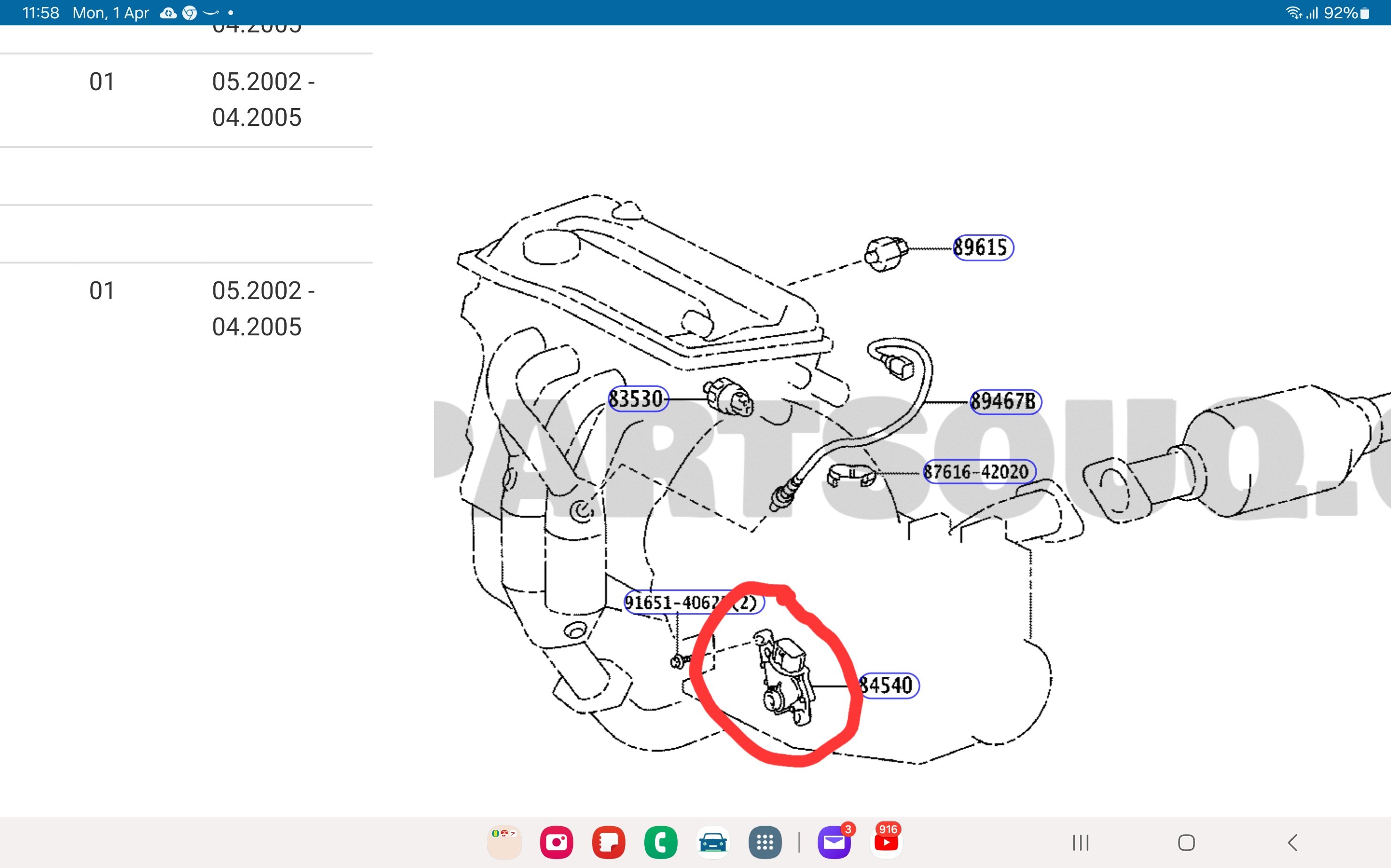

Then just the P/N switch, solenoid or something mechanical remains the issue.
Since you hear a click with ignition on and foot on brake, it could be the solenoid and P/N switch are OK but something mechanical is broken. If I were you I would remove the fascia and try to reach and examine it visually.

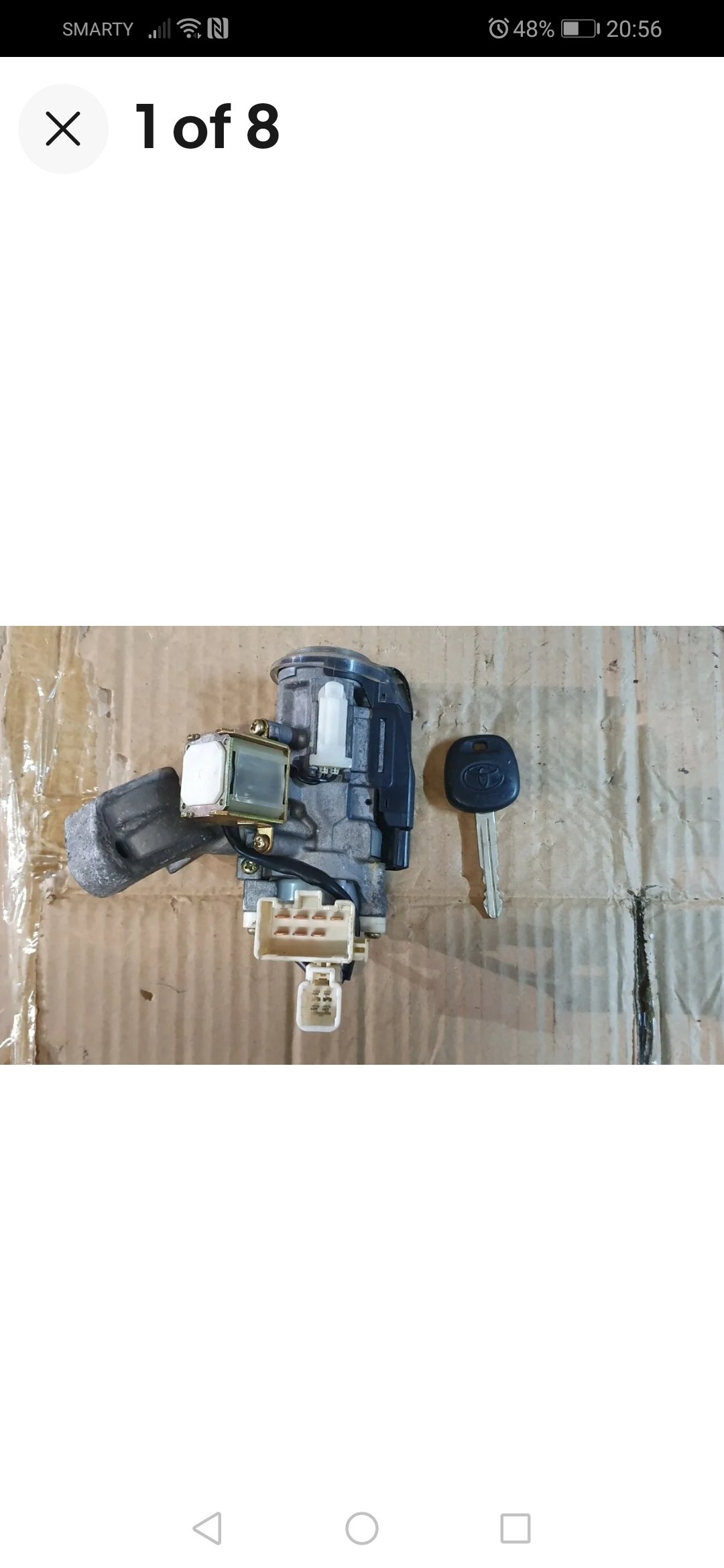

Can you see what looks like a motor on the ignition barrel I think this is the problem
Great help thank you were can I order it
Why do you think it's the problem? I'm not following your logic here given the problem you face. If you can rotate the ignition barrel and start the car, then there's probably nothing wrong with it. Are you just wanting to replace a part that happens to click? A click is usually a good sign: A relay actuating or a solenoid moving.

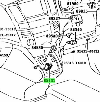

If the problem really is the shifft lock solenoid (TBD), then this is the part 85431-58010:
https://www.amayama.com/en/part/toyota/8543158010
Not surpisingly it's attached to the gear shift lever, not the steering column.
