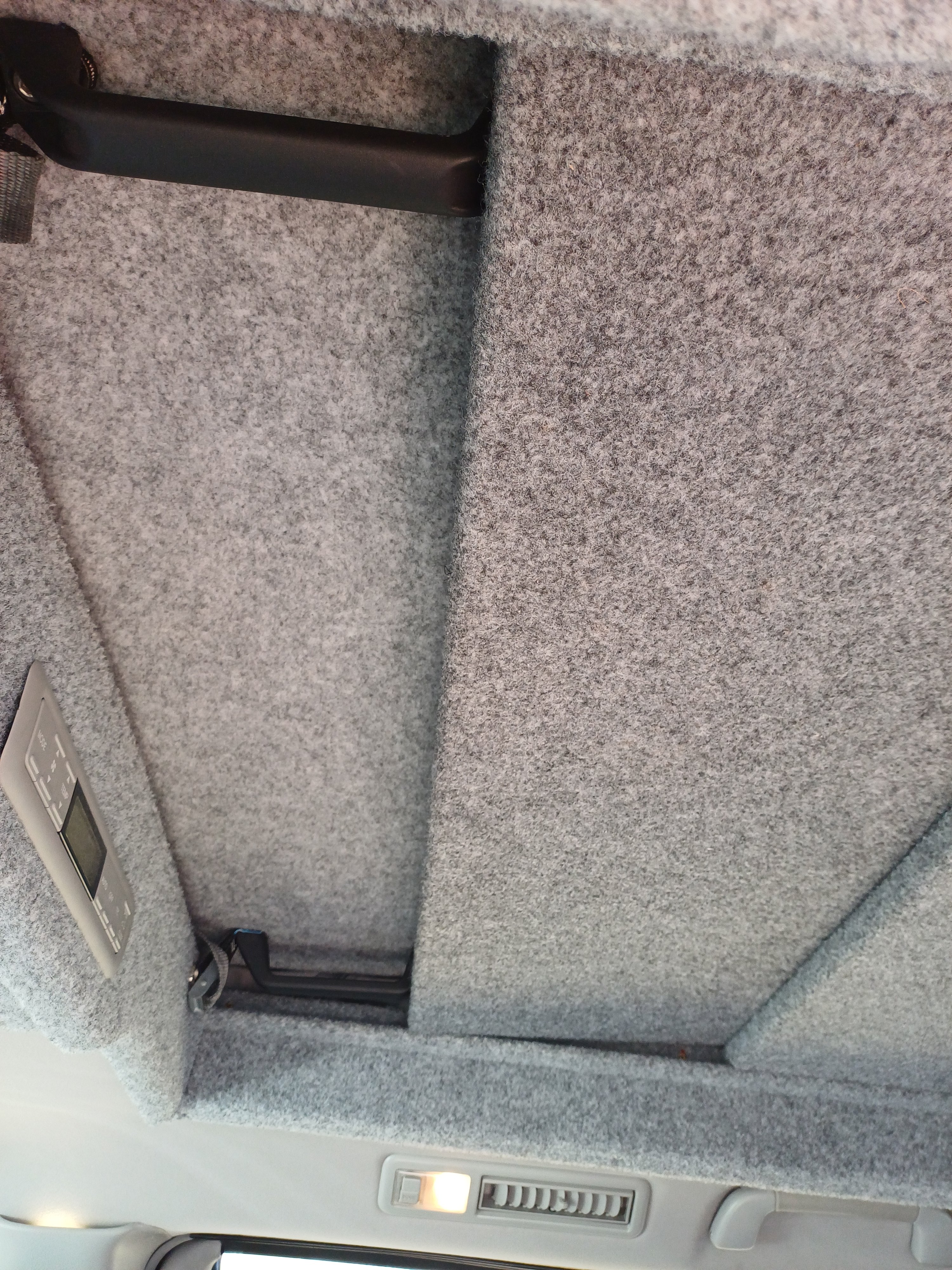

Unless the pop top goes up from a side hinge or horizontally you will be tight on space. My pop top goes up from the front, hinged at rear, and I wouldn't try to get up there to sleep unless I was very young (perhaps the grandchildren?) and short. Being old (and a bit short) I tried but without a safe step I decided against it. Further, if you need to go for a pee in the night...
IMG_0341.thumb.jpeg.811f2f1dd8f7aee0b5bb5a242ed52098.jpegThe edge frame for the pop top is returned horizontally inwards to support the ceiling boards. (still working on the finishing off)

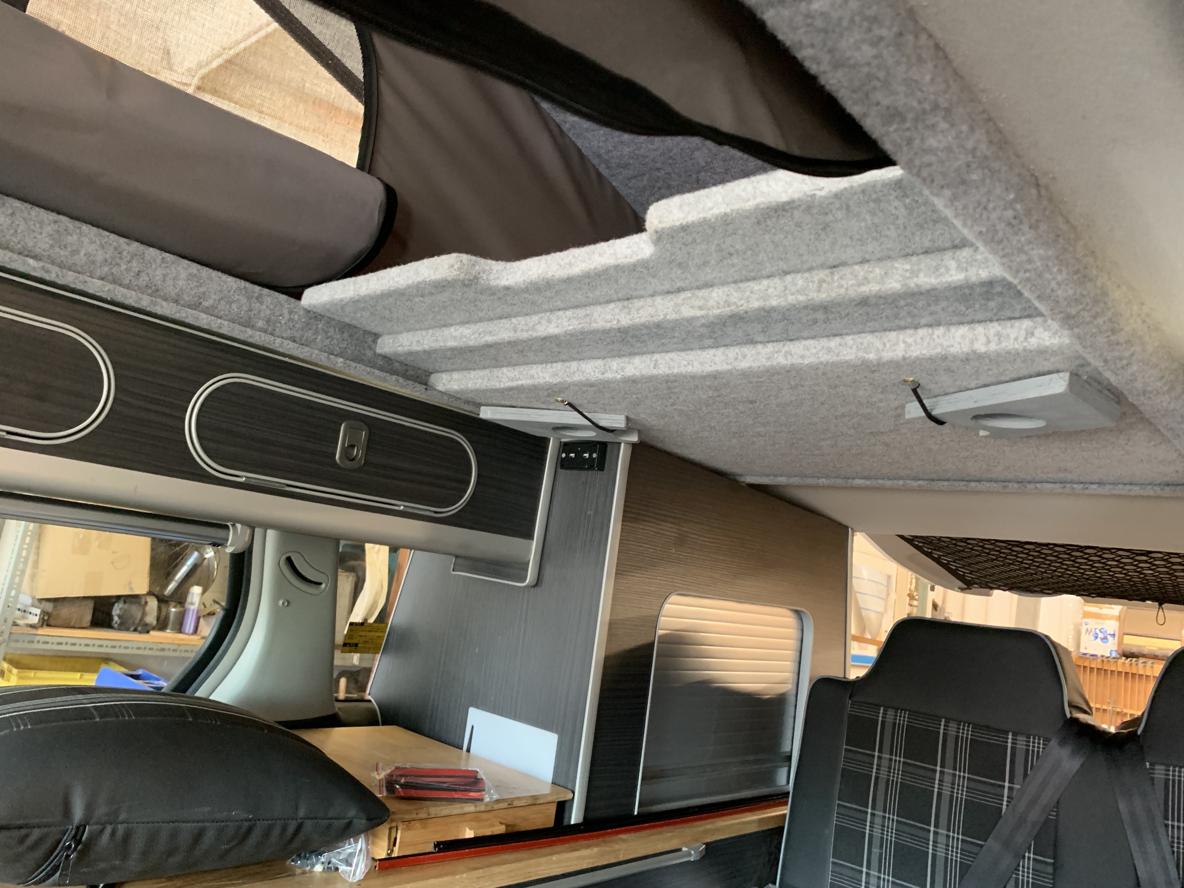

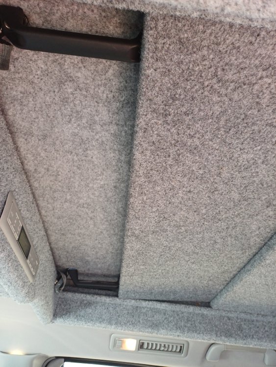

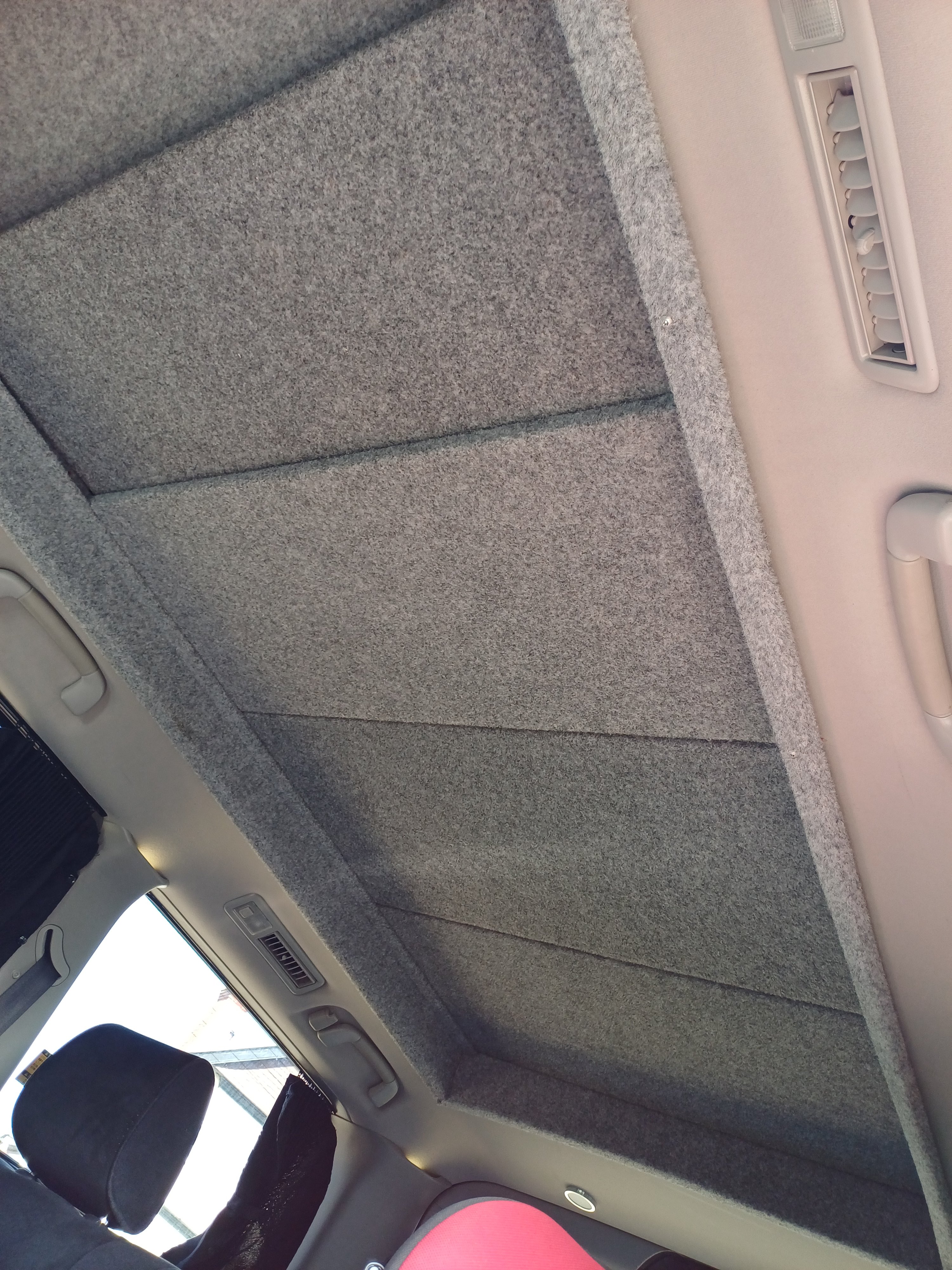

Morning chaps, pics as promised.
Much as described above carpeted boards that lay in the metal frame of the Drivelodge pop top, four in total.
I have to have the front one slightly overlapped as otherwise you can't pull the top down tight enough to seal because of the lifting handles.
They just essentially lift in and out of place as needed and are all separate (so can be taken out, stacked at one end, whatever works)

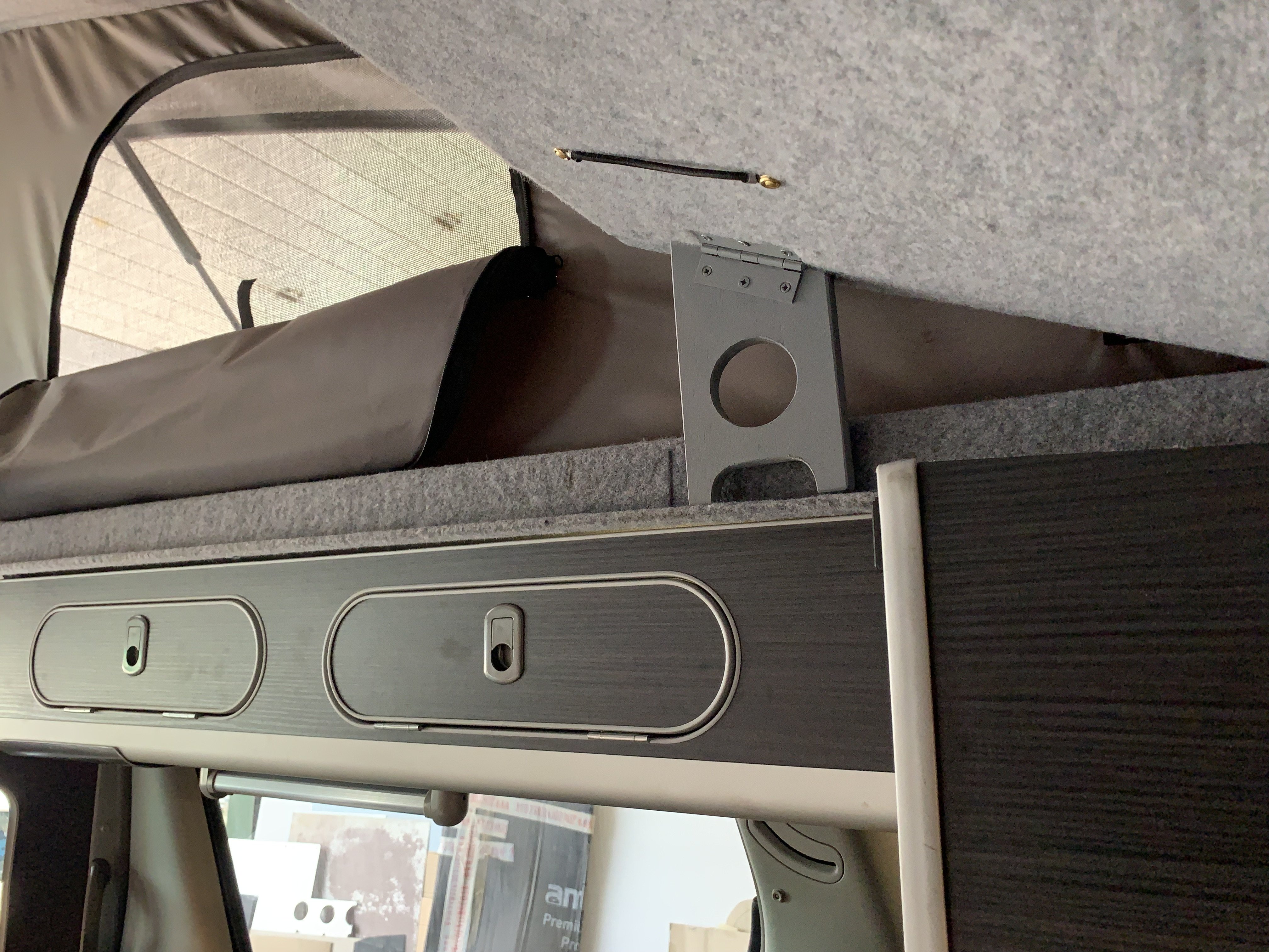

As an aside, the forward most board in our ceiling has a cut-away to allow access to the pop-top mechanism for ease of opening.

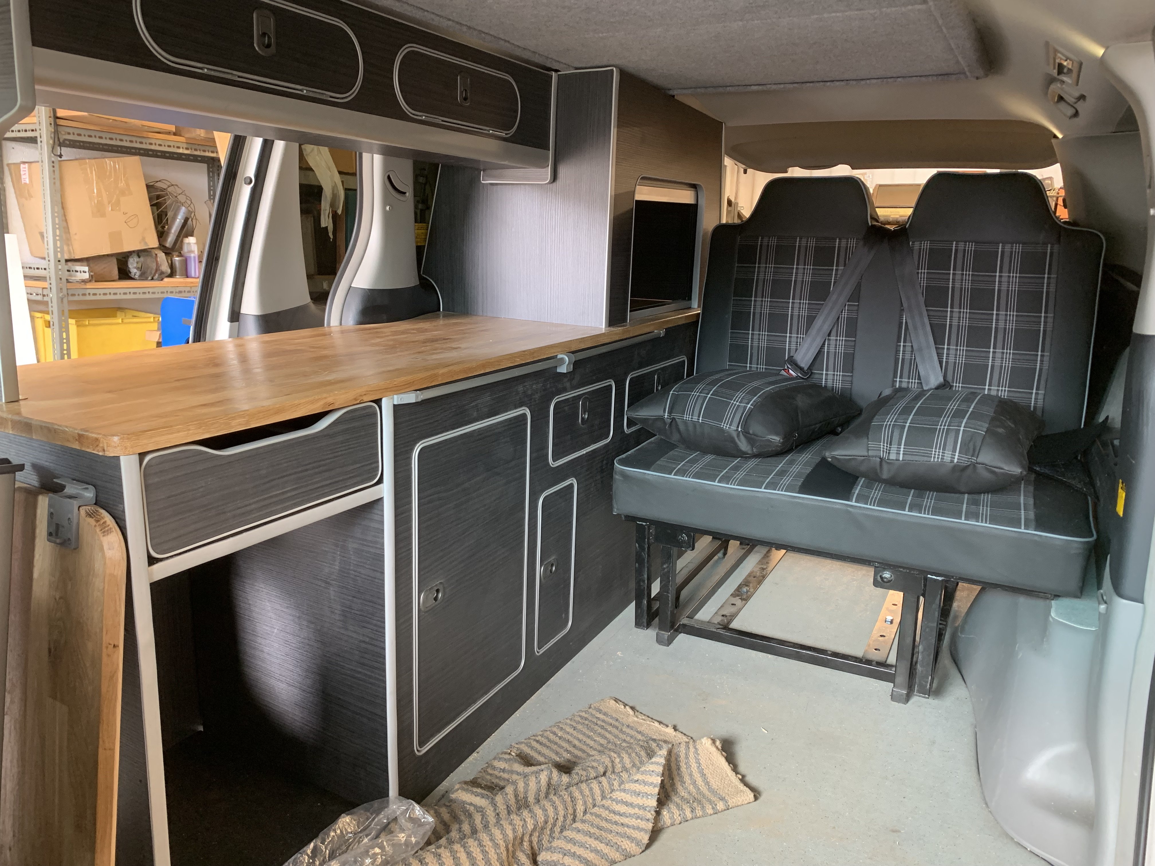

I'm busy making a couple of aluminium drawers to go under the rearmost part of the R&R bed. I don't like to think of vacant potential storage space and did some for the Regius which proved to be extremely useful

I'll be honest, as ours is (or was originally) and 8 seater with a rear conversion, it's retained the factory 2nd row which is what doubles as the bed.
The nice thing about this conversion is that you can use the 2nd row (either when folded flat, or rotated and facing rearwards) as the step up to the pop top level.  Admittedly it's probably not that great for those in their advancing years/or don't much like a small climb but it works well.
I don't think it works quite so well with a side conversion (where you would normally end up with a rock and roll bed at the rear) as it doesn't give you that means to step up, unless you are fortunate enough to have rotating front seats (not something the Alphard ever came with, but is a semi popular aftermarket mod).

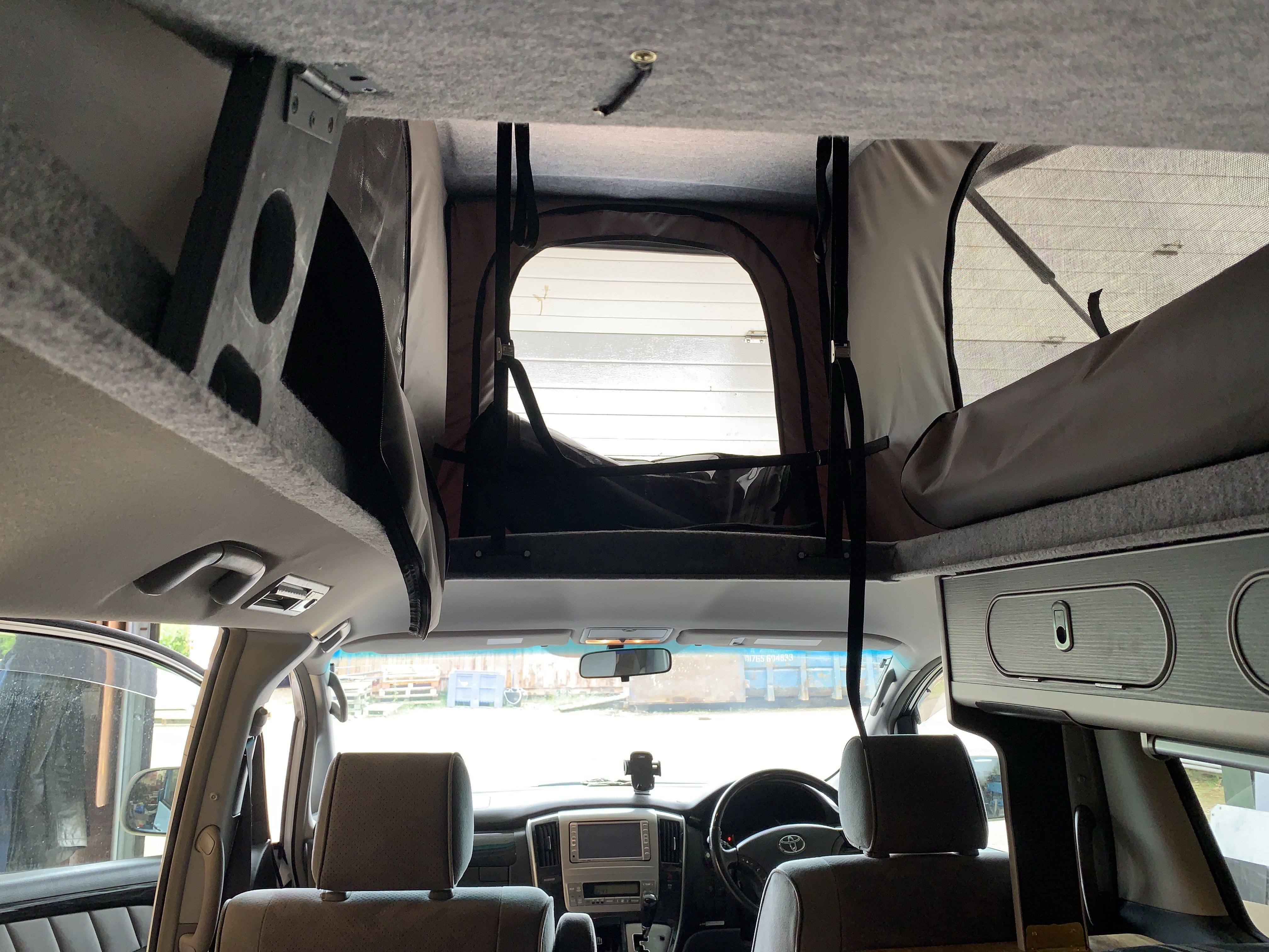

Hi all. Well, the deed is done. Bed boards made and installed and we are very pleased. Sylph-like wife is able to spring into the upstairs bedroom once the poptop is raised, for which I am most grateful and I gave her a round of applause, for which she was most grateful. She doesn’t need a ladder or step-stool, she simply hops up via the second row of seats that we have facing backwards. The boards fit neatly and do not impede the poptop handles. To raise and to lower we simply shuffle the for’ard most board backward to overlap the one immediately behind to create space to raise that pesky poptop. Also, we have found there is sufficient space between the upper surfaces of said boards and lower surface of the poptop to store the sleeping mats and a blanket and some other (flattish) stuff to save stowage ‘down below.’
All told, it all seems most satisfactory. We will try it in anger in not too long, after which we will either become campervanning maniacs or sell the damned thing (just joshing!).

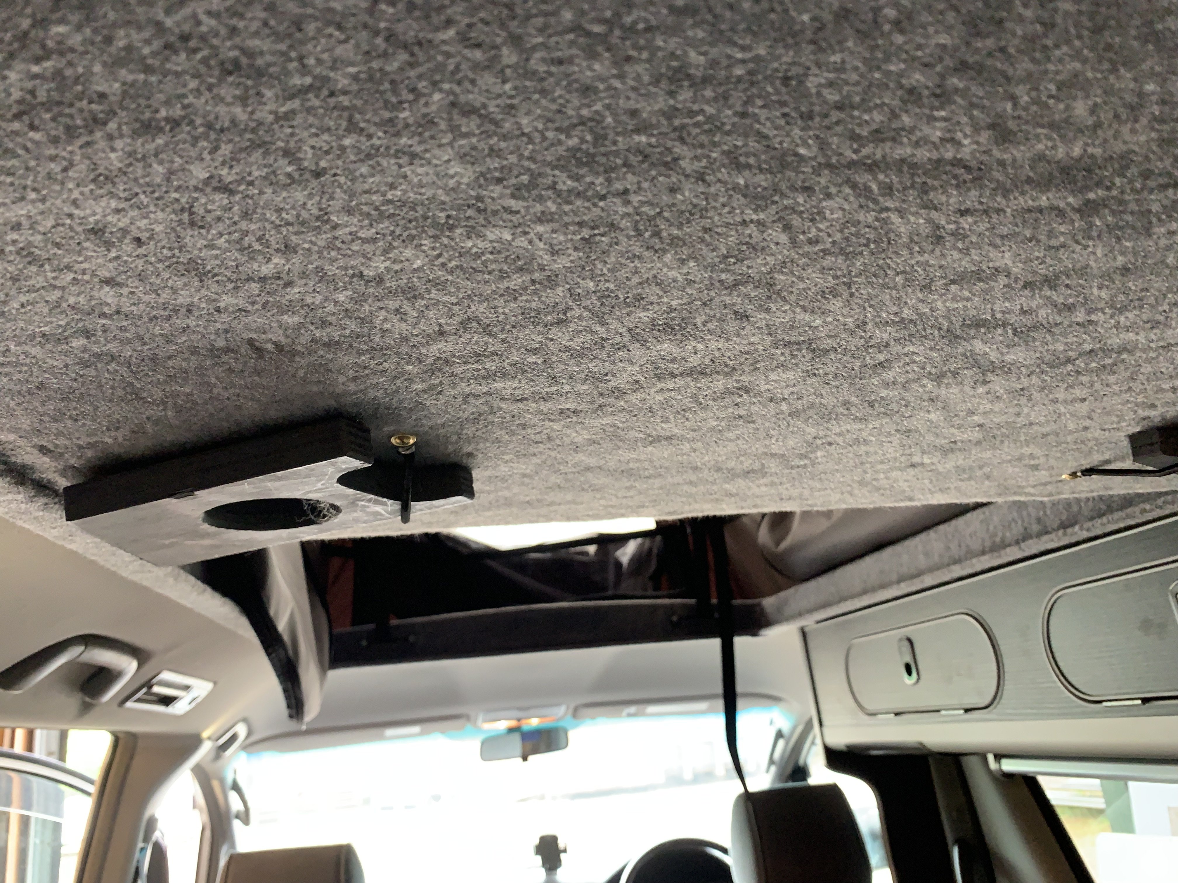

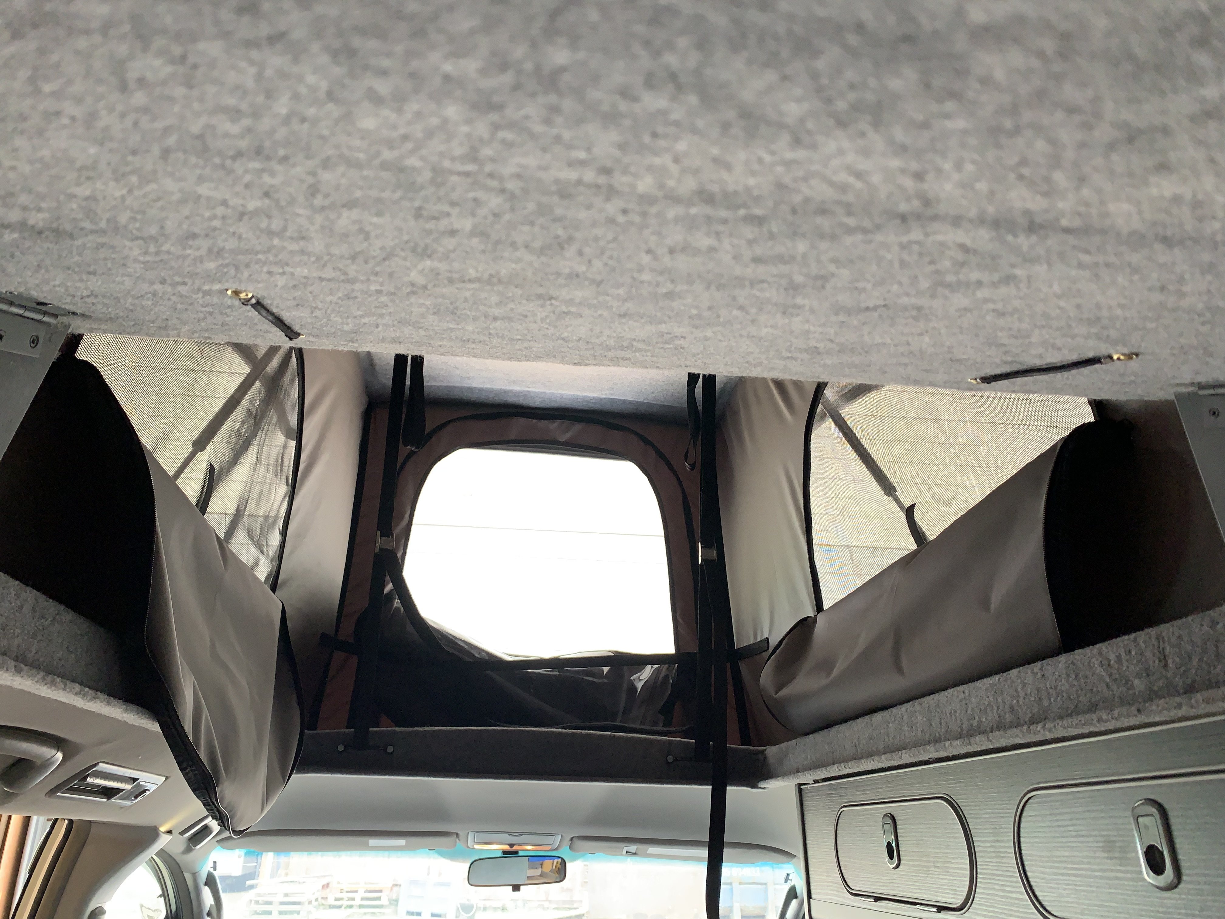

Similar to my roof boards but I asked for mine to be made in four, they did three instead which is ok. I like to have open space above when the pop top is up and I added some risers to the rear one to allow a better clearance. The pics are all taken from the R&R bed with the seat up, first with the boards down etc.
I also managed to hang the curtains today, hours of fun as there were no instructions to help, fairly straightforward though. The solar panel was waiting for me when I got home...tomorrow's job and I managed to nail my sparks pal down for a date to wire up.
Nearly there...
