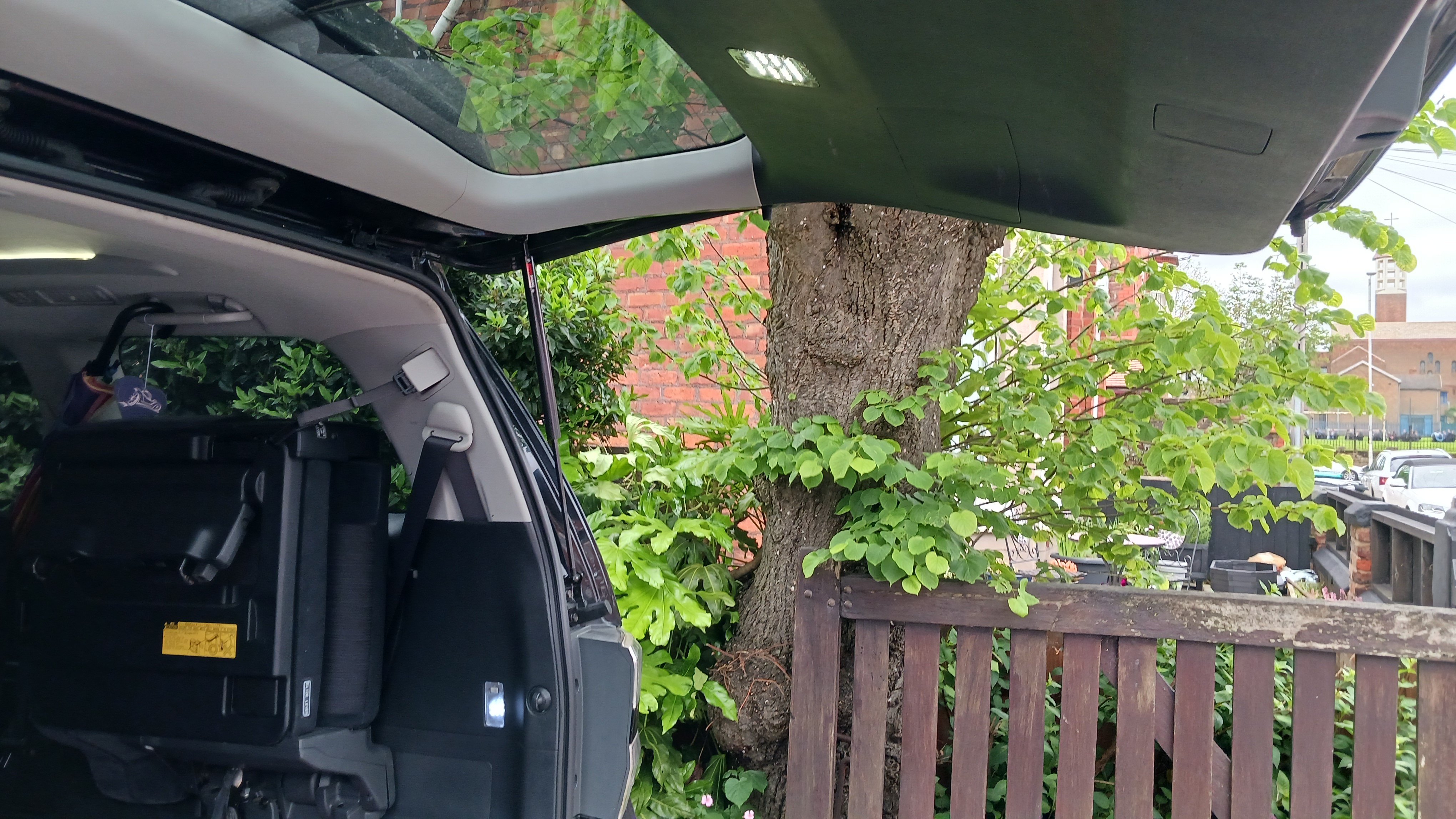

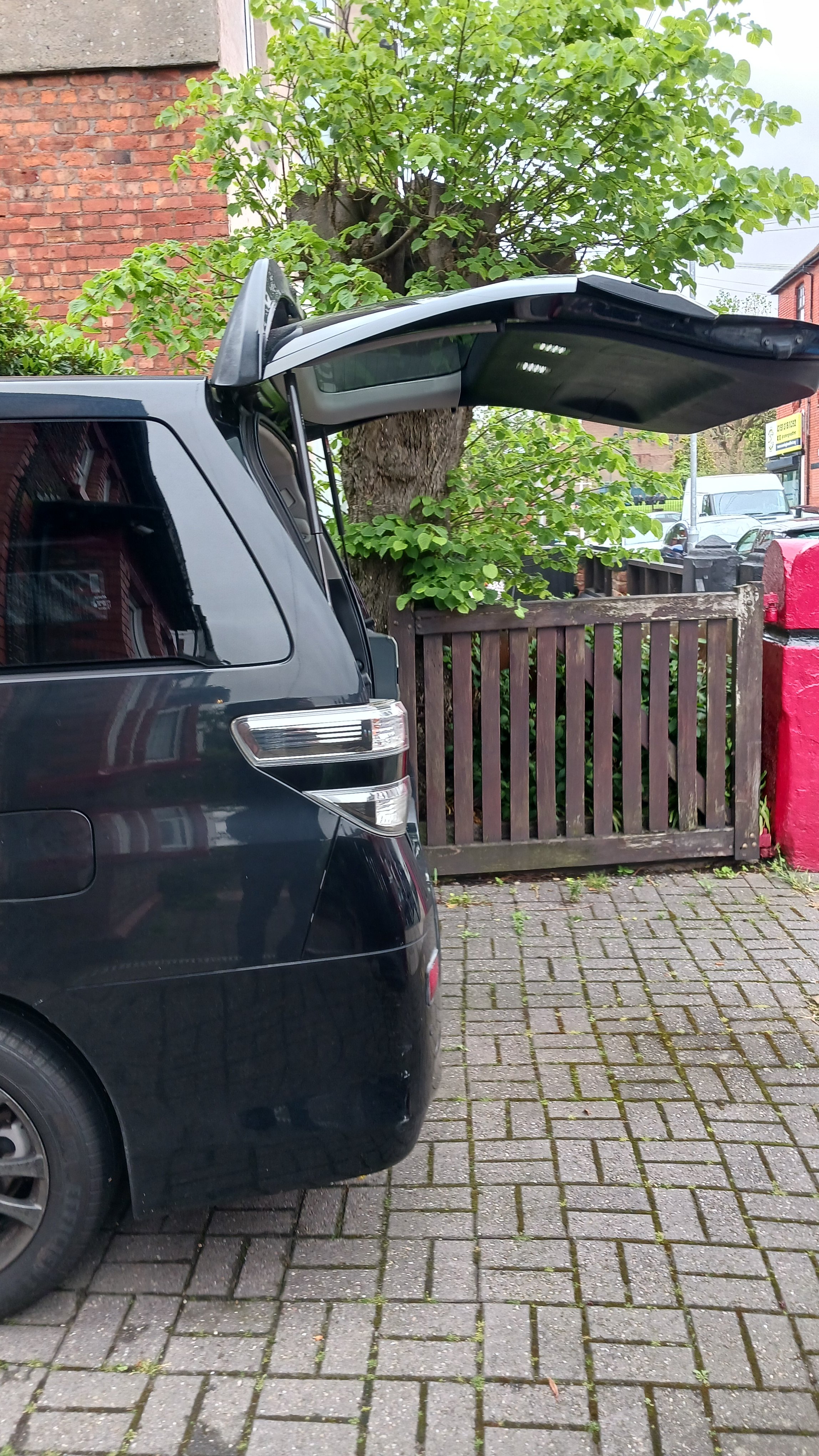

Hi. I have a 2008 Vellfire AH20. I've mentioned before, and it has been mentioned by other people about the height of the rear door, when open, being too low.
My struts went up the the fully open position if lifted, but wouldn't lift themselves all the way up.
Time for a replacement!
Had a look on the internet and one company sent the wrong ones; too short and no brackets, even though recommended for Alphard/Vellfire's. I hot a refund in 4 days and had ordered a new set that looked right (showed brackets, etc).
These arrived yesterday. I fitted them and they fitted perfectly! The cylinders ar shorter, but the close ok and, FOR THOSE WHO COMPLAINED THAT THEY BANGED THEIR HEADS,
they open the door about 2" to 3" higher!!! They lift the door as soon as you unlock, but you can still pull down and shut easily.
I'm really made up with them!

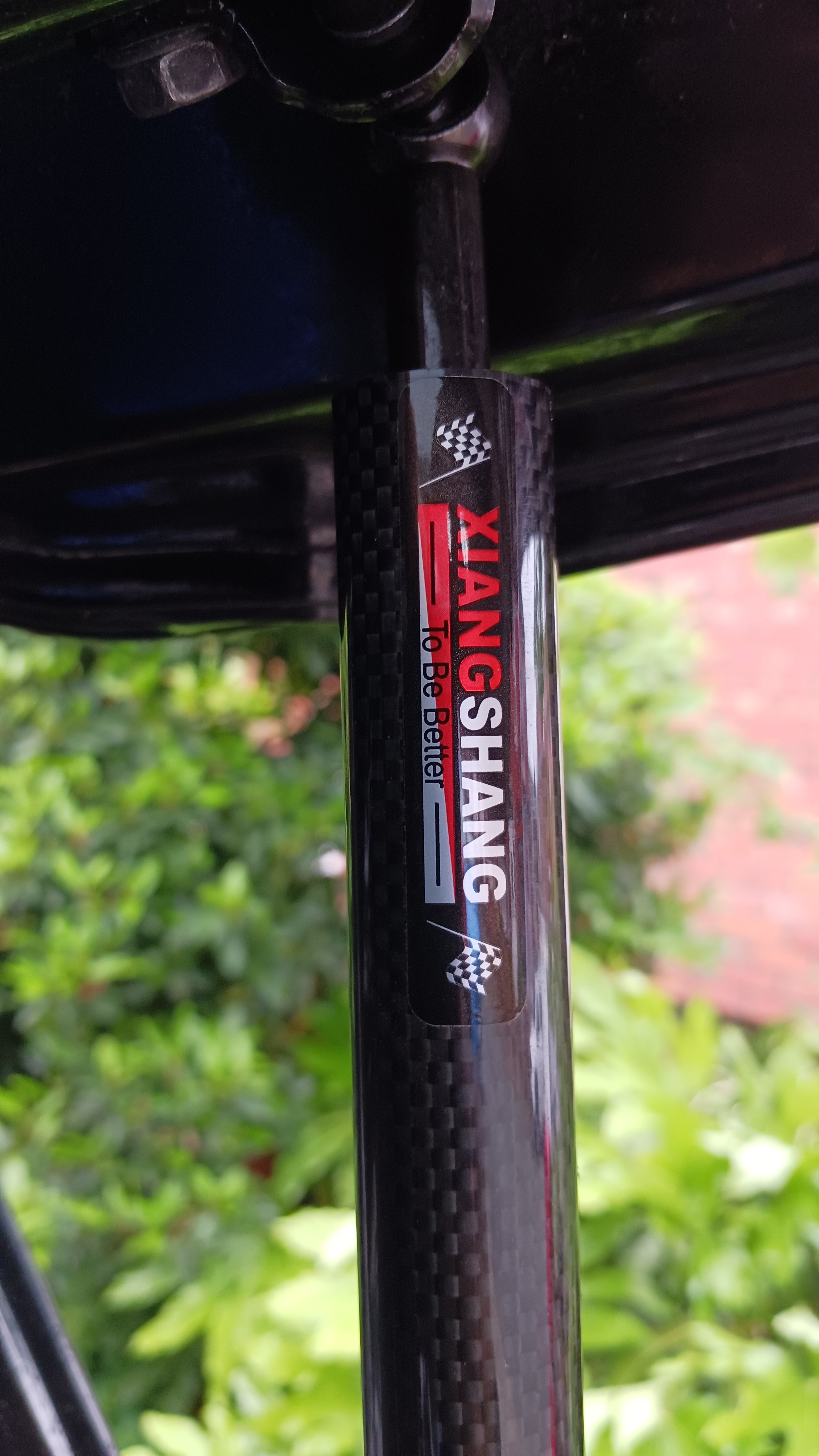

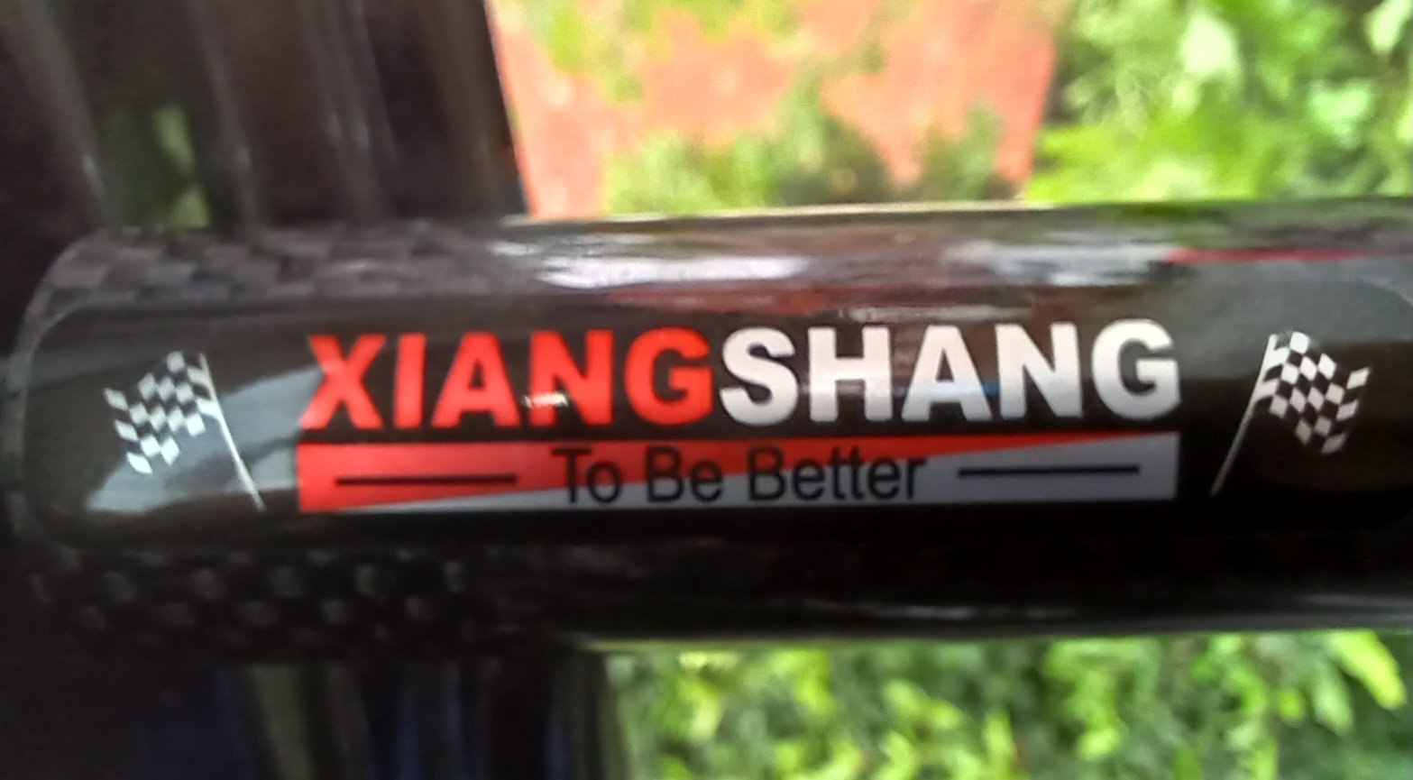

The make is 'XIANGSHANG'.
THESE WORK WELL and are highly recommended!!!
(See attached pics)
You don't have to bang you head again!!!

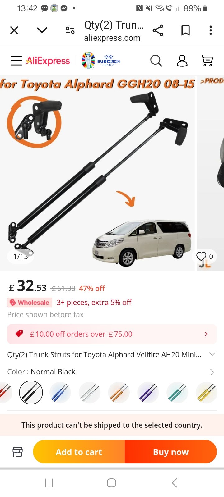

Do you guys have the exact link for these struts on Ali? I've looked and there seems to be several listed.
Pete
Hi Pete
Here is the link:
Just found this amazing item on AliExpress. Check it out!
£45.79 | With Power Tailgate Struts for Toyota Alphard Vellfire AH20 2008-2015 Minivan Rear Trunk Lift Supports Shock Absorber Dampers
https://a.aliexpress.com/_EuGFovd
They come with new mounts that are slightly different to the old ones, but fit okay. You'll need a 12mm spanner/socket set. I have a powered boot, so you might want to buy a different set if yours is manual only (although they might work for both options). I found it easier to fit the boot end of the strut first, then the main body of the car.
