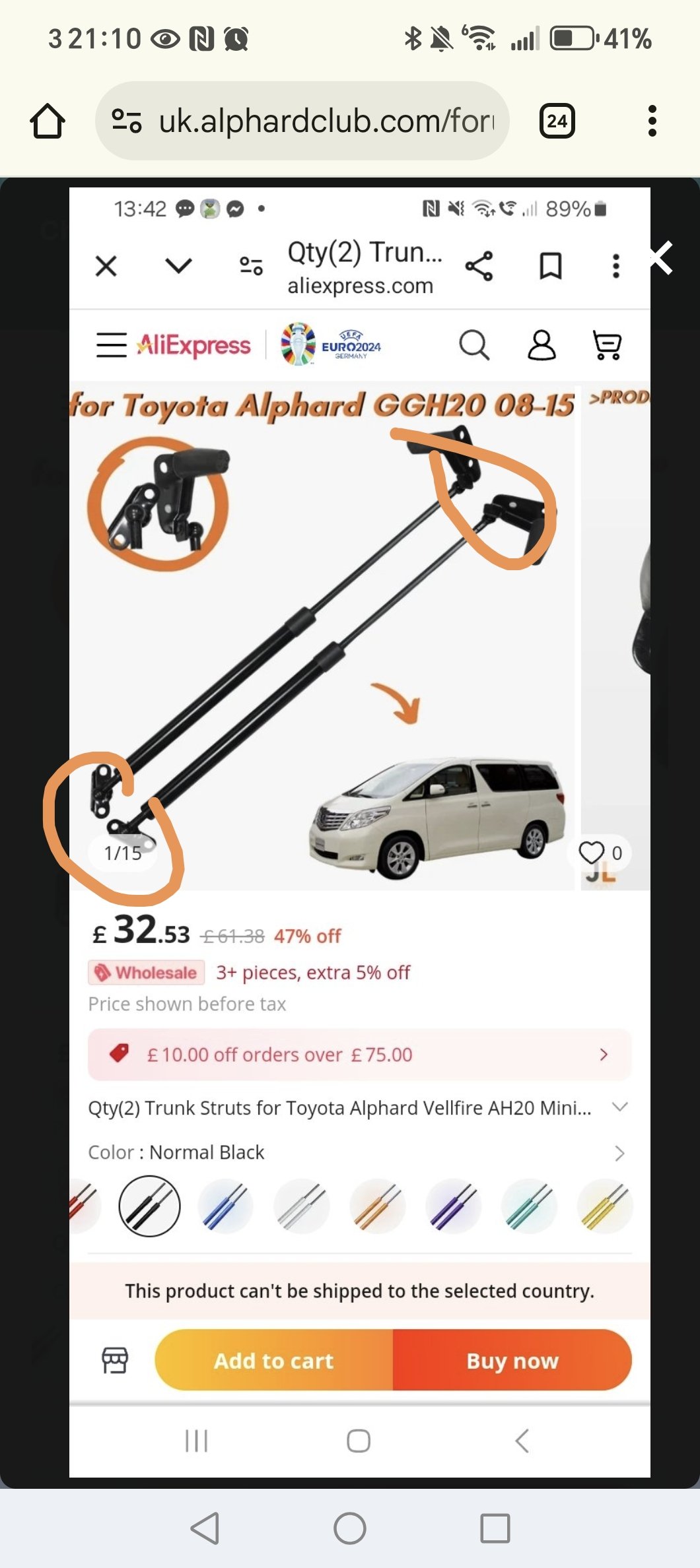

Hi John, can you confirm that I have ordered the wrong ones, which came without the brackets..? But it does says it's for 20 series, with power tailgate? Thanks in advance!
