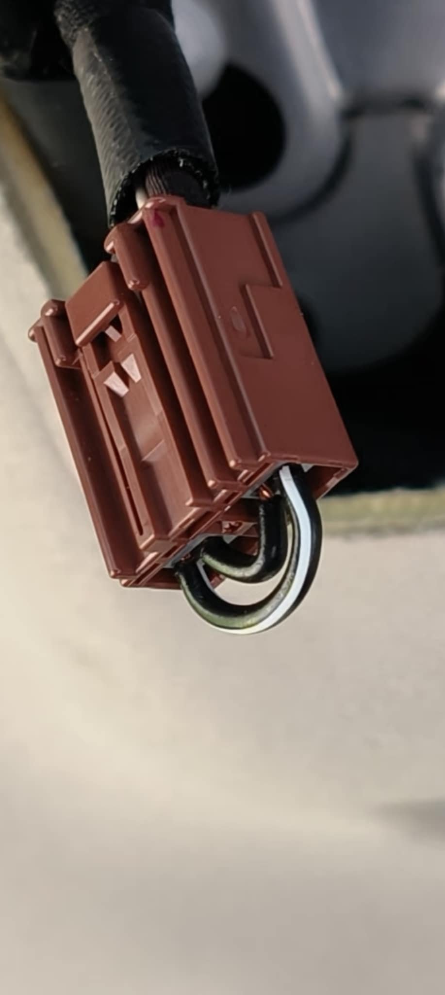

Thanks bro, are you able to confirm the photo below? Just want to make sure that I the bridging is right.
Cheers

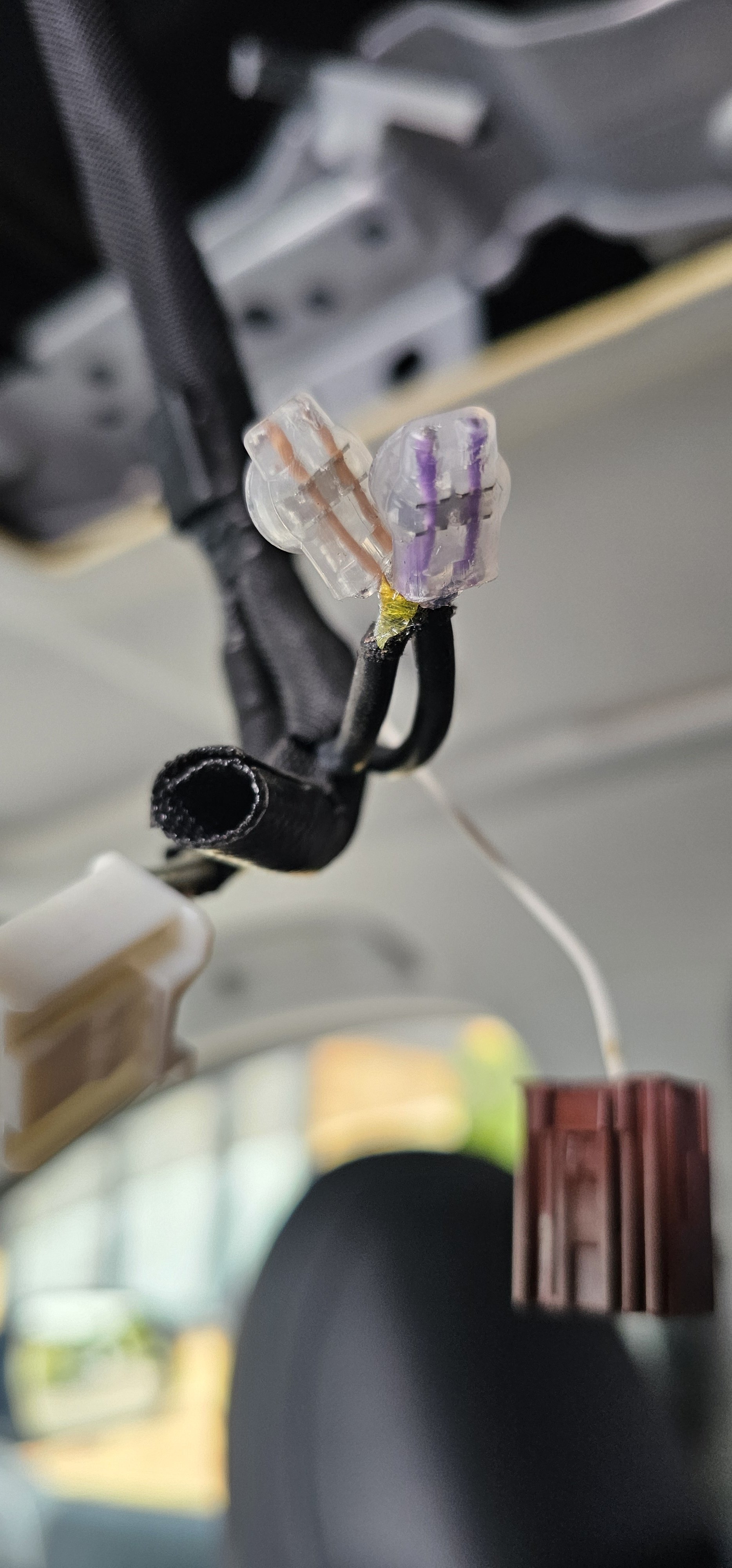

  • I ended buying a connector off AliExpress, then wiring as per the below.   Pin 1 -> pin 6 Pin 2 -> pin 5 Pin 3 -> pin 4   The sound is working, thank you everyon
  • Sure, below is the link to the listing, I got the male one.   https://www.aliexpress.com/item/1005005015791016.html In case the link dies at some point in the future, its a "28 Pin Auto
  • Tq my bro friend..finally my problem solved . Just join purple vs purple and brown vs brown. Tq verry much..Hafiz here from Malaysia 😀😀👍

The bridging works perfectly.

If u want to risk testing my suggestion above, you just need to short those 3 sets of pins.
Wooowww thanks alot, it's work at mu GGH20.

Mine is a 2013 Vellfire Gazoo Sport Edition with 18 speakers.  I have also removed the original screen to replace it with android screen.  I also linked the purple and brown wires together to get the audio working through the toyota amplifier.  Thank you fir the great tip.20250517_132951.thumb.jpg.54f7680afd33ce488dbb198d1aa0abdc.jpg
