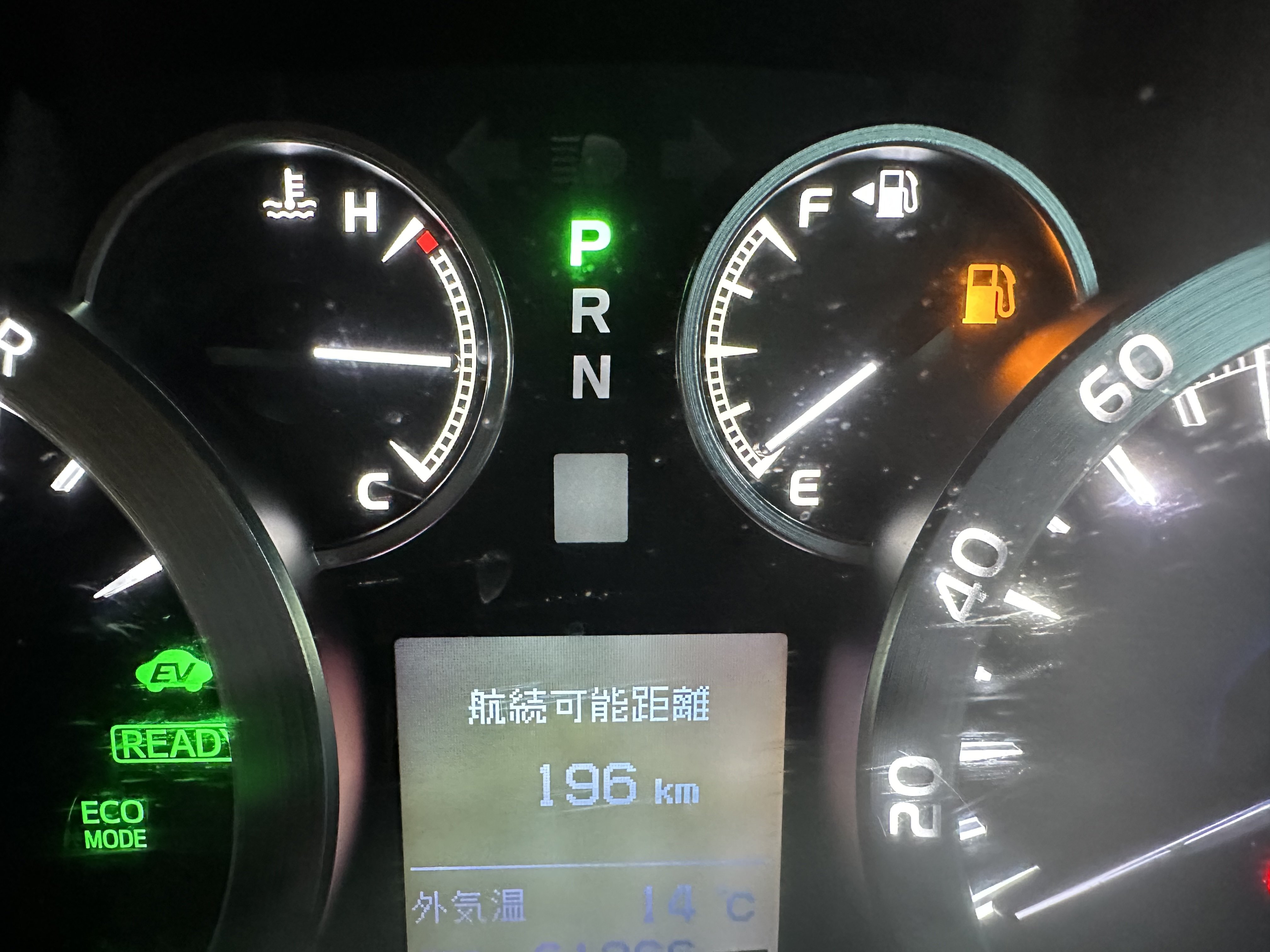

I'm getting a refuel light at just under 200km. I'm presuming that this is not normal behaviour...?
It's a fairly new import, and wanted to run the fuel down to check the refuelling light point.

Well, lets hope something here is screwy, or you're getting an absolutely dire 9mpg. Was the fuel tank actually full?
Is that range remaining? Have you had it sat idling for hours?
My calcs - 65 litres divide 4.54 = 14.32 gallons,
196km = 122 miles
122 divide 14.32 equals more than awful, almost unobtainable, 8.52 mpg.
Surely it cannot be!!!!

I think that I'll get in touch with the seller as clearly something is wrong with the electronics. As per your point @BigNev, that seems to be the most likely outcome.
If it empties at 200km and with a full tank it's at around 600km, then thankfully it's averaging at 18mpg (ie 400km / 60L).

Thanks Nev and yes, a classic Internet misunderstanding! Sorry for the confusion. You're right, (a) I was trying to say that the refuel light comes on when the calculated range on the dash is at around 200km, and (b) it's absolutely a computer guesstimate.
