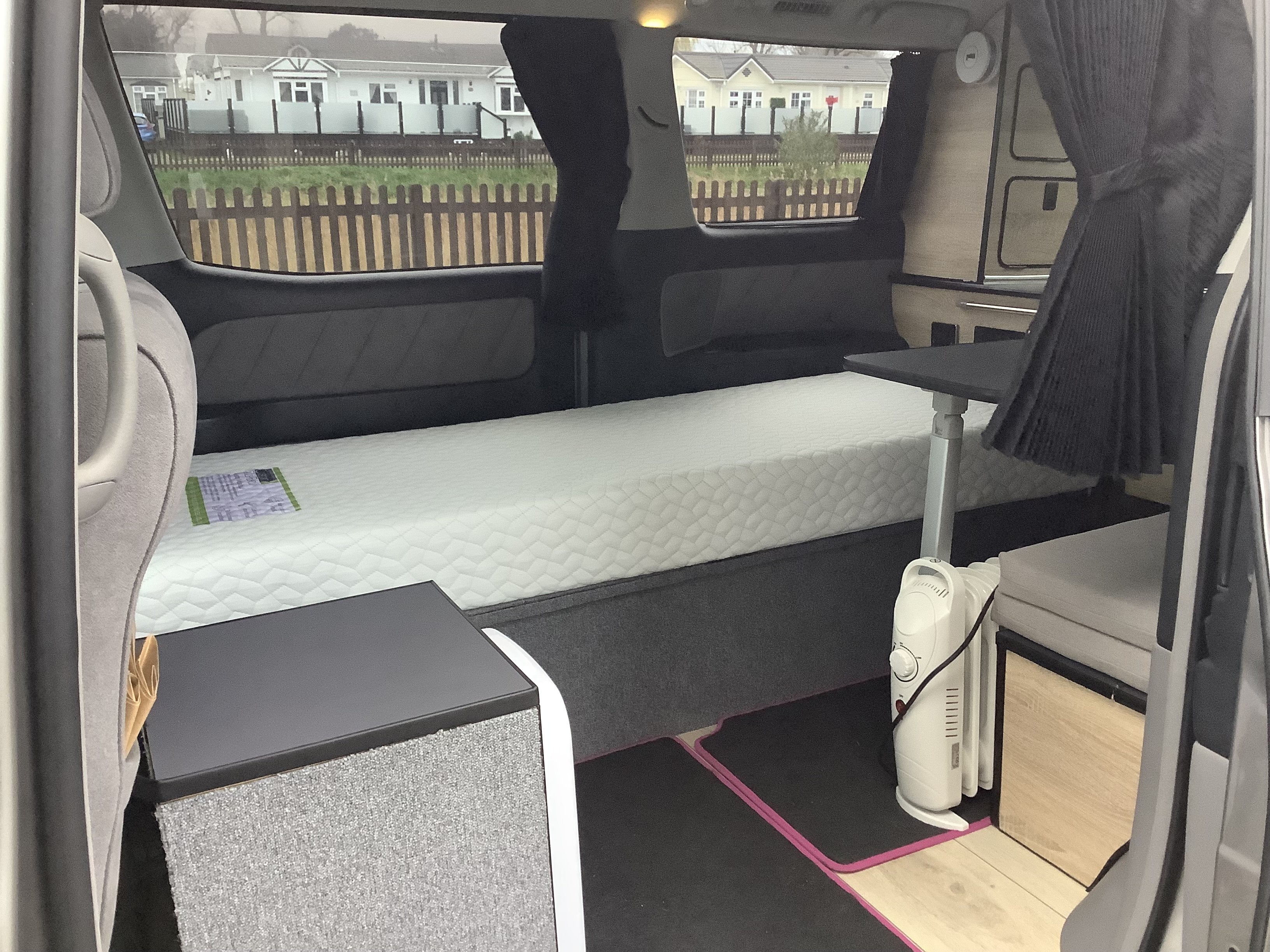

Hi yes I have done this to my Alphy. I removed the second row of seats and the carpet installed a laminate floor and built a bed base with storage underneath. I had a custom mattress made and it works great, also cut the table down as it is only me who uses the van. I have attached a photo.
Hi Chris, thanks so much for the reply and the brilliant picture. This is exactly what I was thinking of. Can you tell me how wide the bed is as I guess it doubles as a couch during the day. I'm also wanting to install a small fridge as I found the coolbox I had was too noisy during the night. Is that  one in the foreground of the pic?

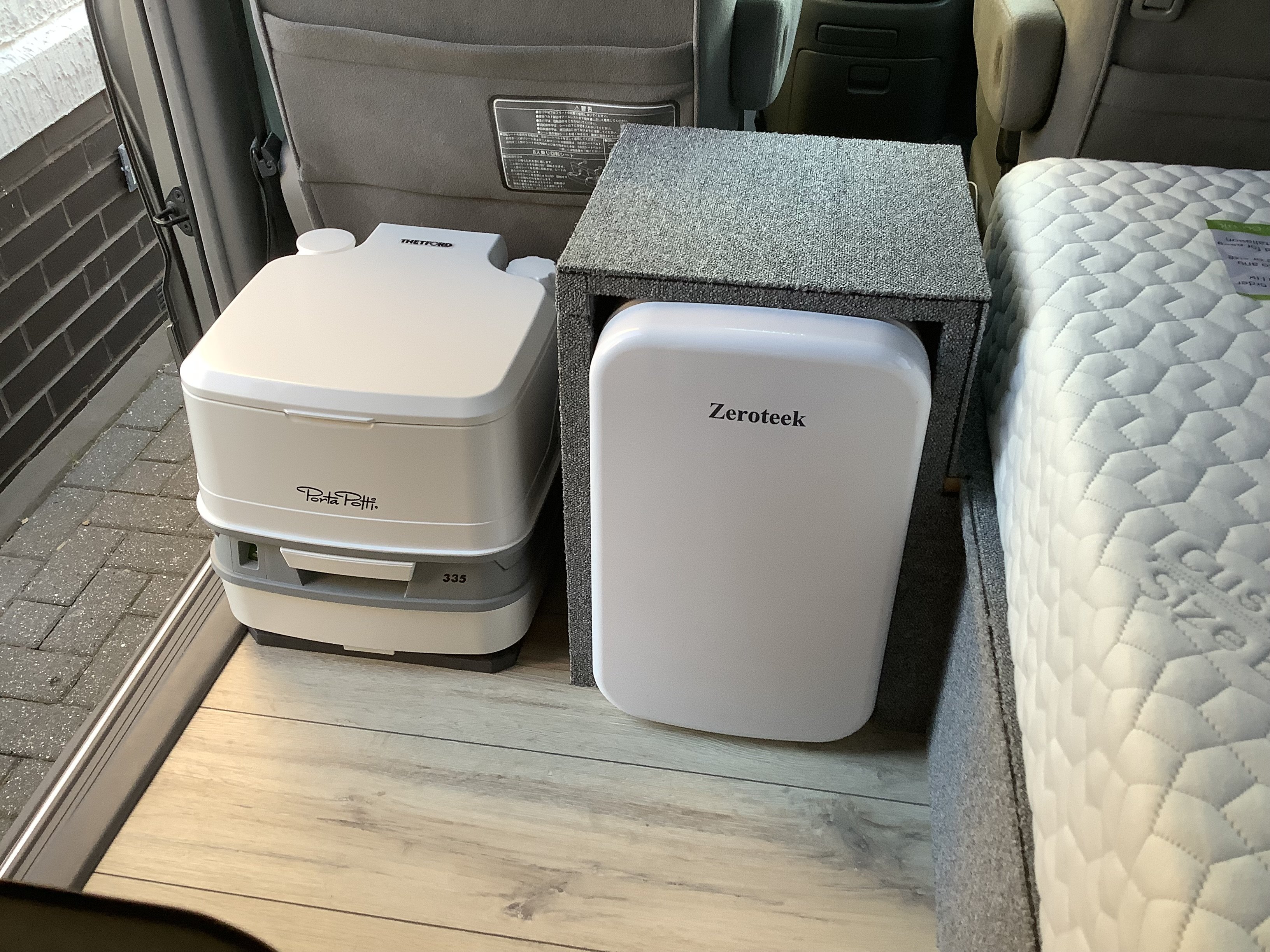

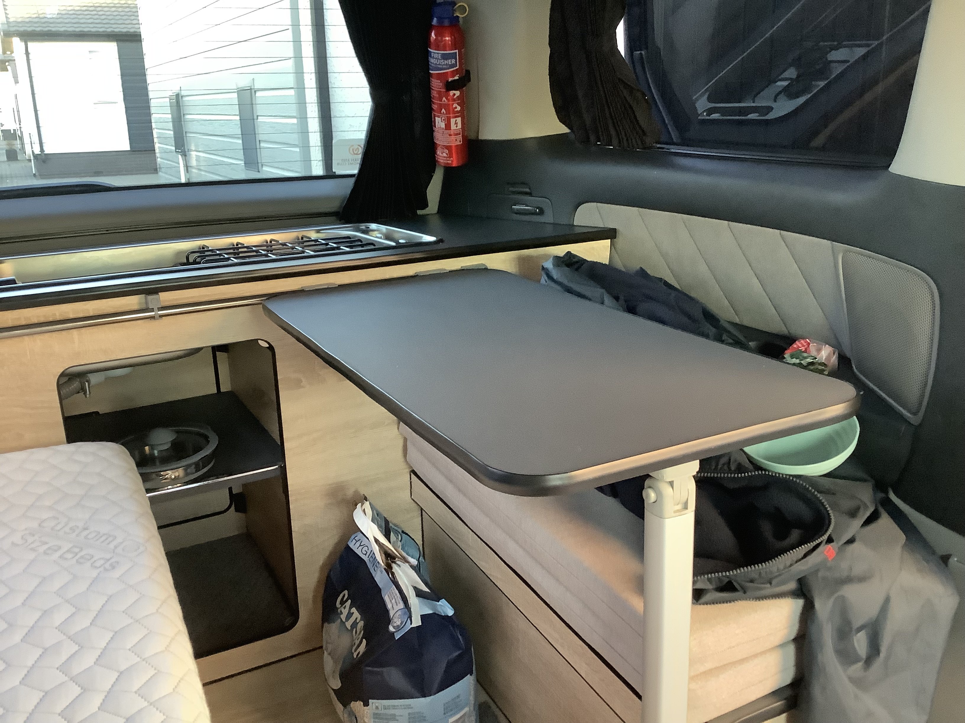

Hi the width is 63mm length is 179mm I’m only a shorty. The mini fridge is made by zeroteek got it on Amazon. I have also fitted a Thetford 335 porta potty. Am going to get a drive away awning for a bit of extra room. I have attached a couple more photos showing the fridge and potty and also the smaller table. Hope it helps.
Chris thanks very much for the information and the pics.  Ewan (Aberdeenshire Campers) wanted to know how the bed is fixed to the van. I'm guessing the bed frame is made of wood with storage under the mattress. Your van looks lovely and you've used the space well Would you mind if I take screen shots to send/show to Ewan who will do the conversion for me?  Thanks again for advice it's very much appreciated

Yep sorry I think I had a senior moment regarding measurements it should have been centimetres . The bed frame is wood fixed to the floor. Feel free to use the pictures.
