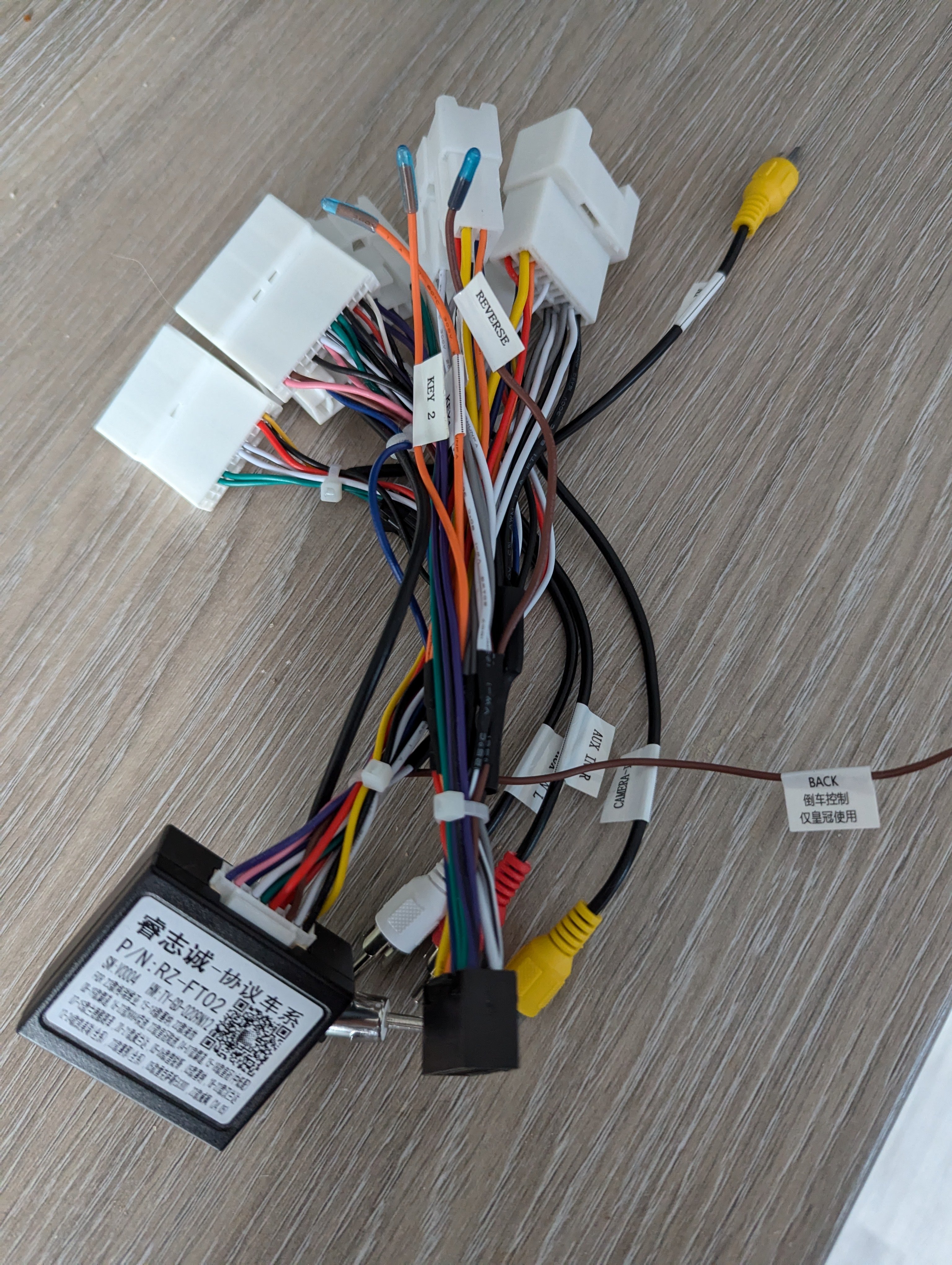

Anyway the old Sony unit went in with a new connection for the rear camera after I found the wire tucked away and got an adaptor, however it was just turned on with the head unit, never the reverse. I did find a 4 pin plug that was lose that had a 12v ign feed, an earth, a cable that was 12v when I use reverse and a 12v for the parking break signal.

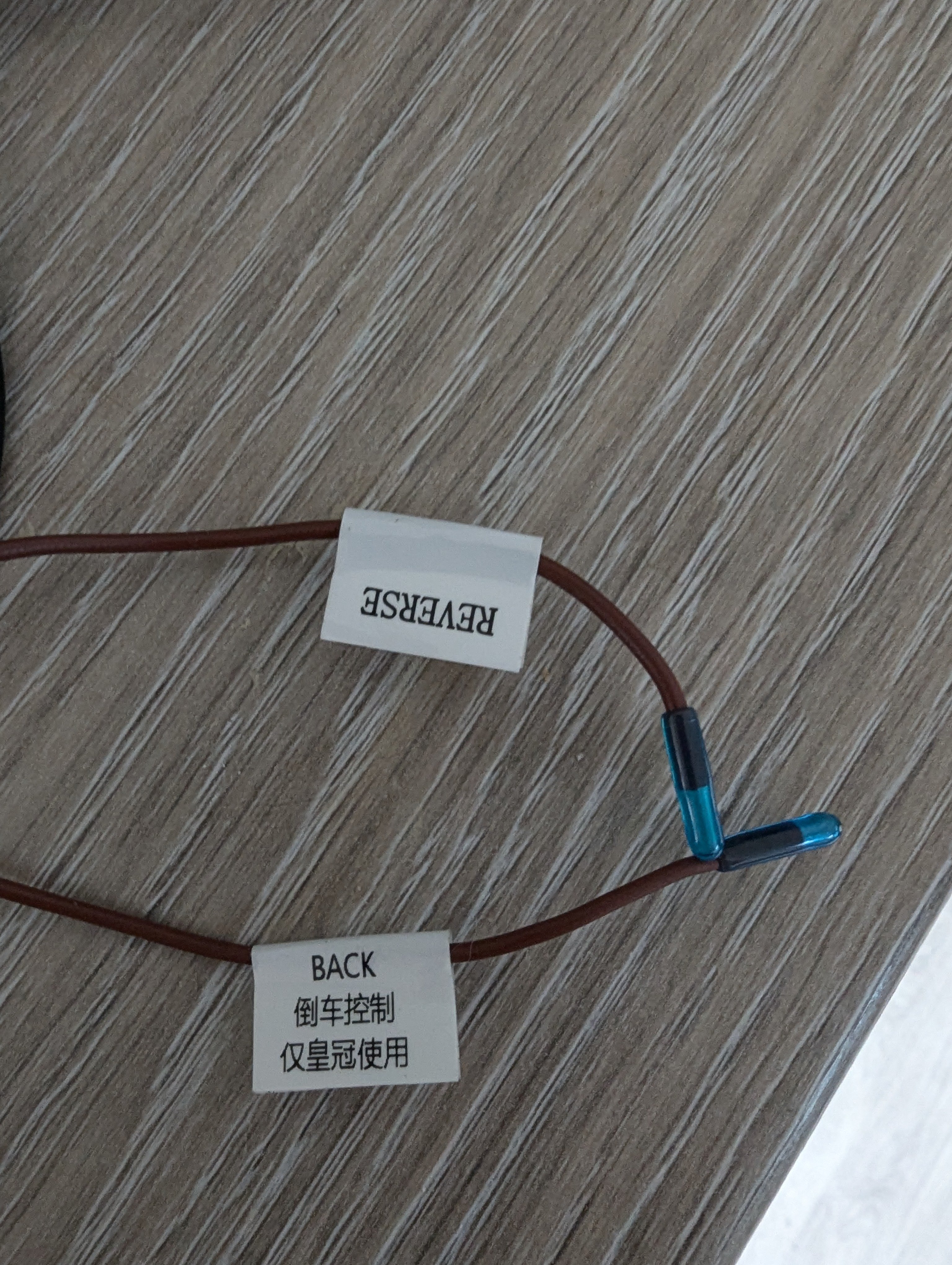

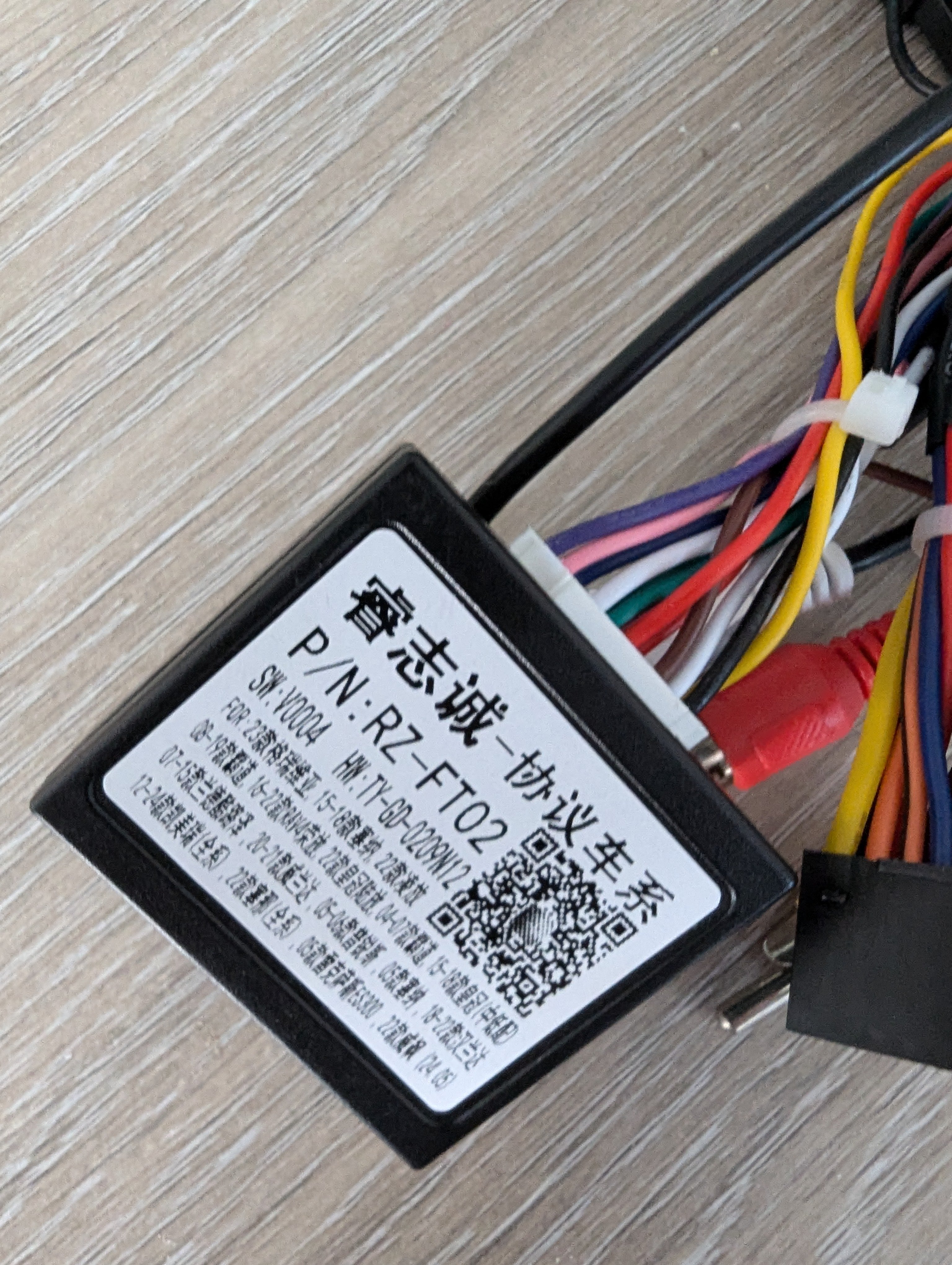

I now have a new quality android unit and got a new cable for it with a canbus, however there are 2 brown leads, one coming from the head unit loom saying reverse, one coming from the canbus saying back.
I have read on the Teyes website (who supplied the canbus), not to connect the reverse lead if its controlled by the canbus because it can cause damage.
Anyone fitted an android unit with a canbus? Is the 12v lead needed and if so, where do I connect it to. The canbus lead or the wiring loom? Or do I join "back" lead from the canbus to the "reverse" lead on the head unit loom?
