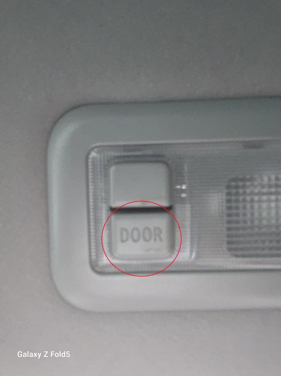

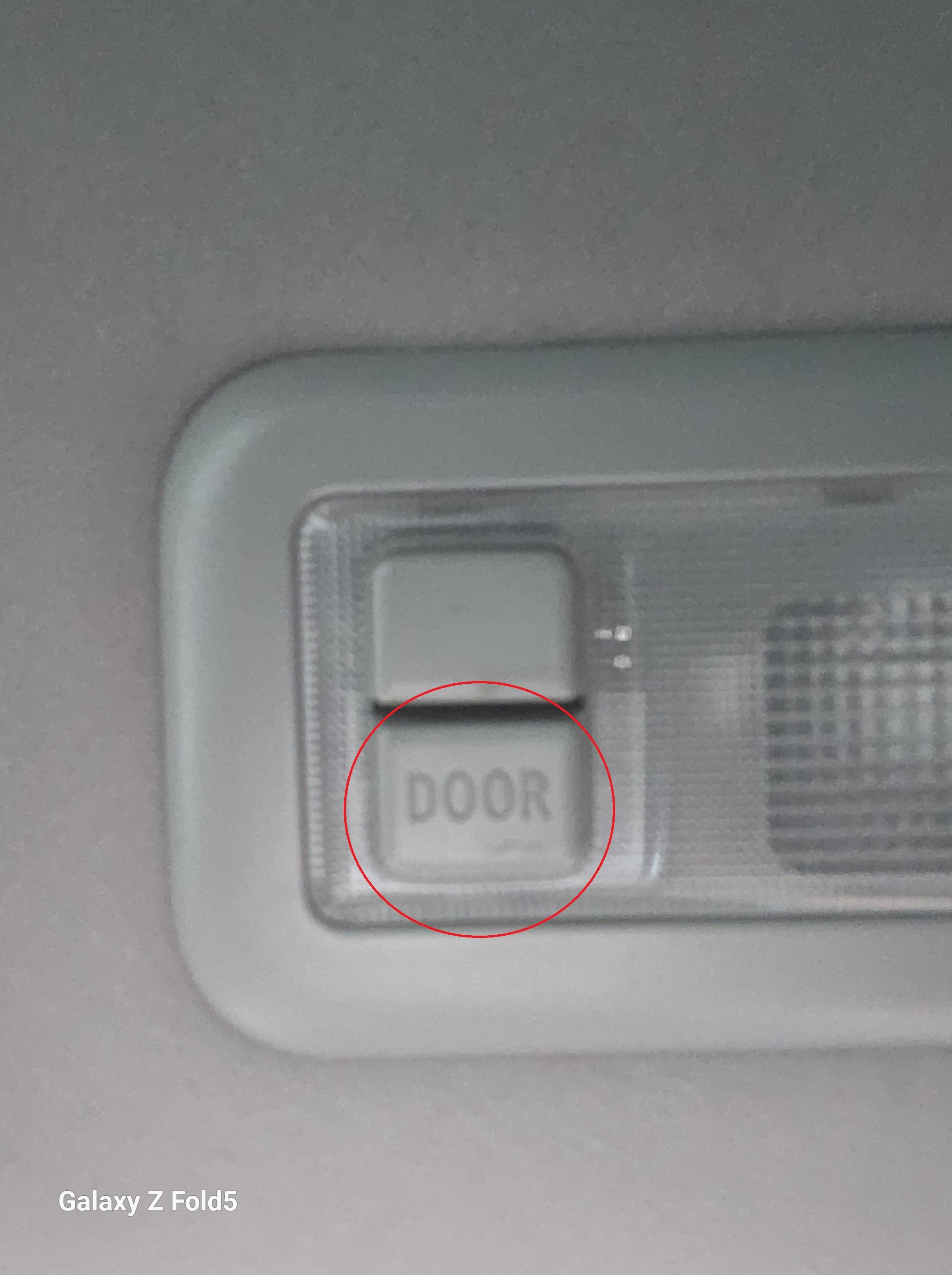

hello open drivers side sliding door where light is above your head there is 2 buttons one says door make sure is not pressed in this will turn off all lights in the back when you open any of the 2 rear doors including tailgate you will need to deativate the front courtesy light in the front 2 stop lights coming on on front doors picture atatched

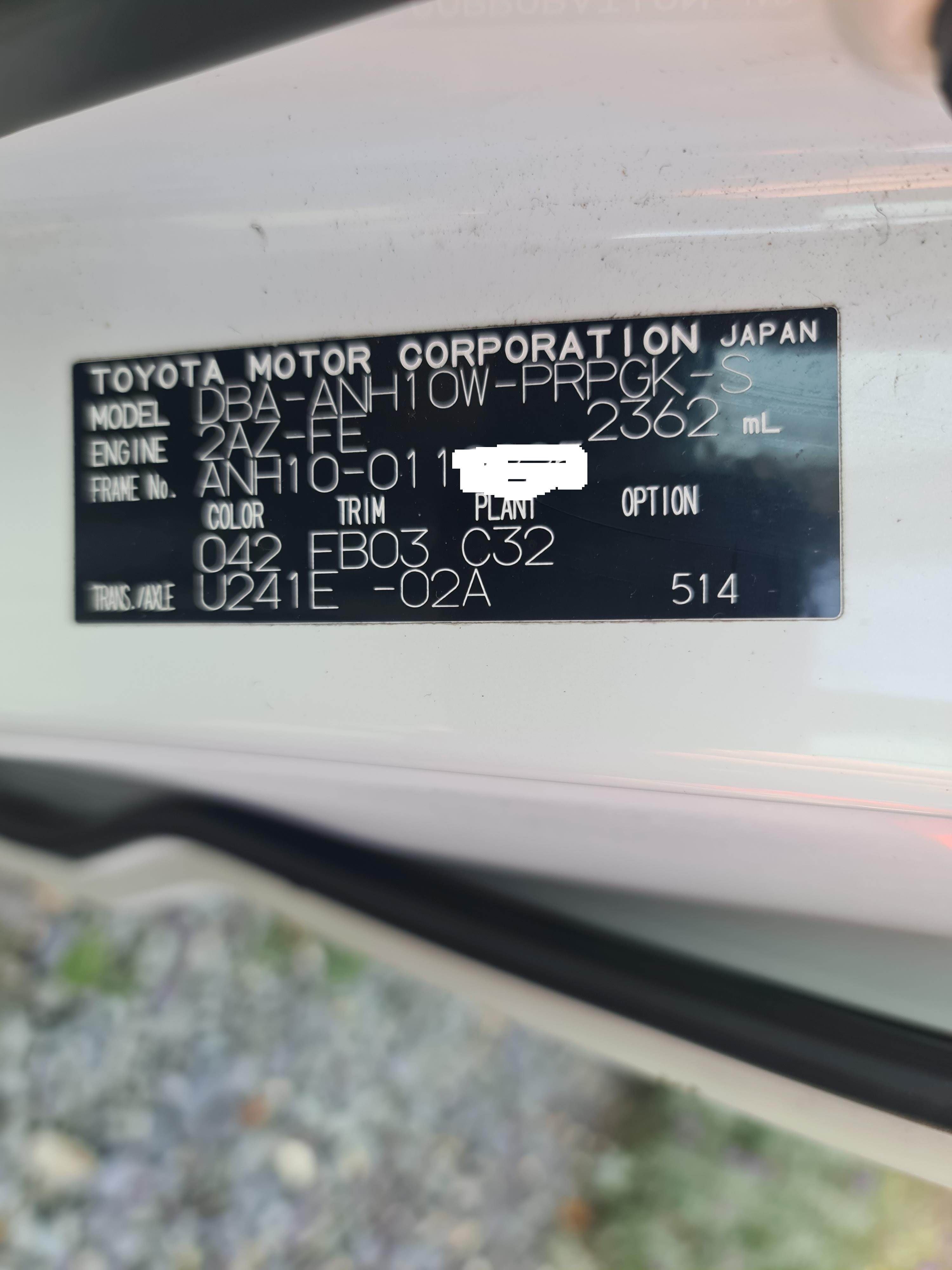

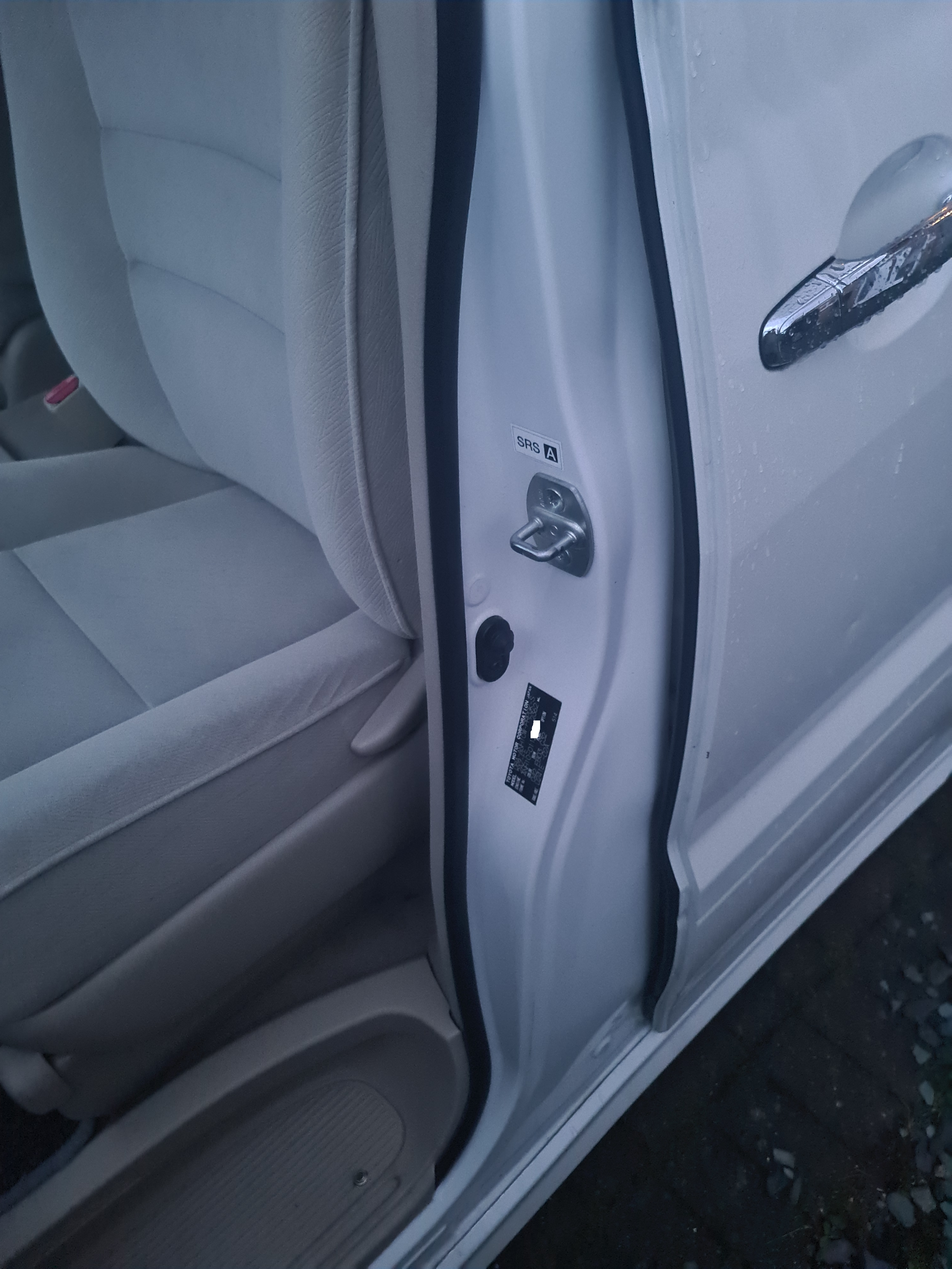

What is the beginning of the VIN ?
ANH 10, or 20 ?
It is on the B pillar nearside.
ANH 10, or 20 ?
Hi Richard, Thanks for your potential help and sorry for slow reply.  The vehicle  is a Japanese import and the only nearside label I have found so far is in Japanese hyroglyphics with no ANH number.  I will look again when it stops raining!
Here is mine for reference.
Edited by Gamith
Added a second picture to show where on the B column the info label is.

Your vin is also under the small removable plastic cover on the floor just in front of drivers seat.

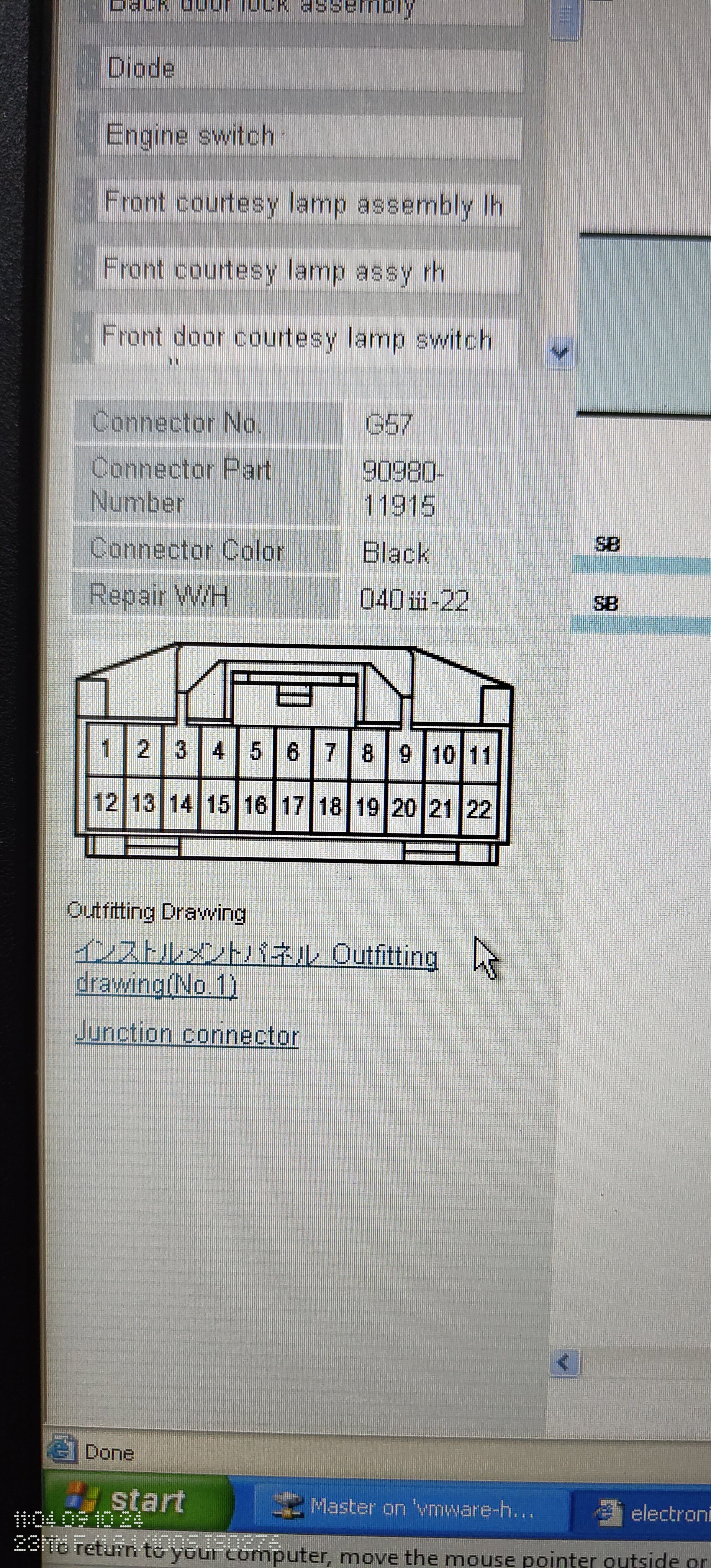

It means you have a 20 series, the ambient rear lighting has a control module behind the rear climate controls.
I've not looked into it, but it should be possible to add a switch to kill power to the rear lights, i imagine you could intercept the live from the b pillar, not I've not bothered to locate the actual wire.
You could check the wiring diagram available online.

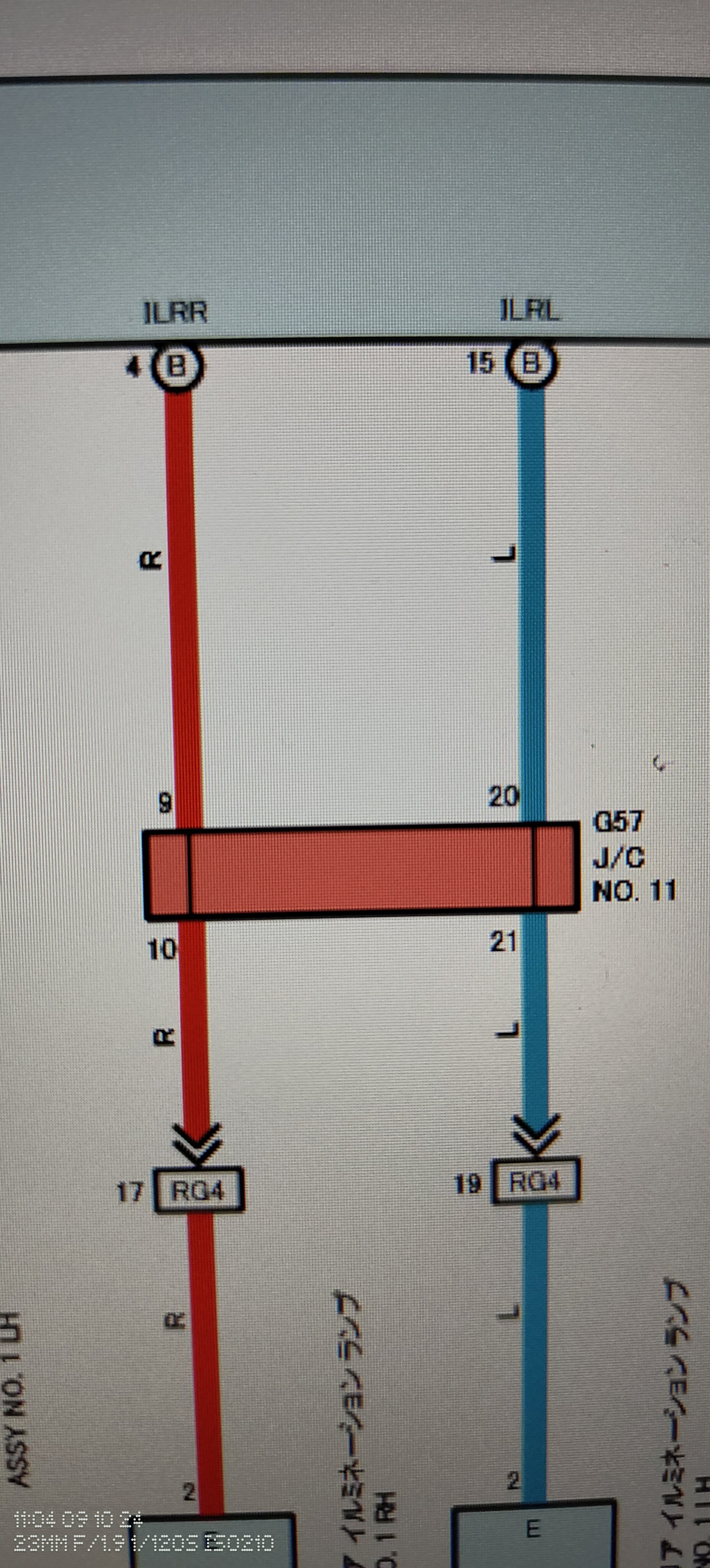

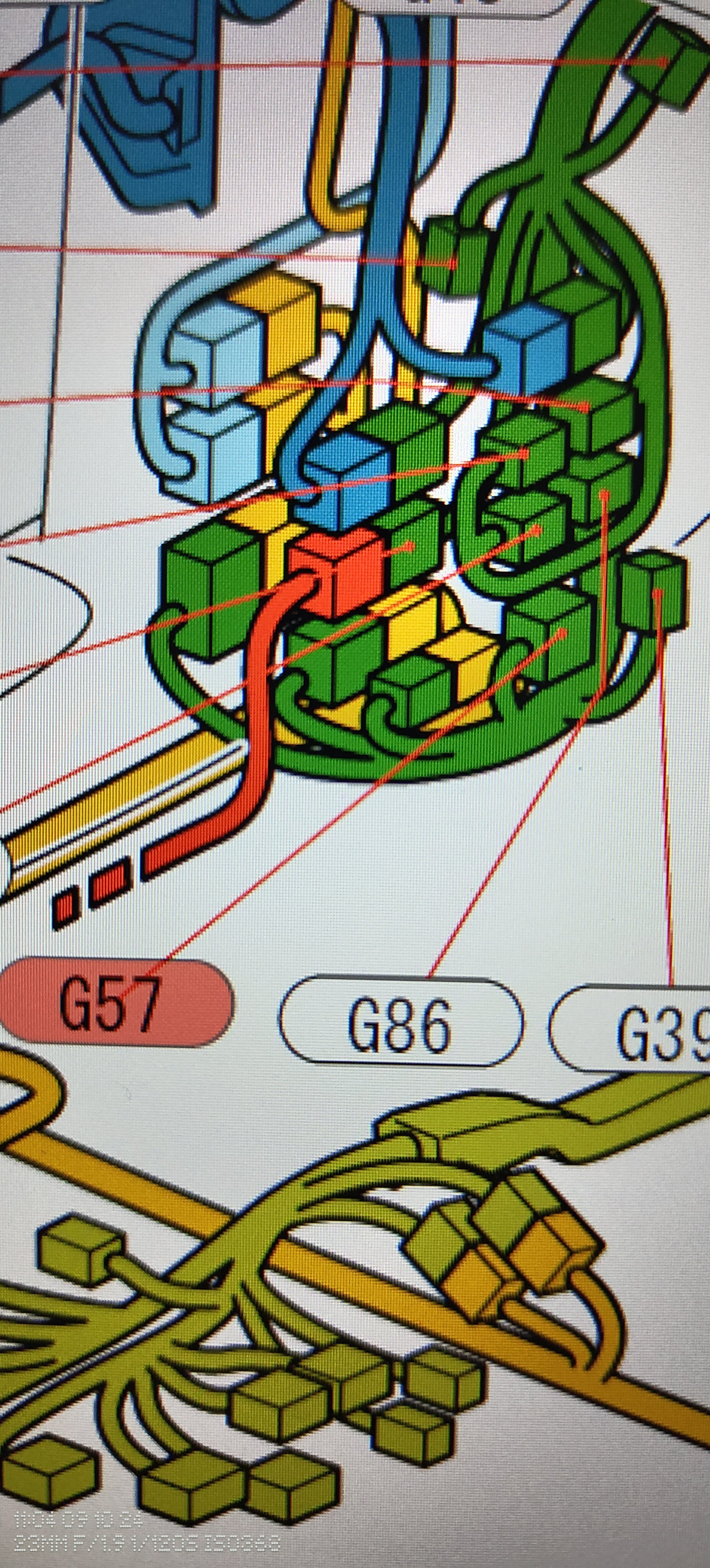

Ok.
I think i have an idea.
The long roof lights.
There is a connector junction block that seems to loop back.
If we break this loopback and fit a separate on off switch, we can manually defeat the logic that activates the mood lighting completely.
The following images show the circuit, the connector and it's location.
You can see the circuit literally shorts pins 9 and 10, and pins 20 and 21 together.
If we access the socket, expose the wiring and cut, fit a DPDT switch, we can manually override the operation of the auto mood lights.
