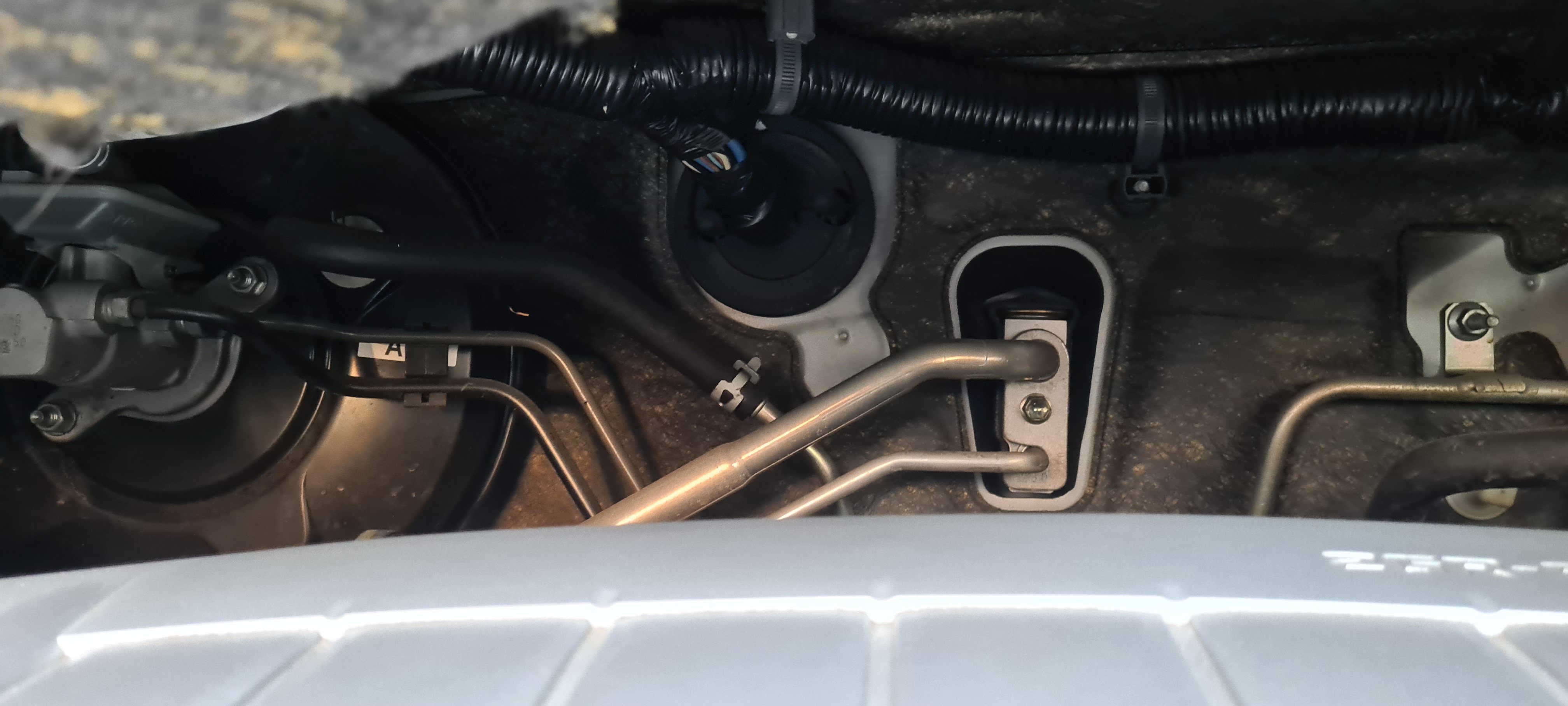

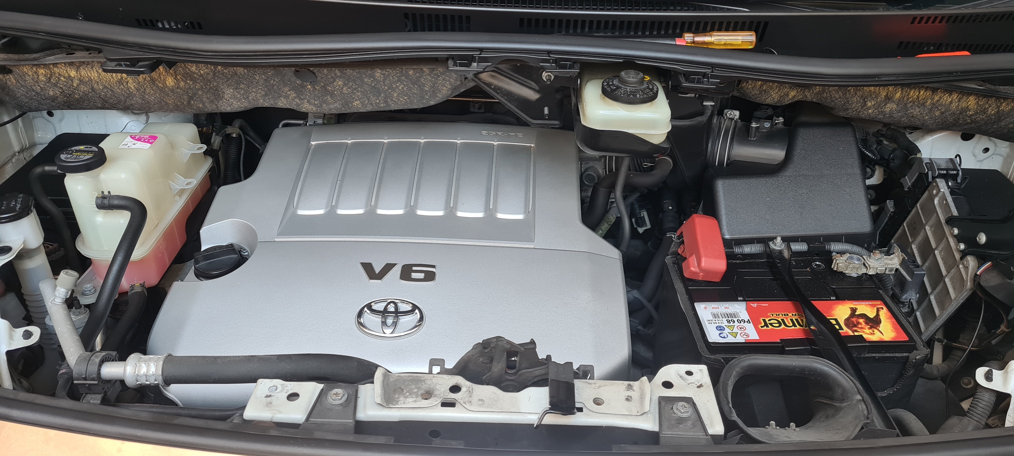

I'm trying to run a cable from the engine bay into the cabin (either Drivers side or Passengers side).

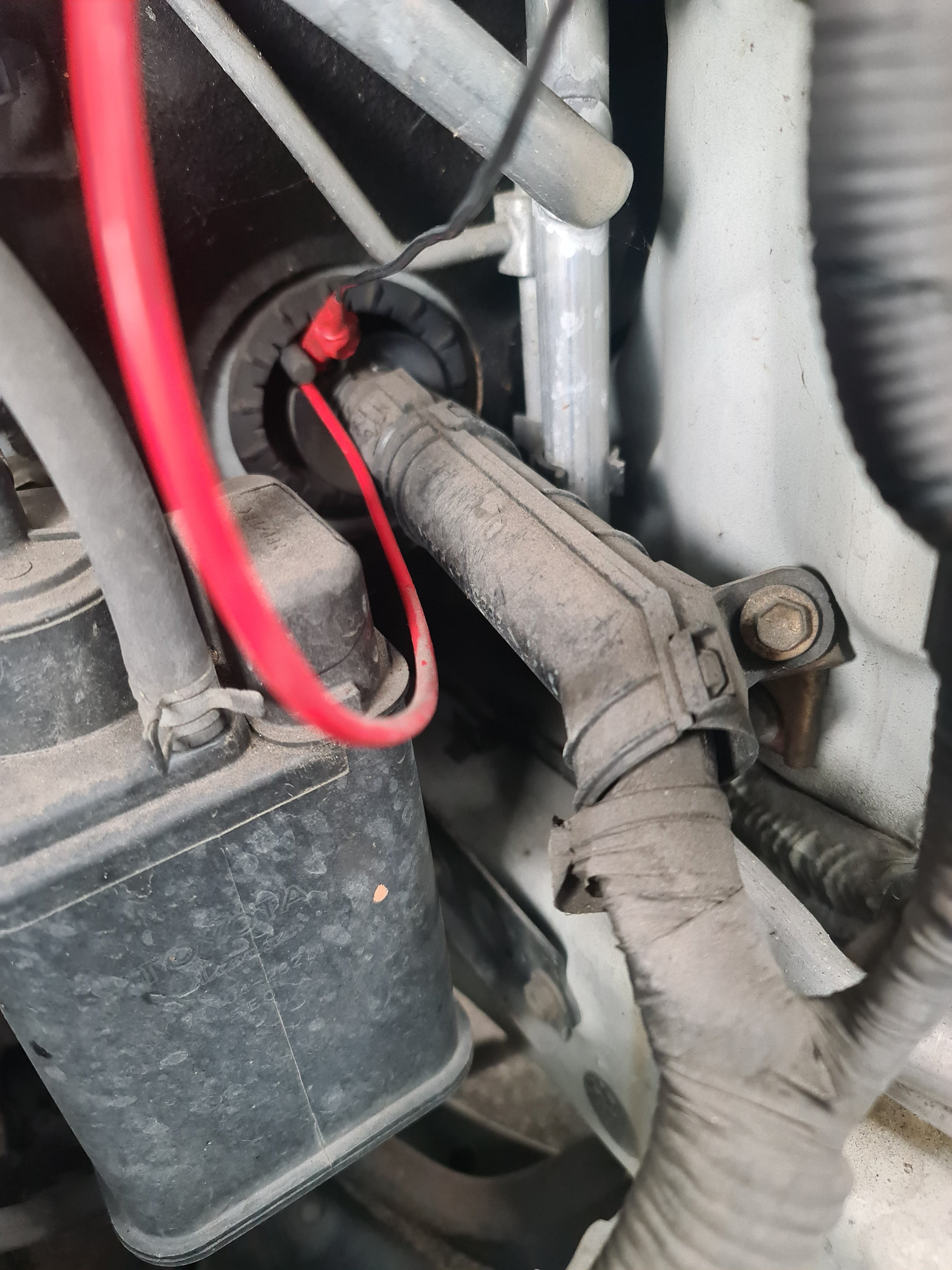

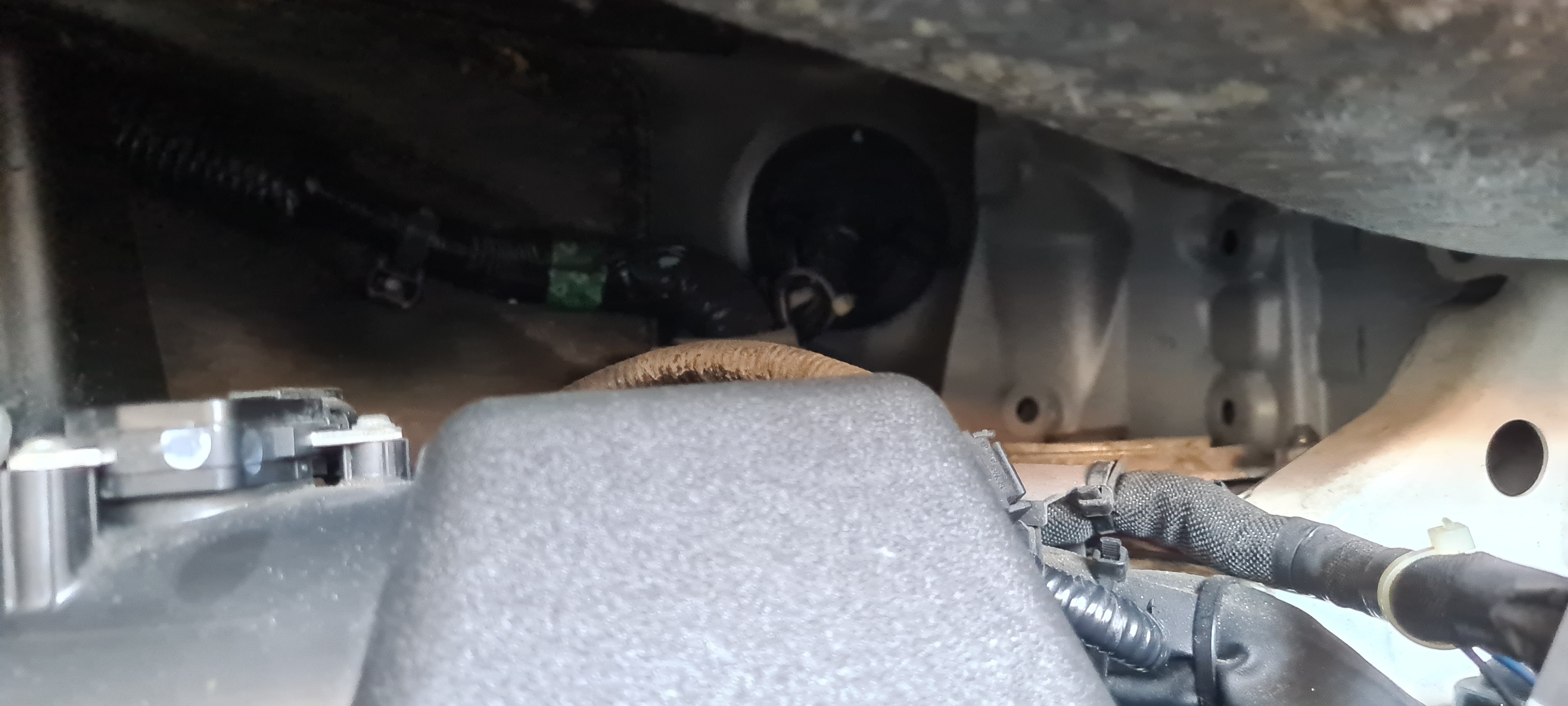

I can see the 2 main grommets (O/S pic 2 and N/S pic 3) in the engine bay but I can not find where they come out in the cabin.

I have just done this and used a bulkhead grommet that is on the passenger side and quite easily reachable from the passenger foot well.
In the engine bay, standing in front of the battery, look down and towards the bulkhead where the passengers feet would be - there should be a large collection of wires in a pipe of sorts which goes through a rather large rubber grommet.
Mine already had a red cable going through it so was rather easy to see.
I used an unbent coat-hanger, looped at one end, to push through from the bulkhead from the engine bay and then attached the wire to it in the footwell and pulled & twisted until it came through.

I managed to do it eventually, I didn't see the carpet (fabric) covered bung behind the glove box.
It was a bit of a pain reaching the passenger side grommet in the engine bay (I've got sausage fingers that kept cramping up 😆).
