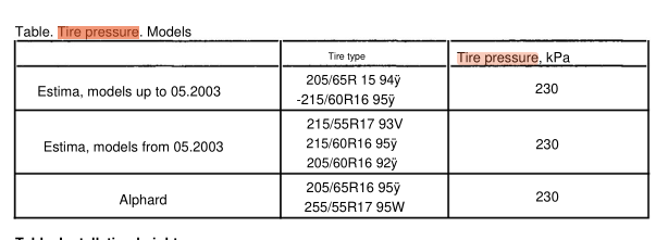

240kpa from memory. About 32 / 34 psi.
One of my scanned manuals has this: image.png.ee13fde5cab56c45df29865e71cbb979.png

I had Pirrelli P7's on my Mk2  Estima's 215/60/16 and put in 35 psi. I cannot seem to get Pirrelli P7's for the Alphard, So I have 4 x 205/65/16 and put in 36 - 38 psi. My Alfie is invariably loaded up
