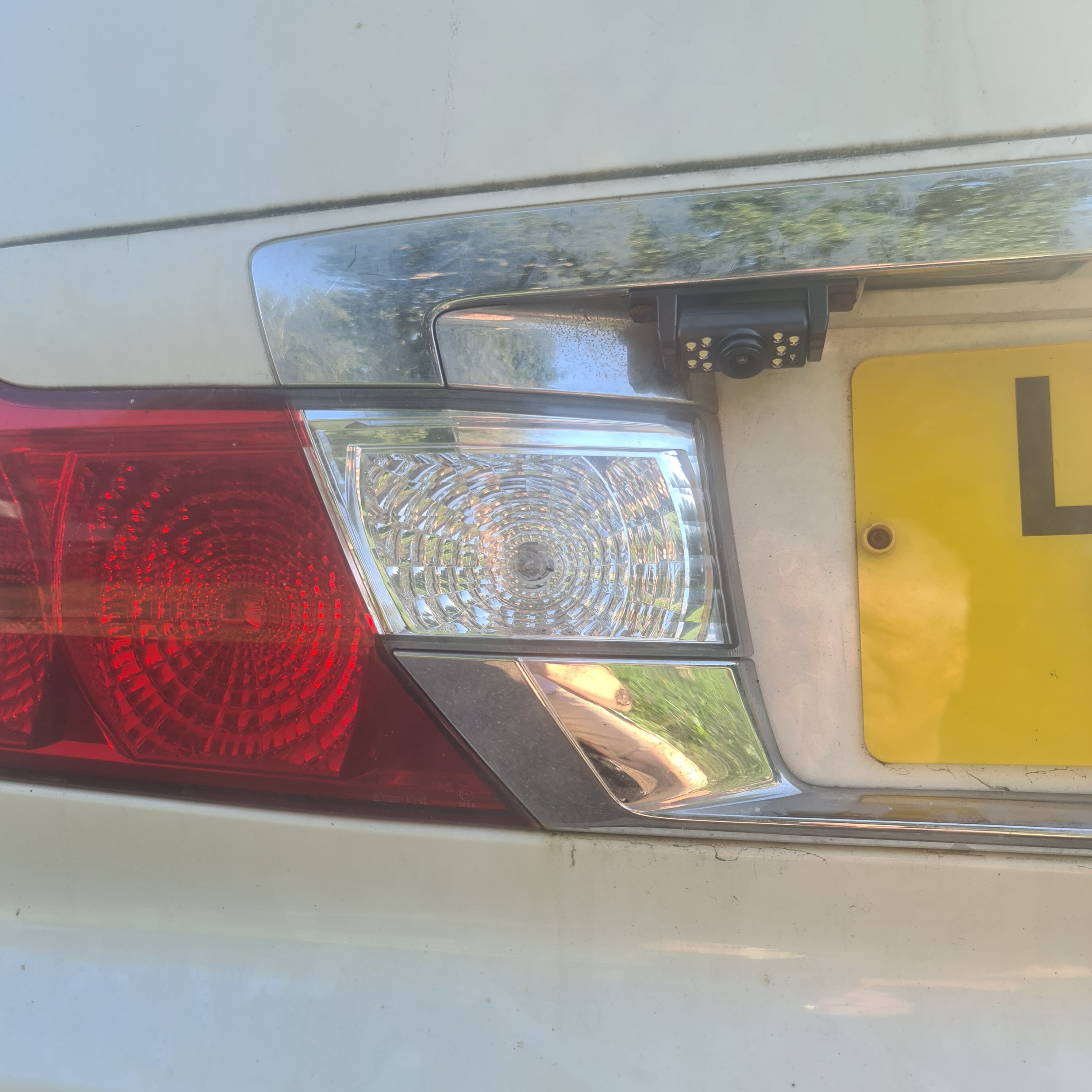

It doesn't fit in the hole, mores the pity, but a previous owner fitted a similar one, screwing into the bodywork. I am hoping the replacement fits and gives a wider angle view.
https://amzn.eu/d/eK6xo3m
I replaced mine with this, works well connected to a pioneer head unit,
Had to make a diy mount, fitted through the original gap ok. Such an improvement on the original only issue the reverse light reflects on it quite a bit when dark no issues in daylight, it is a led bulb maybe a standard type bulb won't be so bad.
So my one had a 'previous owner supplied' unit which was ugly and impractical. I have now got a similar unit which attaches in the same location, but it's equally not pretty or uses the original wiring loom - it has it's own 12v feed and video feed.
None the less here is my solution. A good point is that I can tilt the camera up and down to get a better view, currently it has the bumper in view and a few feet beyond that, but also I get a much wider view - I can see both sides of a parking bay, where before I was only seeing a zoomed in view of the very back of the bay.
This camera does a much better job.
