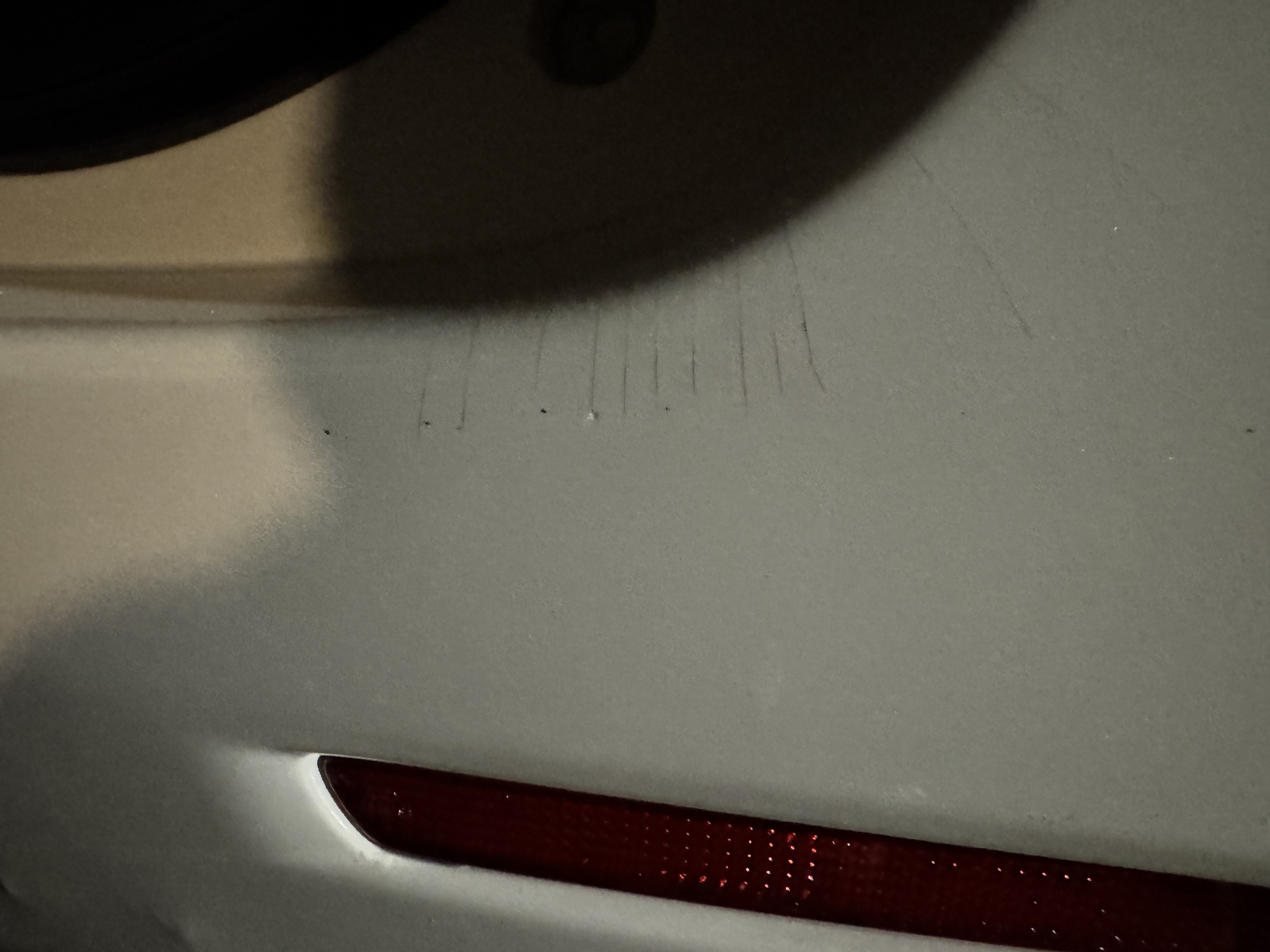

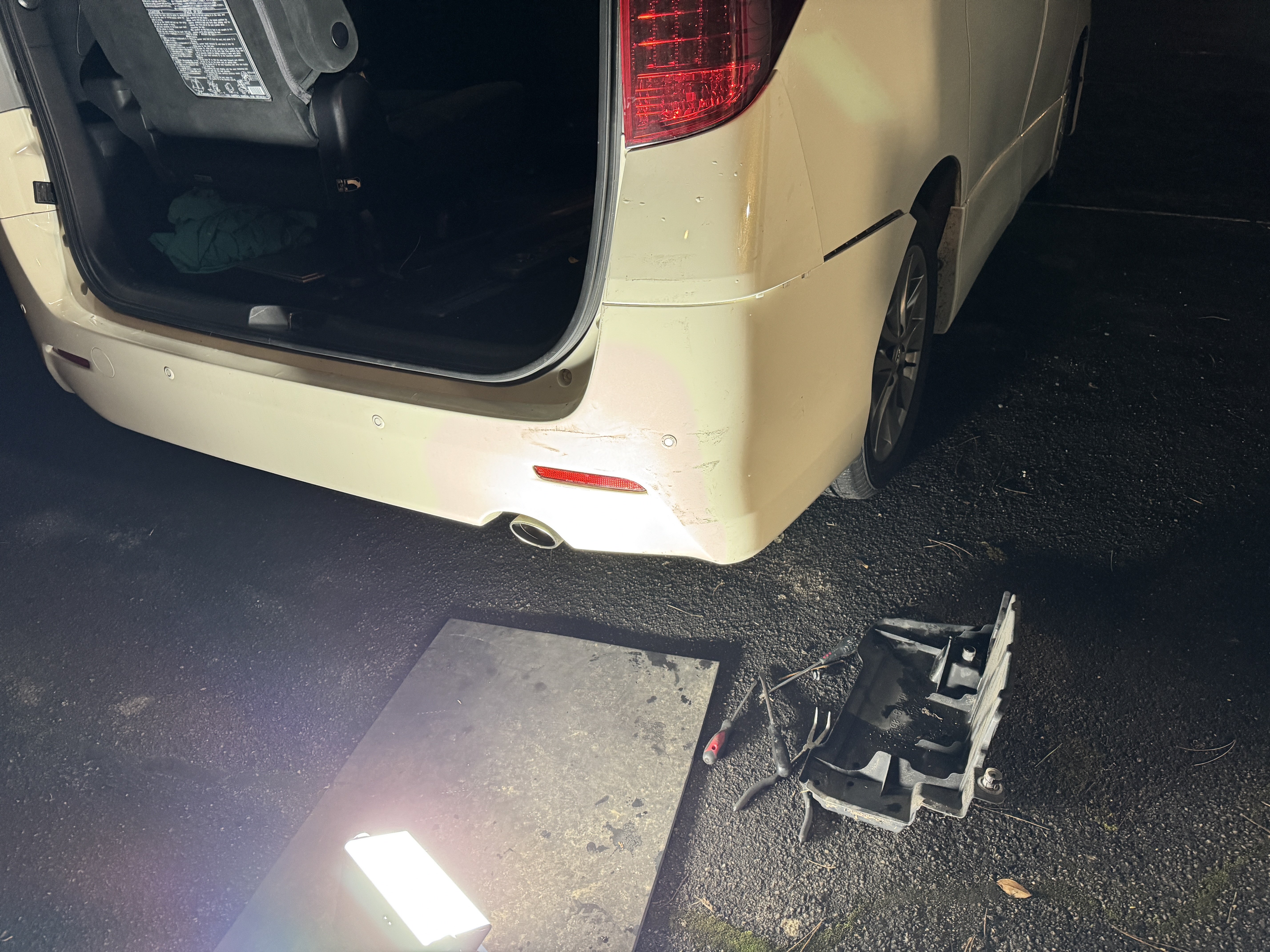

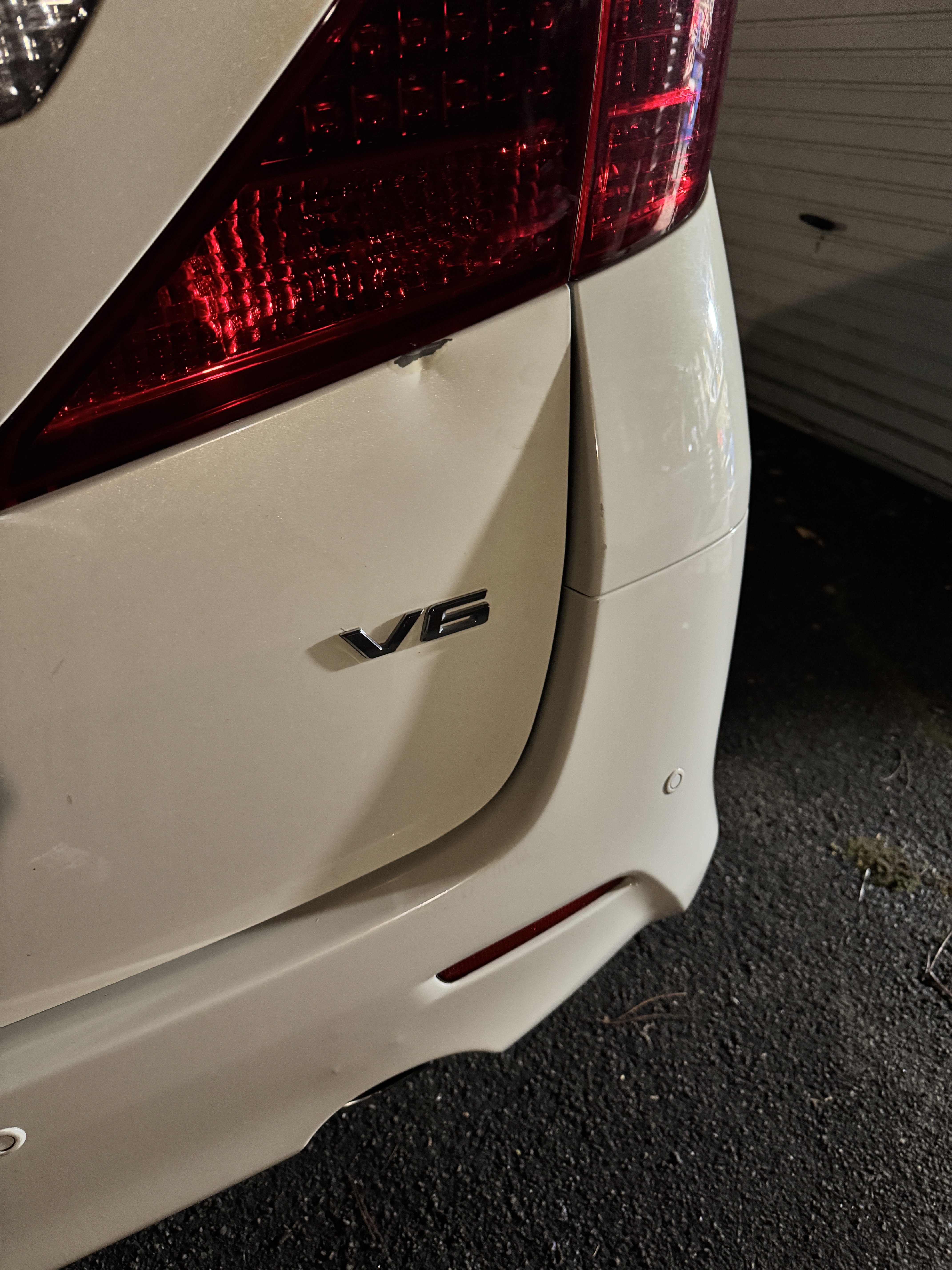

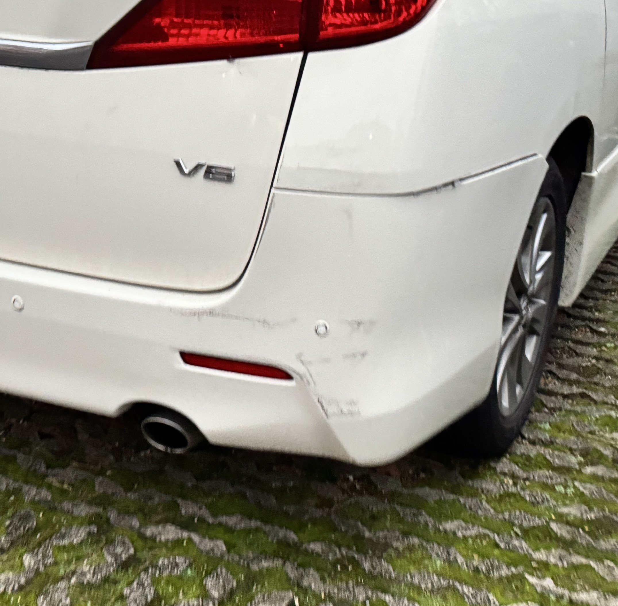

Not a great week. Managed to prang the rear drivers corner on my neighbors car on yesterday. Was looking out the window and not at the camera, lost an entire pug 207 in the blind spot. Was absolutely gutted, haven't hit a sausage for 15 years then go a back this thing into a stationery car at crawling speed! How did i manage that! Stoved the door of the 207 in and ruined the wing mirror. My car, it popped the rear bumper off, star cracked the paint and bent the bumper hangers slightly, then put a big ding in what was a pristine tail gate.
After crying it off and groveling to number 34, who was very calm about it fortunately, i refitted the bumper and the plastic close out panels underneath. The bumper hangers and clips all just pushed back into place. Fortunately the ends of the chassis rails look untouched. The paint is damaged, lots of chips, but the paint off the other car all polished out. Then i had to remove the light, rub down and nail varnish the big ding. There's a few other chips which have flashed over with rust i didn't spot initially, will tackle them on Sunday.

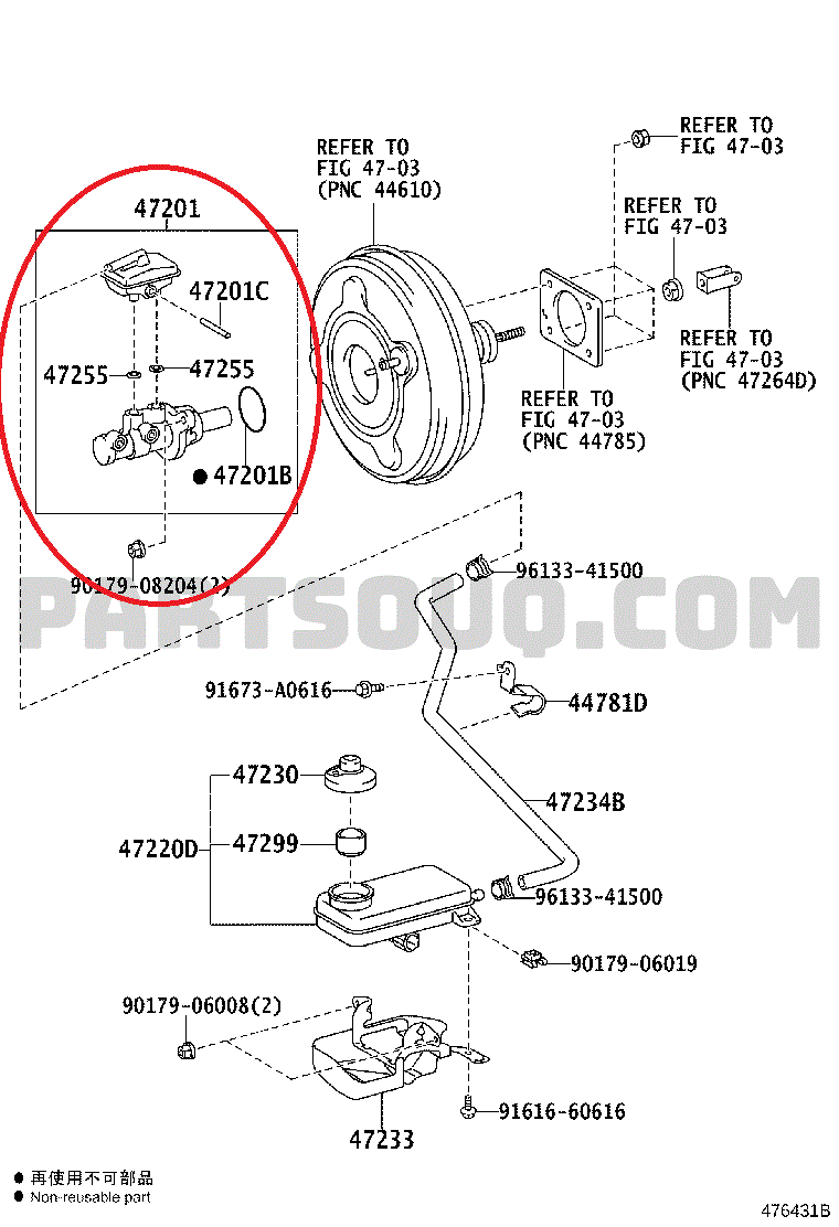

Regarding master cylinder part numbers. ive identified pn. 47201 on Yoshi parts.
https://yoshiparts.com/parts/car/toyota/products/alphard_vellfire_hv/ggh25-ggh25w_pftsk-jp-2grfe-350s-6fc-alphd-07s-cbu/1994494_49?one=[["year_list"%2C"2010"]%2C["engine"%2C"2GRFE"]%2C["frame"%2C"GGH25"]]&two=[["vehicle_model"%2C"ALPHD"]%2C["grade"%2C"350S"]%2C["seating_capacity"%2C"07S"]]
The only source for it i can find in the UK are Japeuro car parts. Rather expensive, although cheaper than driving into your neighbors car, and not in stock at the moment, but was told i could have 1 in two weeks time.
https://www.japeurocarparts.co.uk/buy-genuine-brake-master-cylinder-89067-2314-2122-6-d
I'm presuming, this is a standard Toyota master cylinder though. The Hilux ones look similar, as do the LandCruiser ones. Has anyone fitted an alternative before?, what do you think my chances are getting this to fit? just change the reservoirs over?

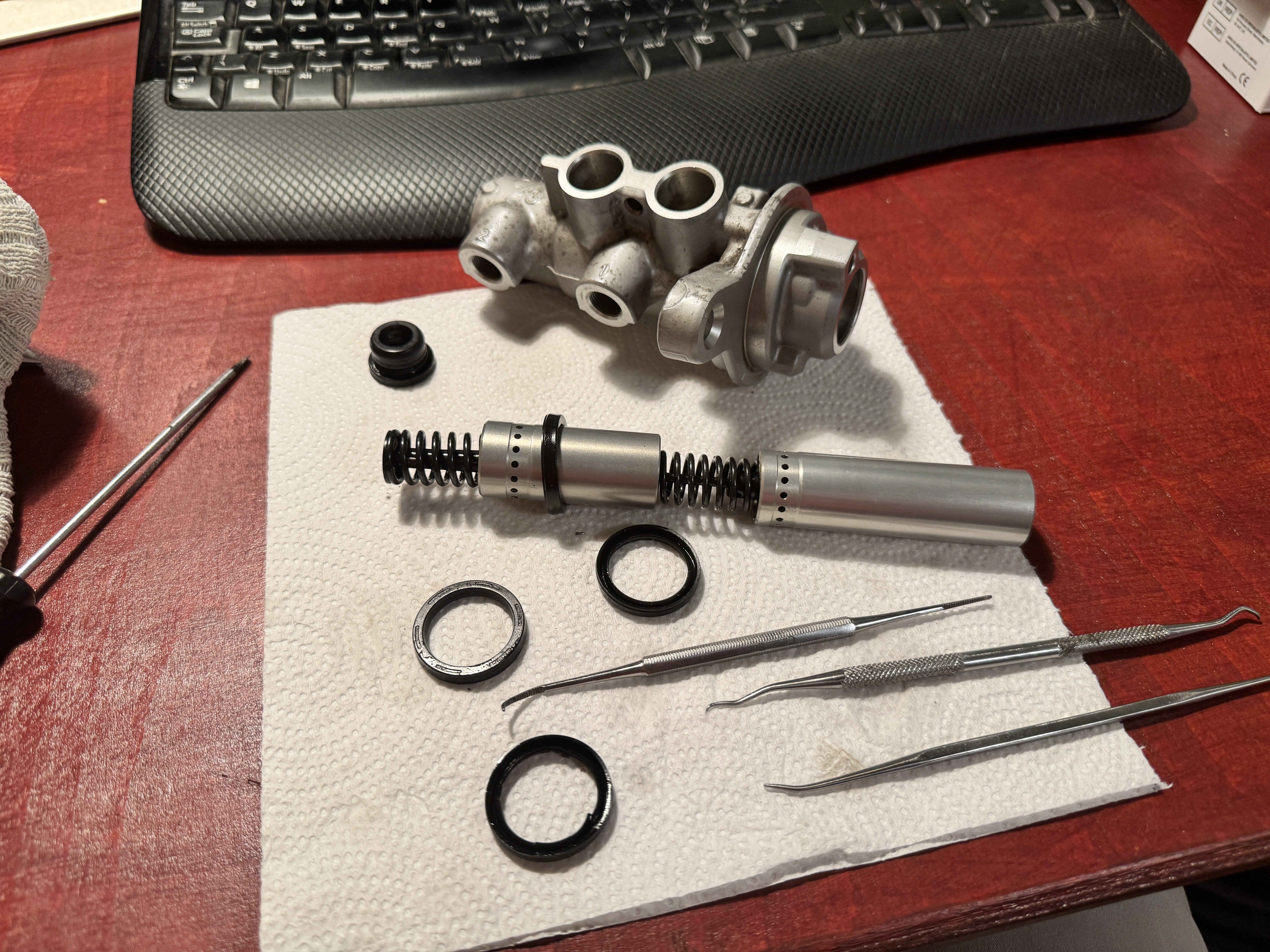

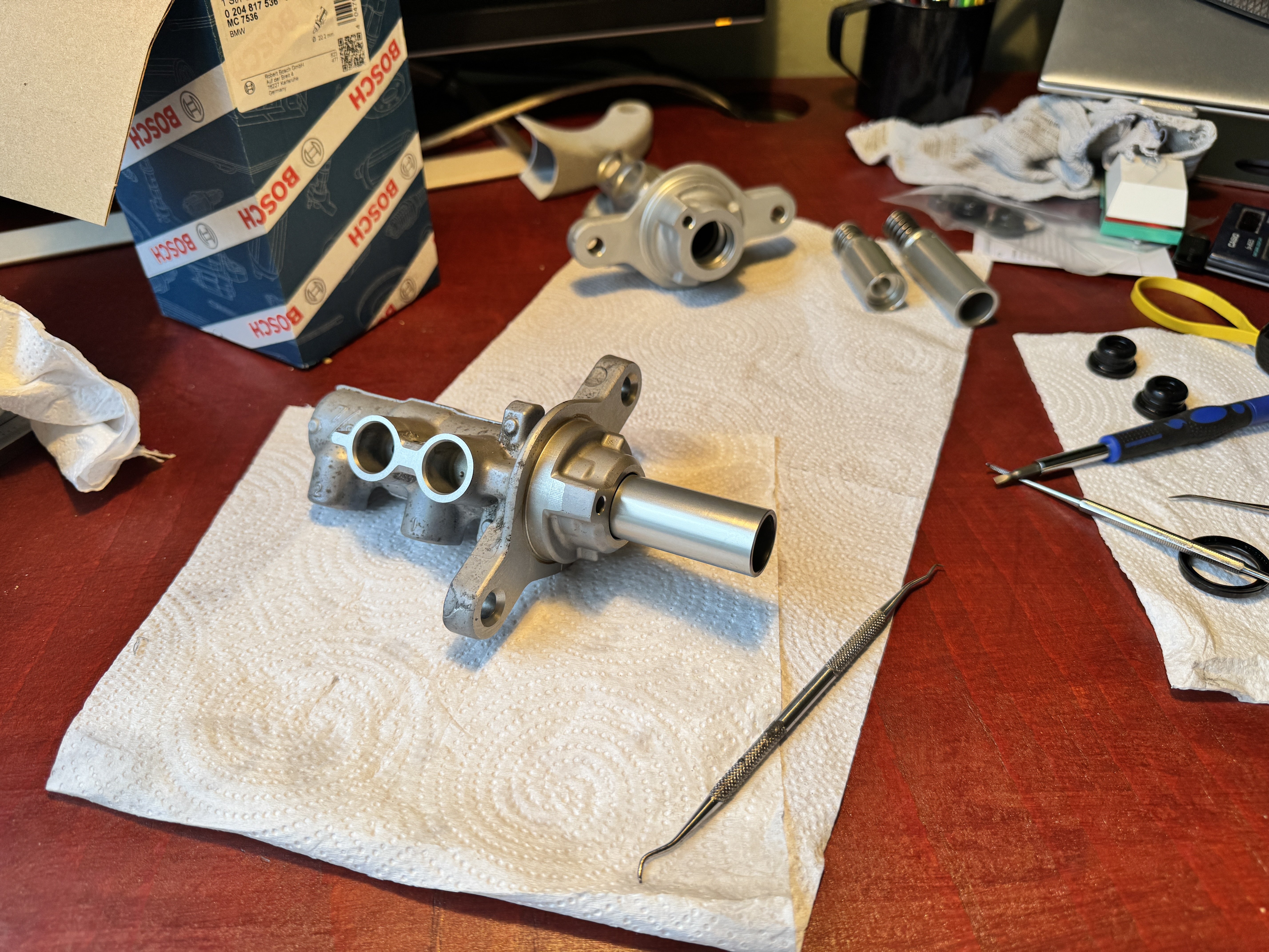

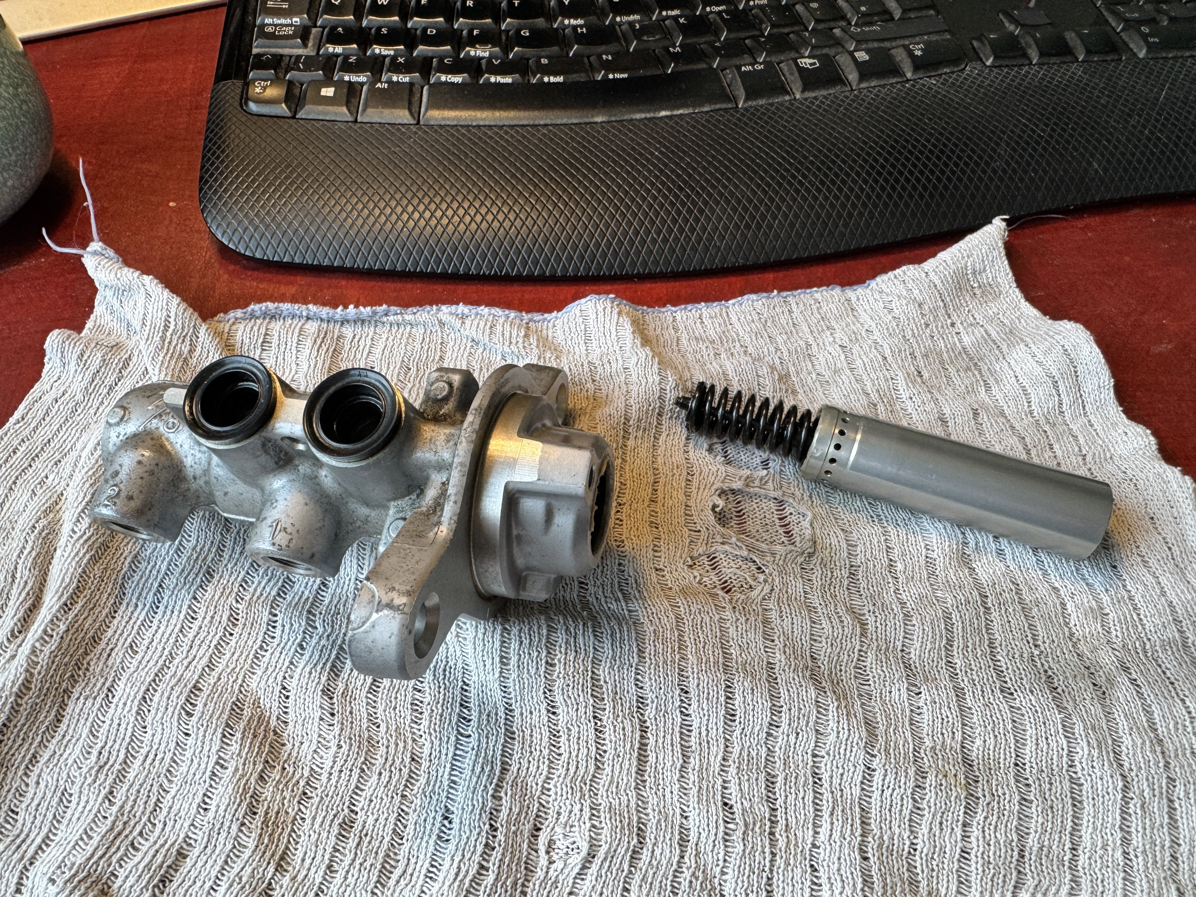

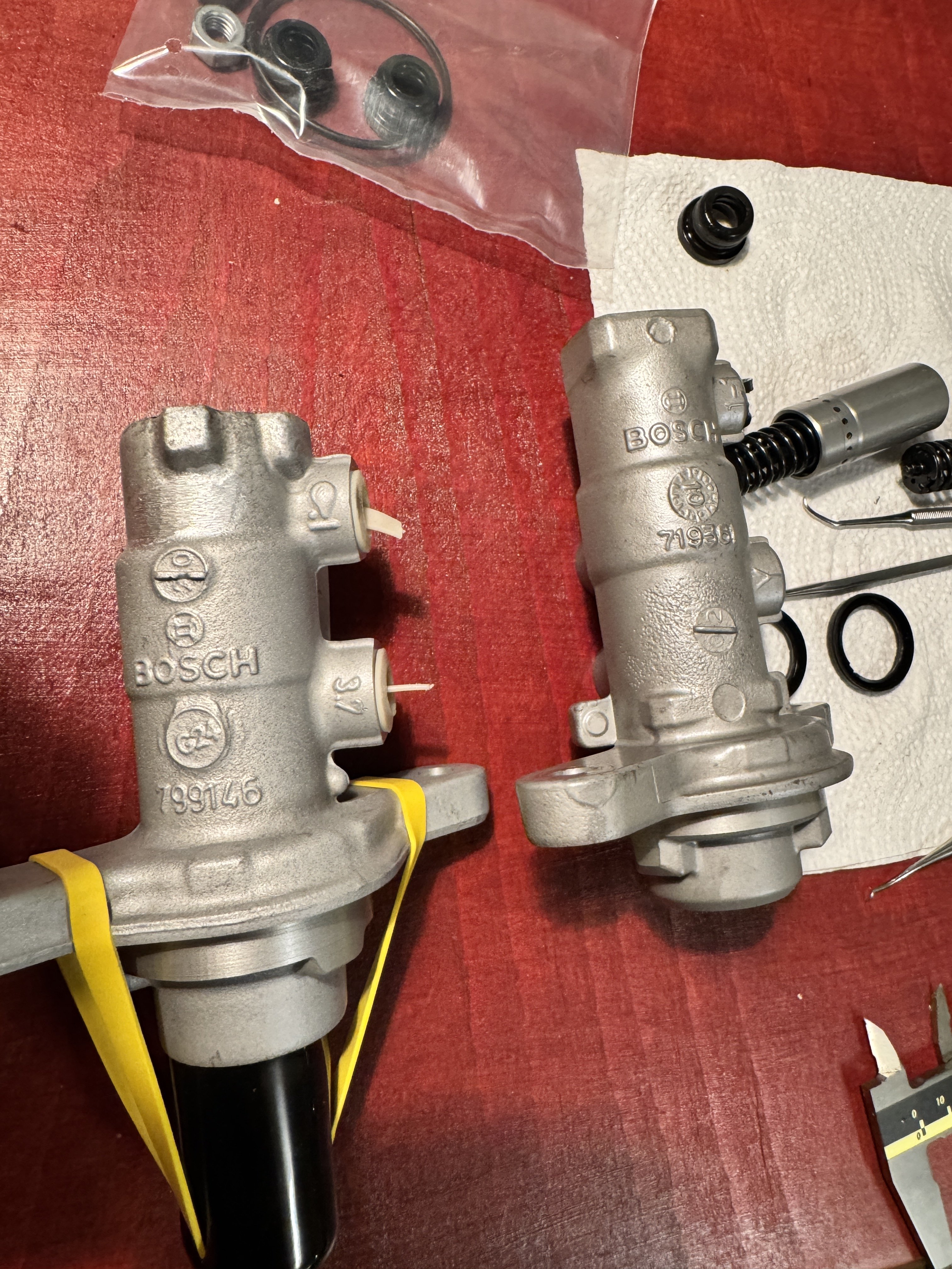

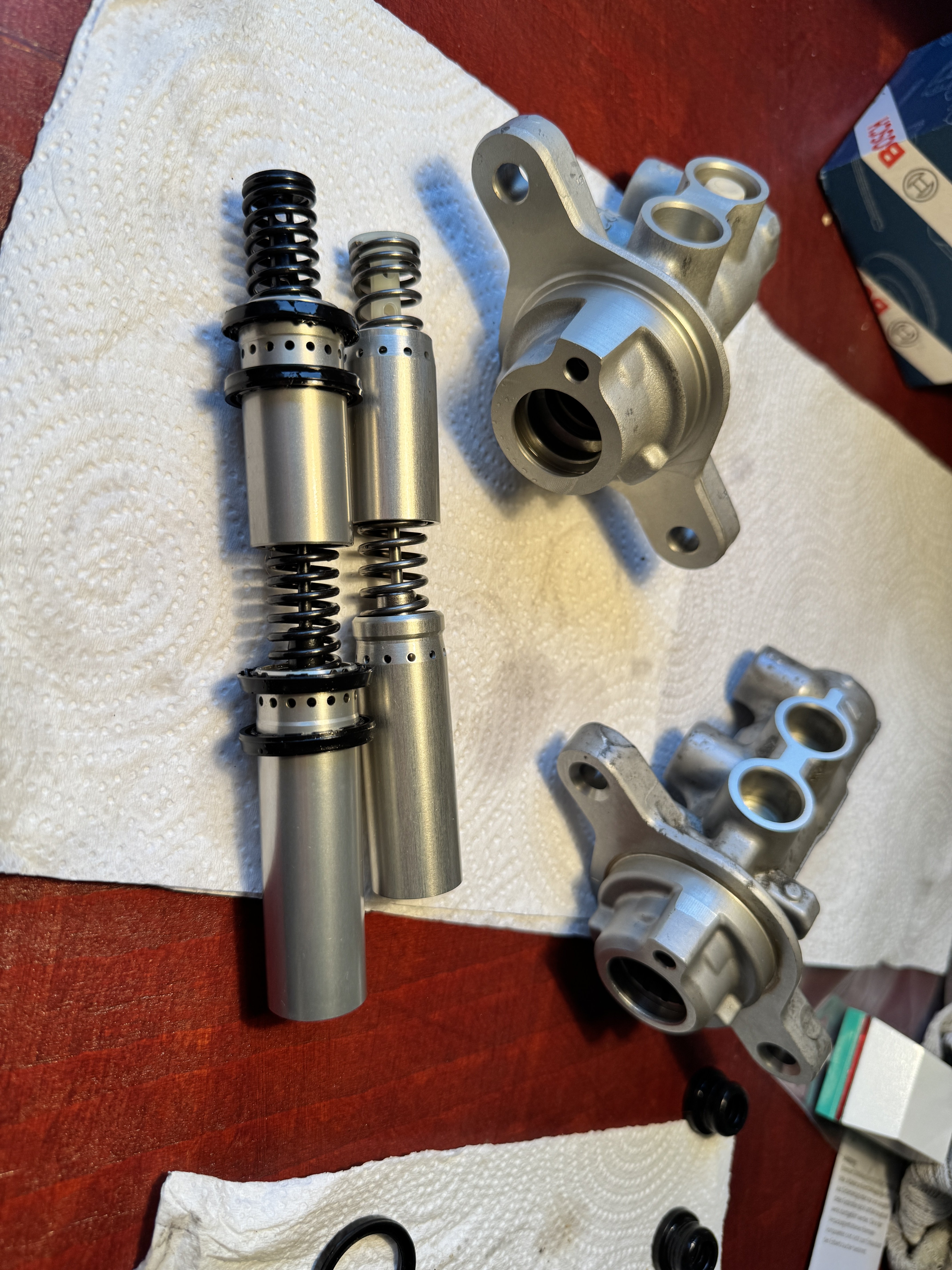

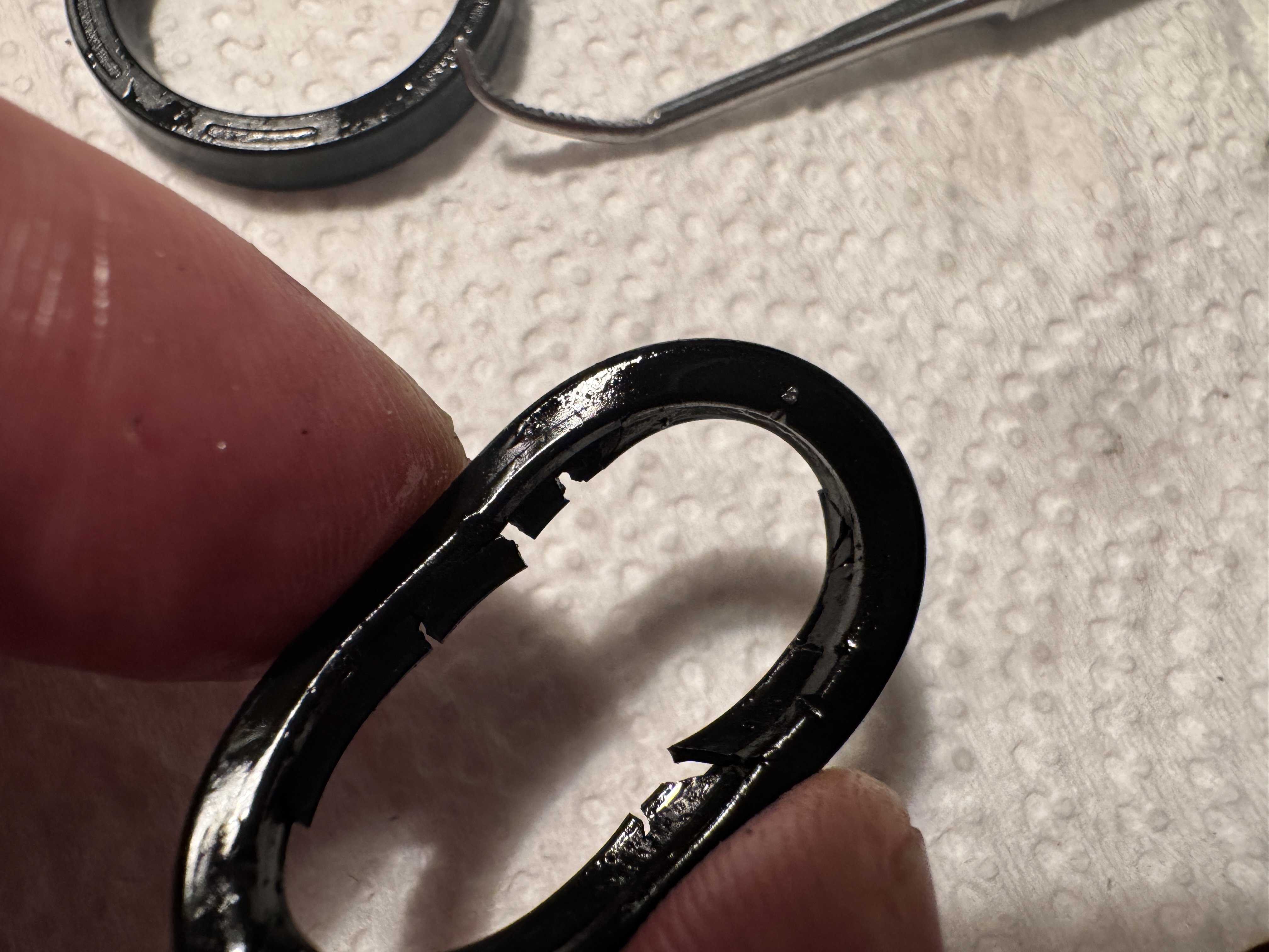

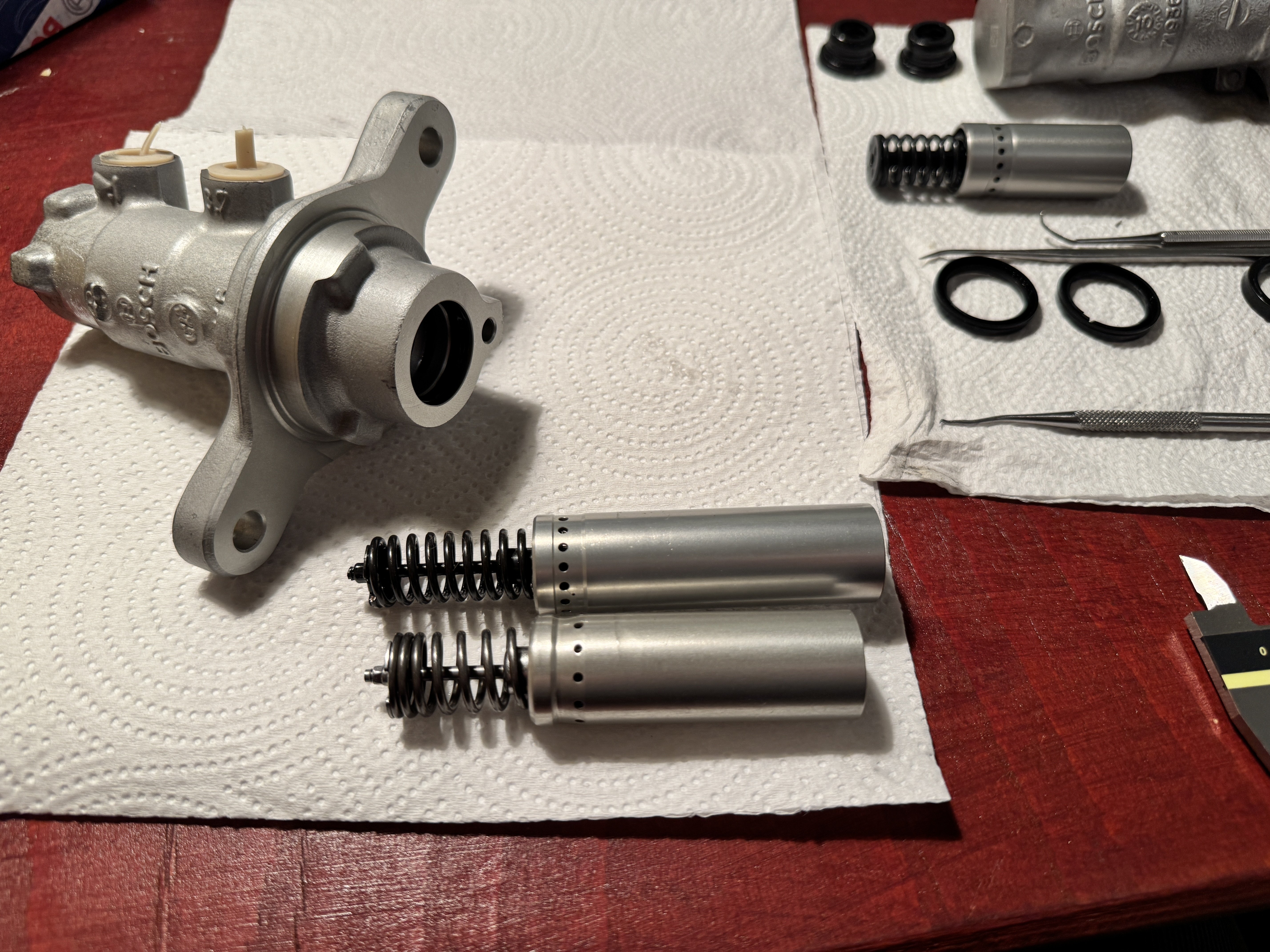

I got the master cylinder sorted today. I wanted the car on the road again for next week, that aliexpress part, and Toyota we’re all 6 week lead times. Toyota could easily get the part but wanted £400 + vat for it. So I thought I would see what was wrong with the old cylinder and took it apart. It’s a Bosch twin piston unit with the front axle piston in front of the rear piston. The springs on each of them are different rates which gives you the brake bias. The rear piston just pulls out, then the front piston popped out with the bike pump. There’s 4 seals in there, 2 for each piston, the top 3 came out easy ish with a seal pick. Then the bottom seal, which is the main seal for the front piston, was hard and super trucking to get out. The lip crumbled and split before the seal starts the pull out. Literally took me 2 hours with a pick to get it out.

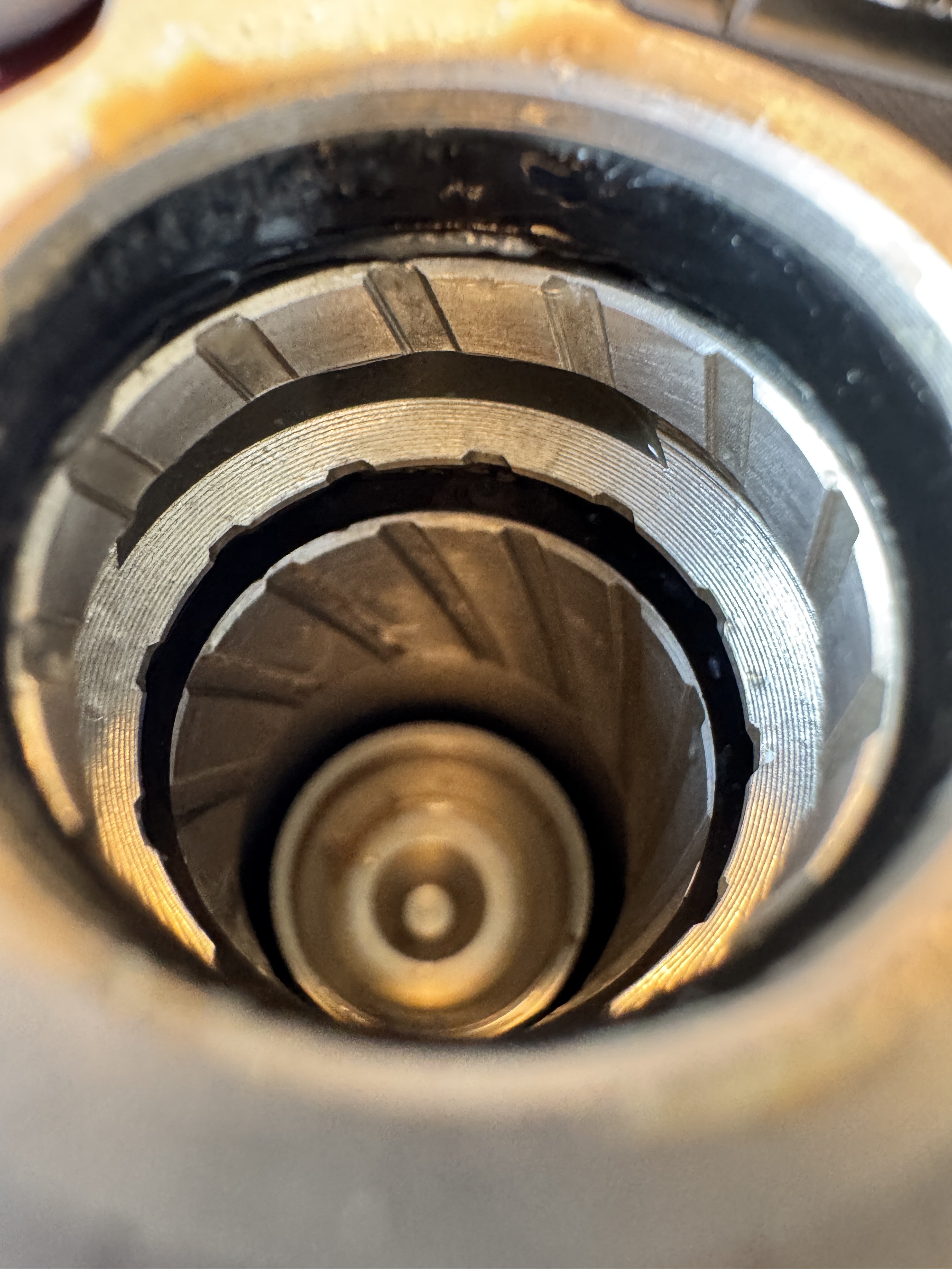

So the seals were hard. Which explains things at least. The seal pack is fairly complex. Theres 3 different seal types, all with various lips and edges, Bosch part numbers on. Tried looking for replacements but measuring off the old shrunk seals wasn’t giving me any confidence. Then I guessed that this style of master cylinder must be used in other cars. So I just started googling 22.2mm M12 port Bosch master cylinders. And found this one for a bmw mini. It was £50 delivered and looked identical, bar a tad shorter.
So the new bmw spec master cylinder arrived on Friday and I whipped the piston out to find the seals and the insides are exactly the same as my Alphard unit. The only difference between the units is the throw, the Alphard cylinder has. 49mm throw, and this bmw one is only 40mm throw. These new seals came out way easier than the old ones, much more “rubbery”. The bottom one I struggled on before popped straight out! Interestingly, the seal designs are different. They are way tighter on the pistons too, proving measuring off the old ones wasn’t going to work.
Slapped the original cylinder with the new seals in this morning, did a vacuum bleed on it and managed to get it filled without air going in the lines. Had a solid pedal until I turned it on and the ABS module opened, now the pedal is a bit spongy again, so I think the rest of the lines need bleeding through with the new fluid. But the test drive was good, way better pedal feel, does not drop away, plenty of stopping power. Still got lots of pedal travel but I do think it’s a bit of a feature. The boosted on this thing is huge. It must be 400mm in diameter. The pedal travel is pretty normal with then engine not running. Then the booster sucks the pedal down loads. So I’m thinking this is old fluid in the lines to the wheels. It should be milky where it’s broken down in this case, so we’ll see what we see.
Wow that sounds like a complex job you seemed to know what your doing pity you weren’t able to pick up a new unit overseas as Toyota in the Uk and Oz are ridiculous in there  pricing of parts sometimes if you can’t find generic parts it’s cheaper to buy from Japan even with the freight cost.
There were a few options to order a new one from, but this time i was lead time limited. And now we know how the master cylinder is put together!
It is a bit complex, theres no information out there on rebuilding them, everyone just tells you to buy a new one. But it’s only 4 seals out of a seal catalog, that someone had to select and stuff them in with their finger too.

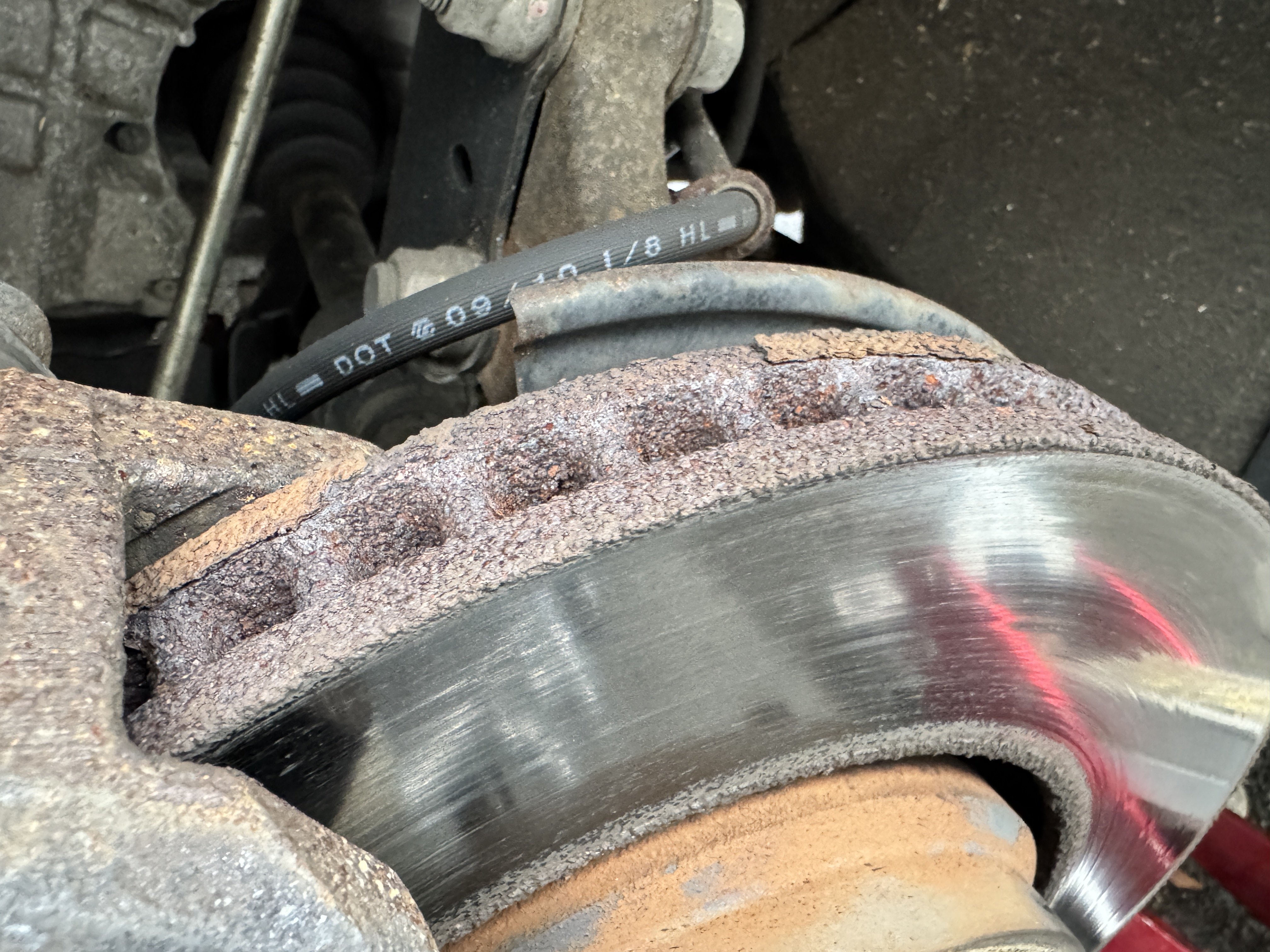

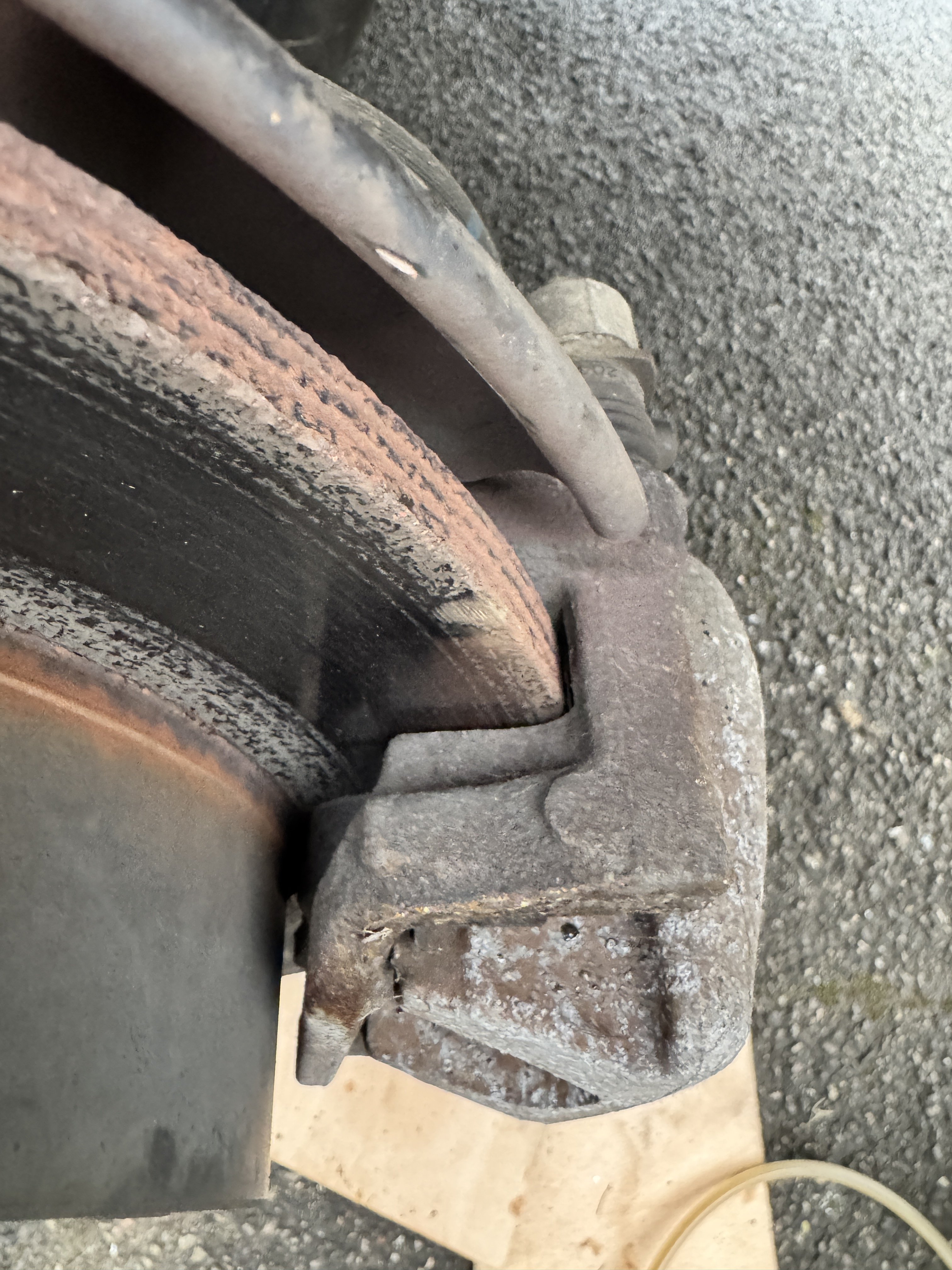

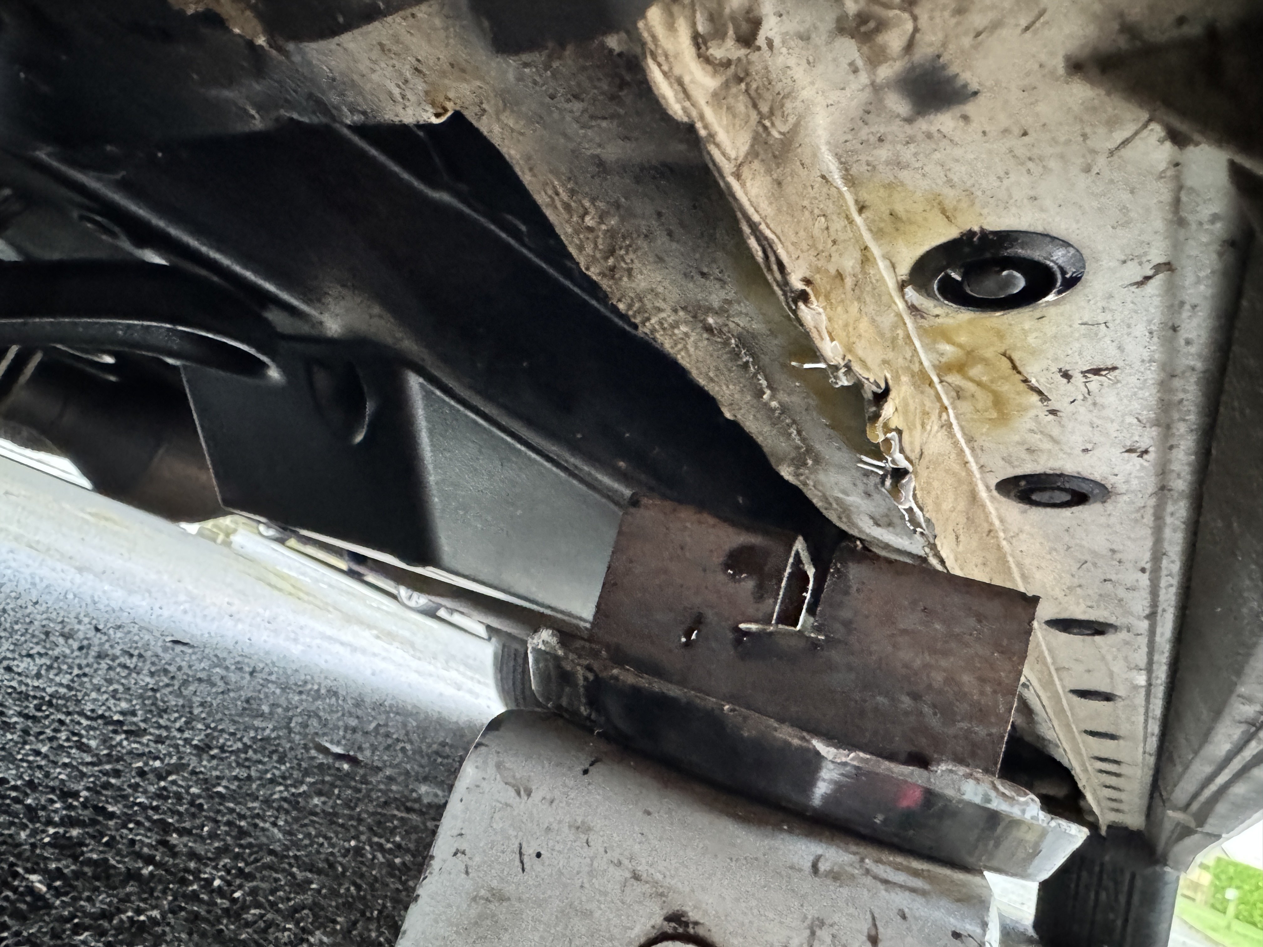

Spent the morning going round each corner, wheels off, checked the brakes over, ground the crust off the outside of the discs, and spraying lanogard in all the crevices. The rear discs are really tight to the calliper bracket, the left rear was chonking a bit spinning the wheel by hand.

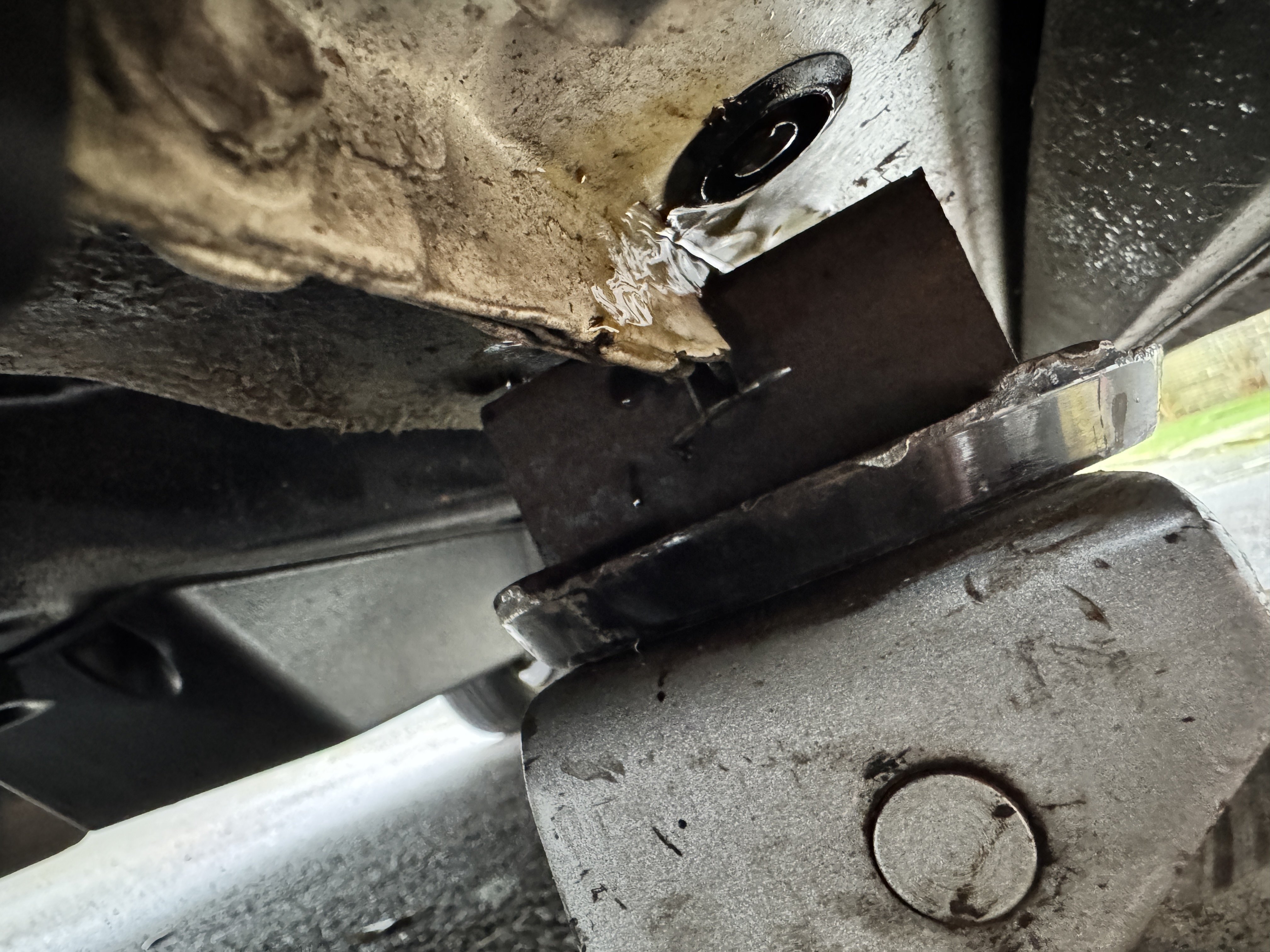

Searching for jacking points on this forum, quite a few people mentioning damaged sill seams. As these cars just use the sill to lift from, other cars like Mercedes have big buttons that fit in the cup of the jack so the sill doesn’t get damage. My sills were damaged, I assume recently as there was bare metal showing were paint had come off. I straightened them up with mole grips and sprayed them in lanogard. To lift the thing, I used a piece of box section with a slot cut init to stop the seam collapsing.

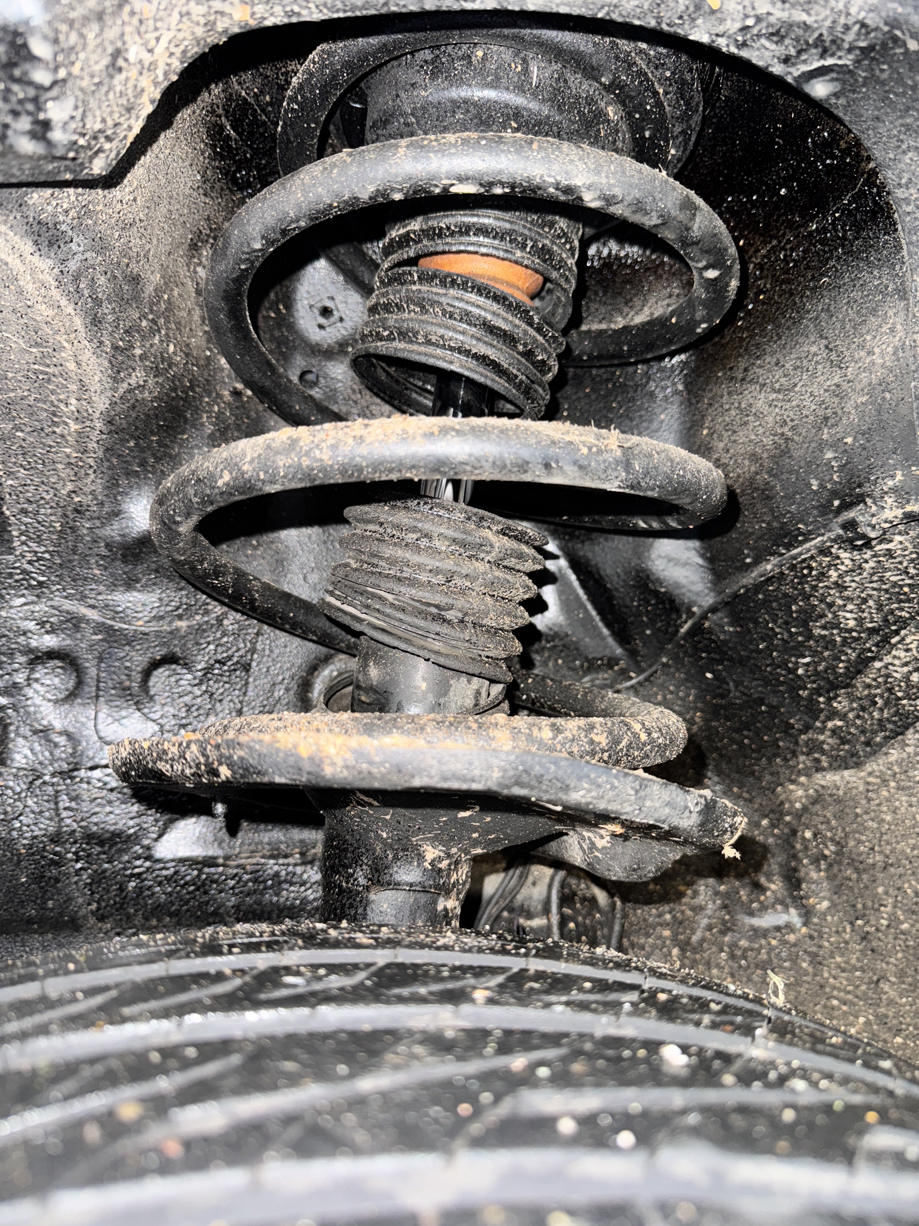

Then onto the front trying to track down my slight judder under braking. I’ve assumed this was top mounts, but it’s quite difficult to tell. There is a fair amount of “compliance” in the wishbone bushes, the rear horizontal ones move around quite a bit with a pry bar. And, both strut gaters are hanging off. So I think the best thing to do is collect all the bits and replace the lot in one go. Theres nothing loose or damaged so I don’t see any risk in driving it for a few months till that happens.

I don't like using the sill area as a jacking point and I found that putting a jack with a wood block under the sub-frame would lift the vehicle (a Citroen at the time) a treat - just being careful of pipes and not a part like the suspension arm that would move.
