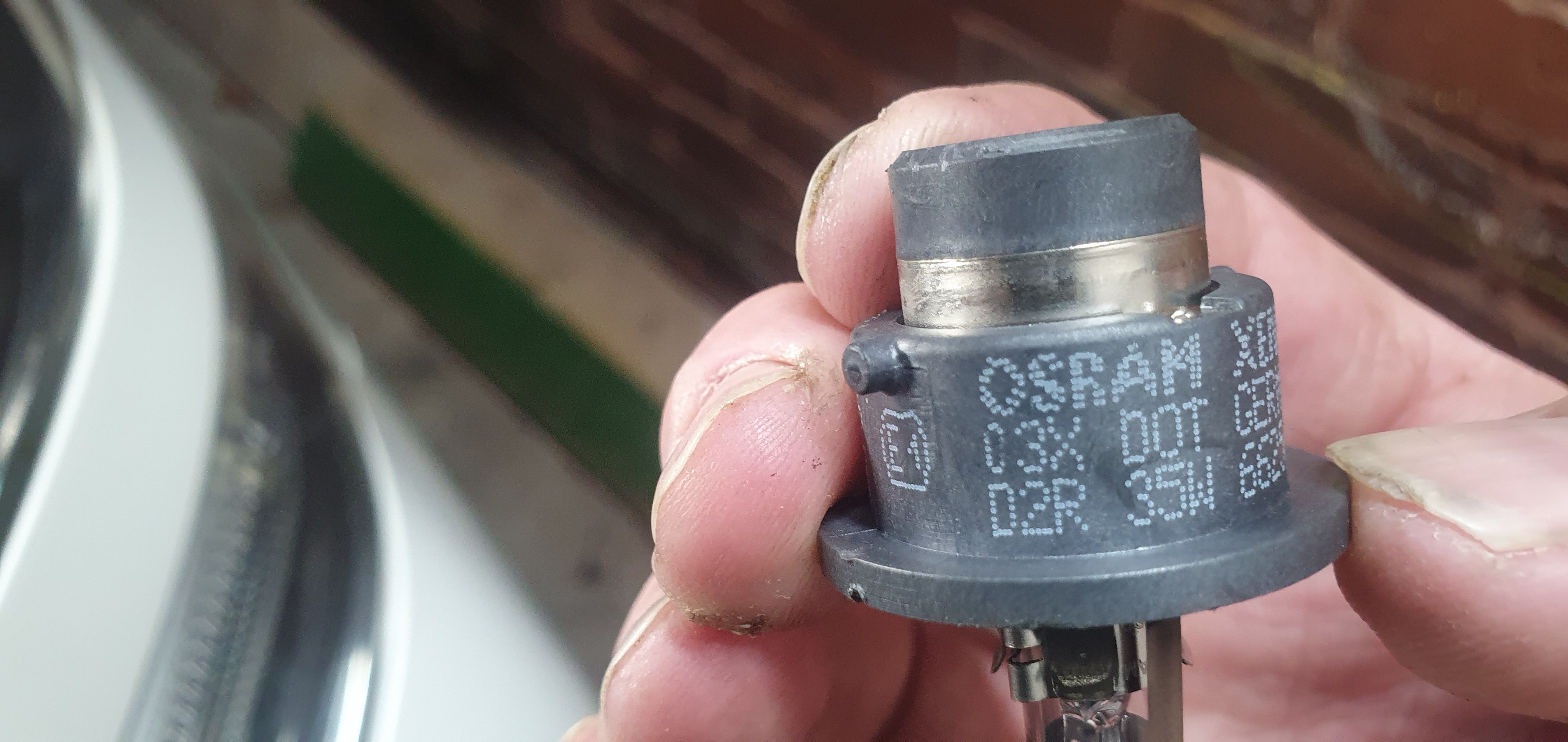

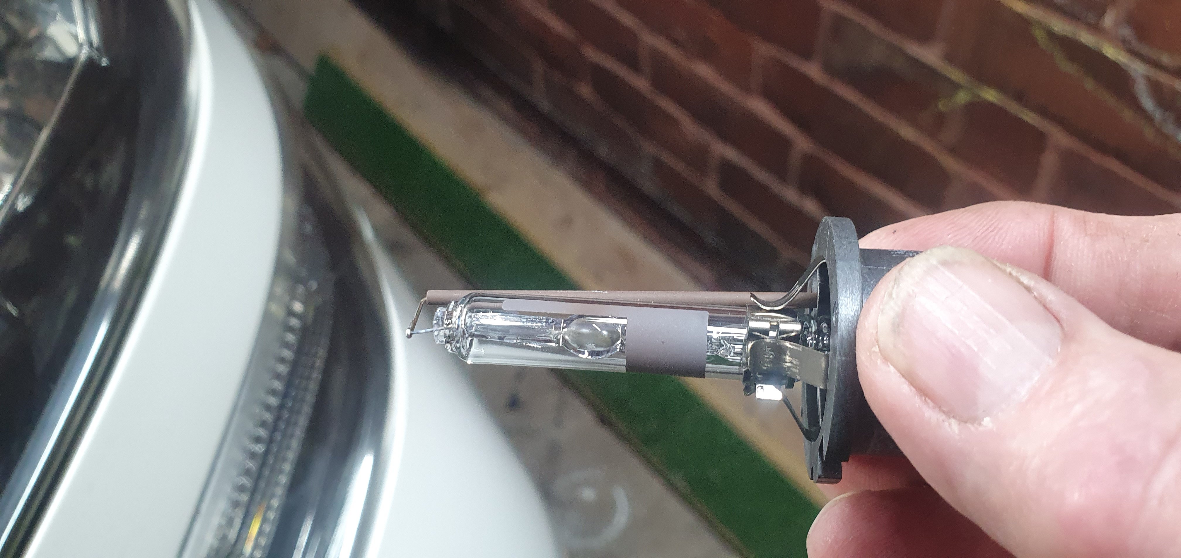

My low beam HID is a D2R, took it out last night as I too want to improve it. I'm hoping the bulb has aged and that's the trouble. 20241208_150903.thumb.jpg.c472814404a52d04a7396f4ac41eade7.jpg20241208_150903.thumb.jpg.c472814404a52d04a7396f4ac41eade7.jpg
If you have HID projector then that's the wrong bulb. "R" means it's for reflector. All projector headlights should use "S" bulb.
Hi @opelrsx
Ooh looks like one of the previous owners have fitted the wrong bulbs then!
Could explain why they aren't as good as I expected too I guess!
Thank you for that info, I'll go and see my local guys for a new pair!

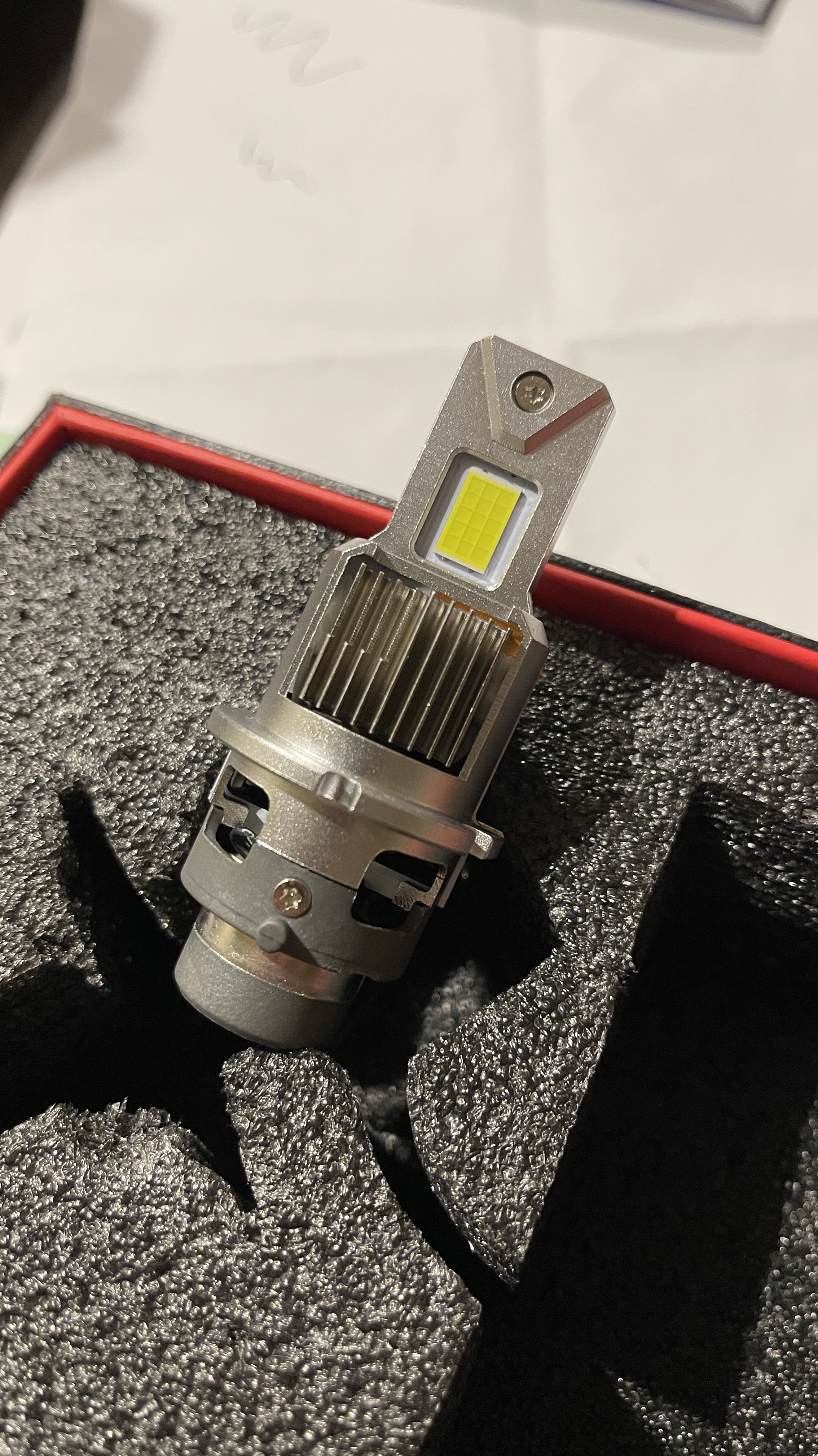

Thank you to all. I have been looking on Amazon but not too sure of the quality
Arrived, looks not bad... let's see how it works shortly 😃
Put them on, telling from my eyes, probably 10%-20% brighter than stock HID. No complaint though, still using stock ballast and projector, so cannot expect huge improvement.
