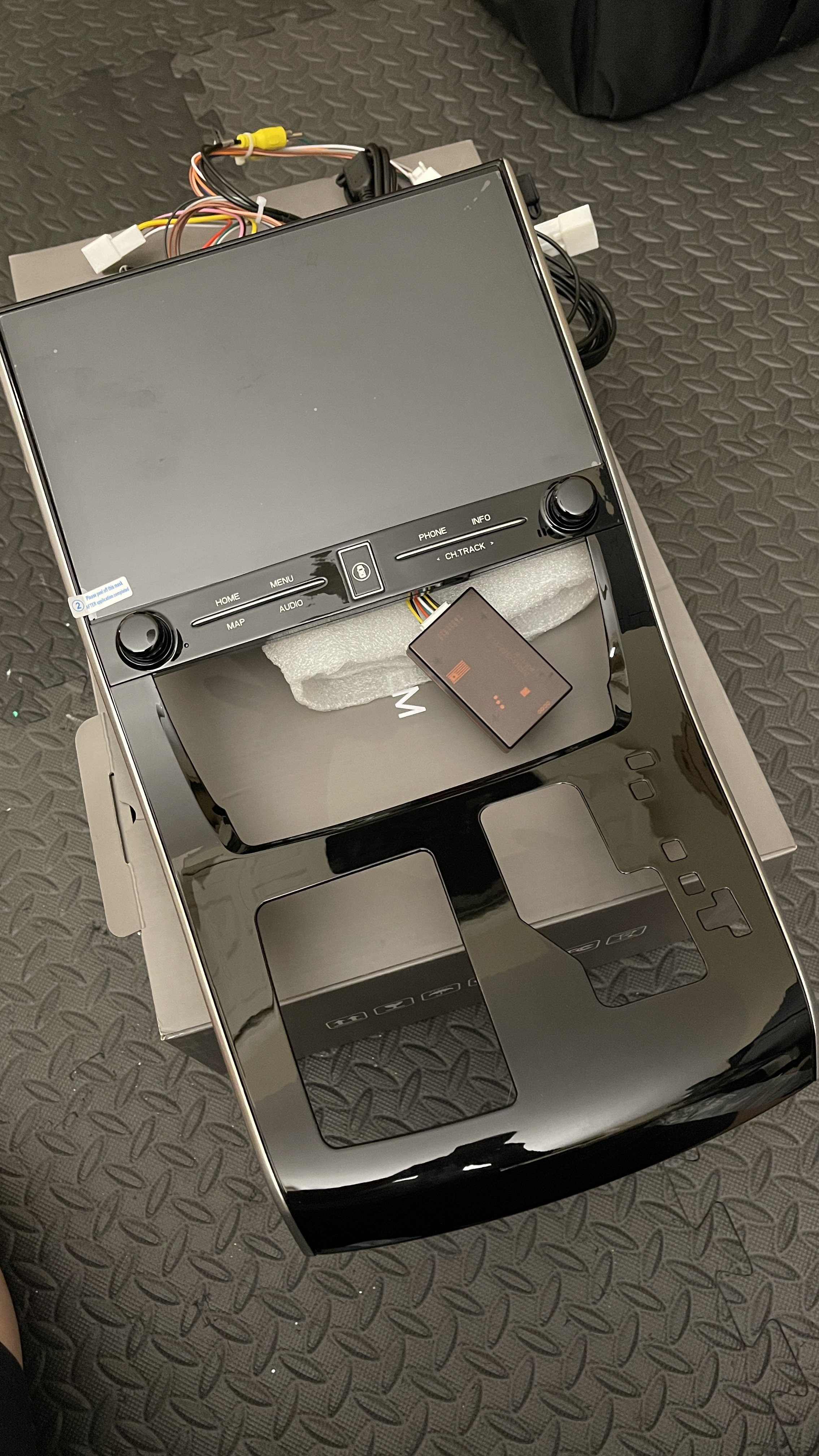

Get this one from aliexpress, comes with everything you will need. Works beautiful...

If you are talking about the unit I posted, yes, 18 speakers works so and factory amp. Steering control works. For 08/09 model year with 270 camera, only reverse camera works. For 10+ model year that has 360 camera, all camera works. However, picture quality isn't very good with factory cameras, managable but not near HD quality. In terms of installation, plug and play. I've had it installed for about half a year, very happy with it.
Thanks, where did you get it, and what's it called please?
You can get it on Aliexpress, serach series 20 alphard andriod headunit, plenty avaiable.
That's absolutely brilliant mate! Thank you!!
I only have the rear camera, 2010 model, I'm a poor relation on that one!
I'll have a look tonight for that!
By any wondrous chance can you remember the manufacturer? You've not still got the box have you??😃
No manufacturer info, I believe they (the model I posted) are all made by one company, just different retailers.
