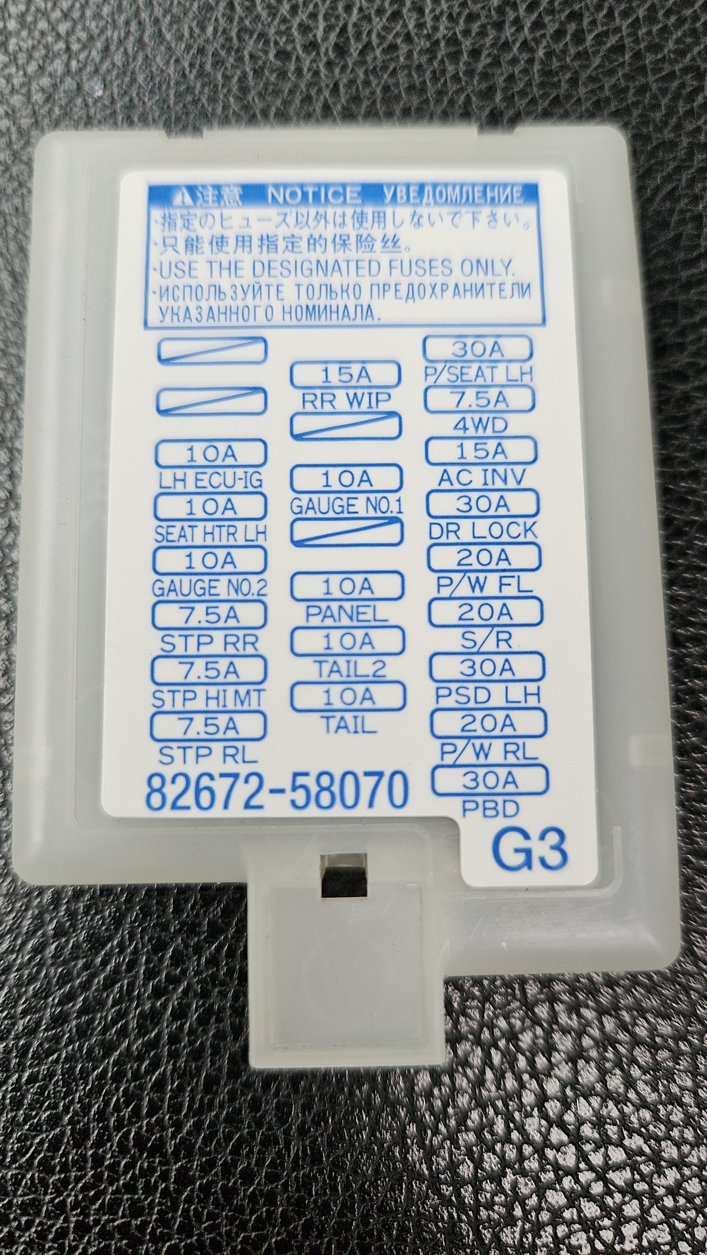

Found it but doesn't look like any of these? Unless anyone knows otherwise?
My fuse box that holds the radio fuse is in the passenger foot-well, but the layout is different from yours though.
