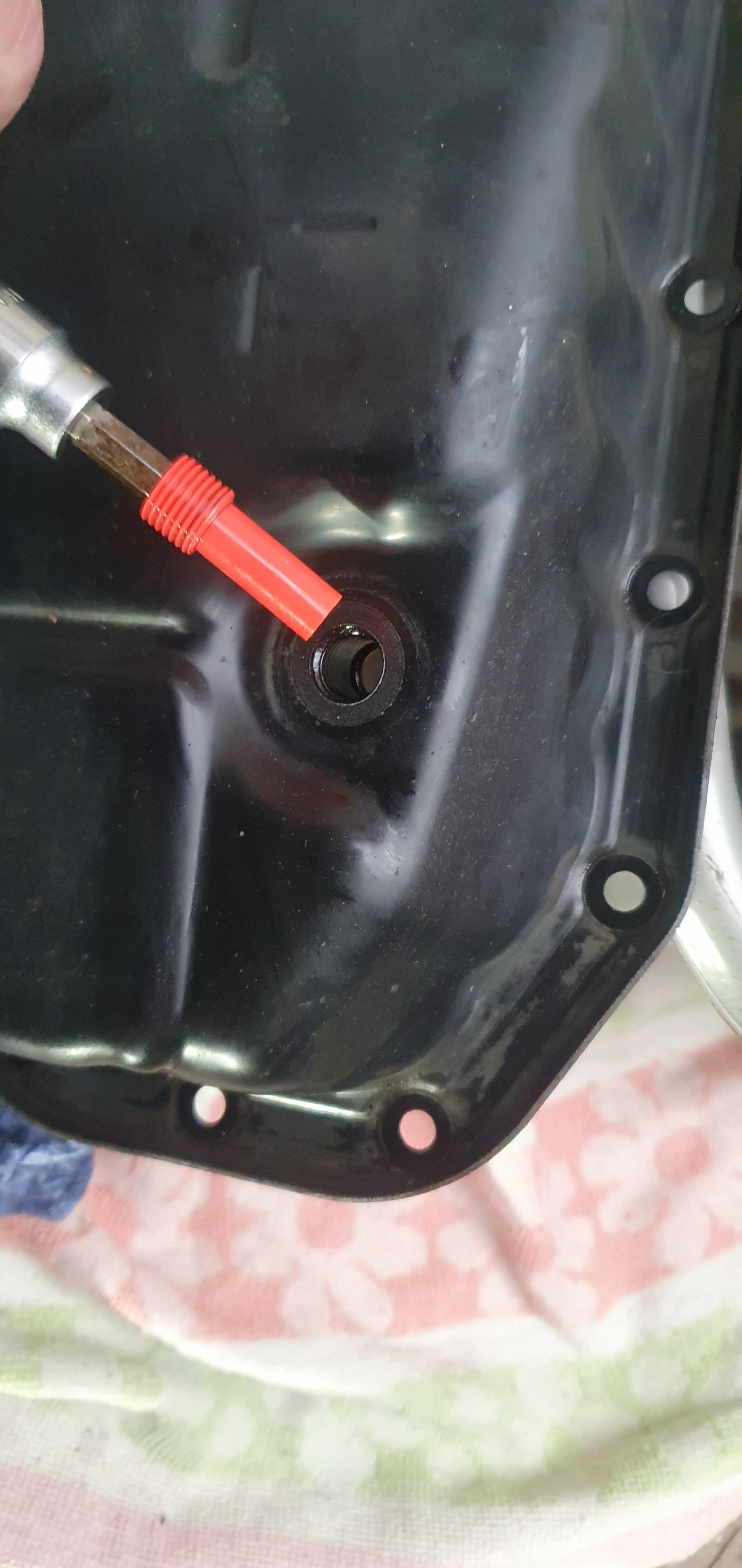

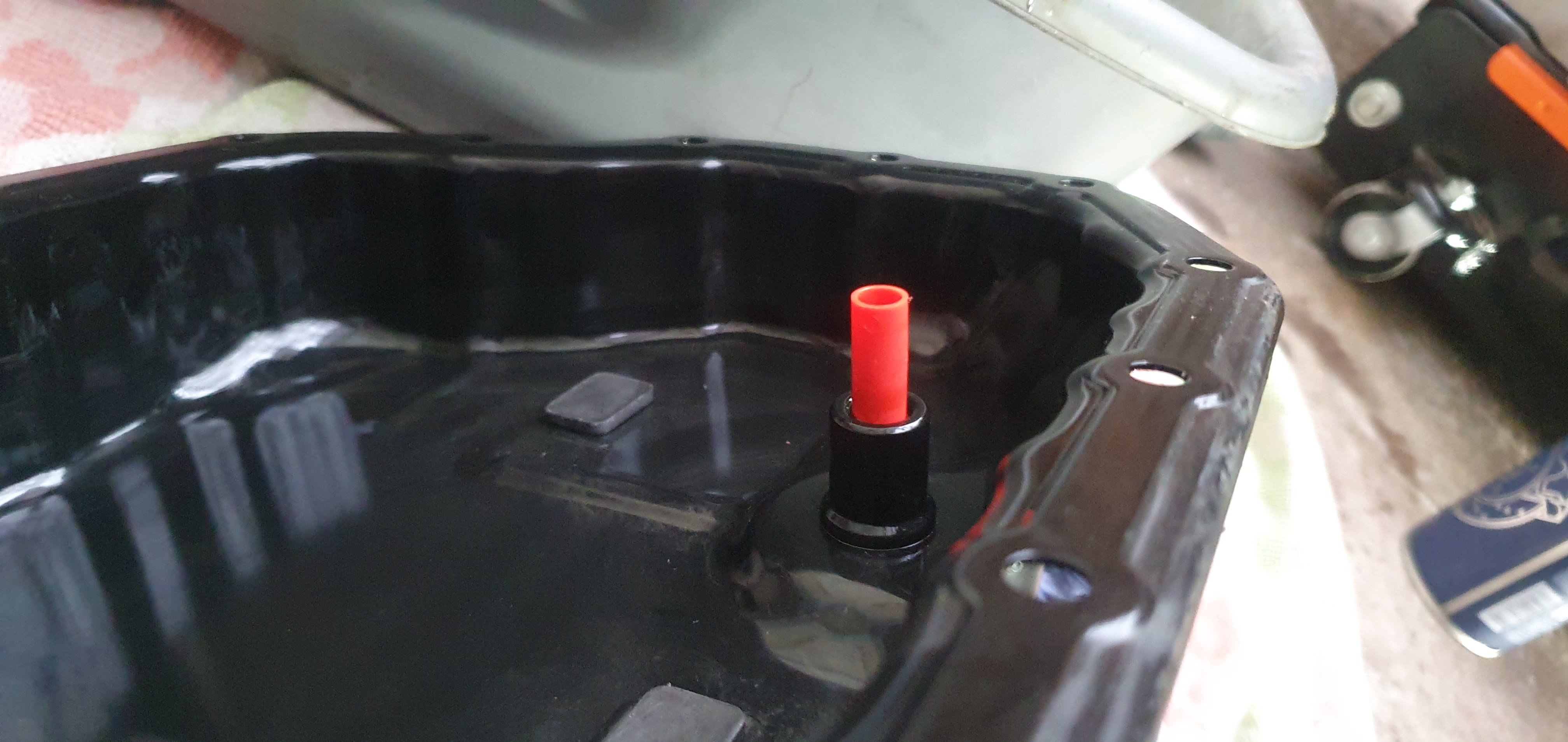

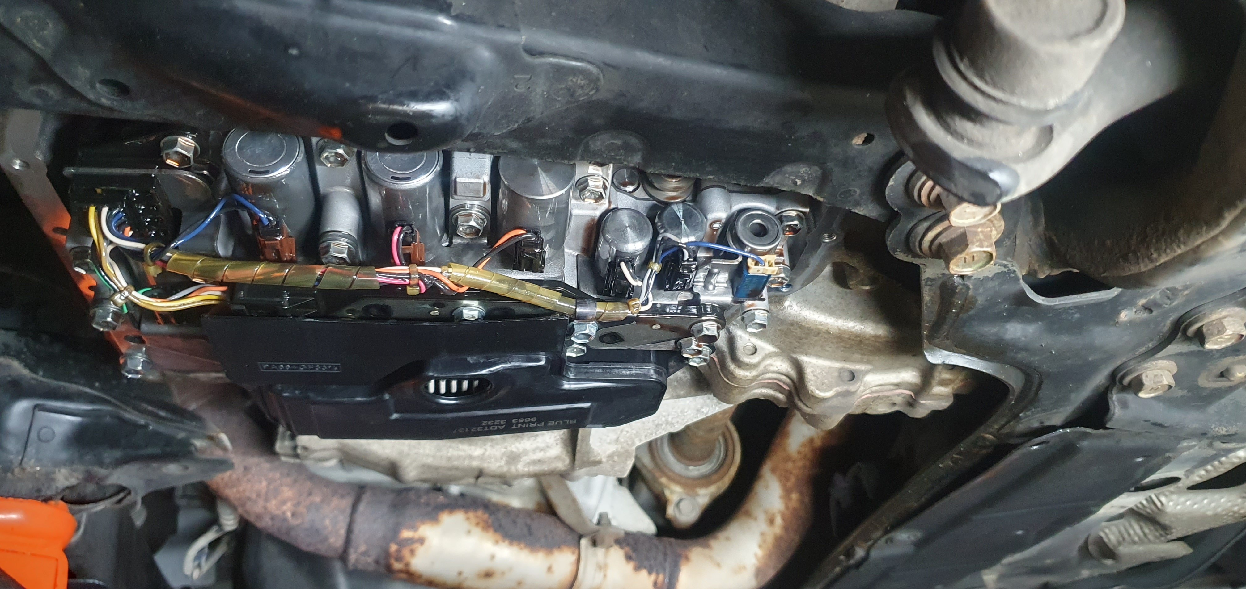

I did the filter as well, if you take the sump off be aware there is still about a litre and a half of fluid, have a bowl under there!
Edited by BigNev
Sorry, it's only about a litre, still plenty to get messy!
