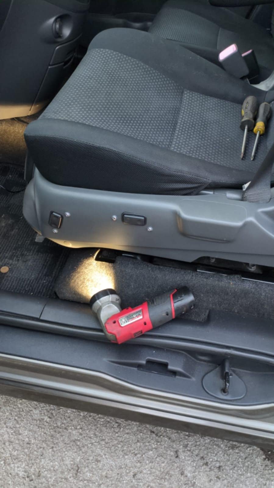

hi can anyone advise me last time i was one here i was very grateful for people helping me although my car is a toyota isis  but it has the same seat welcab like on the alphard can anyone at all help or point me in the right direction please.
 i need  advise me on the re set procedure for the Toyota isis welcab electric chair  i have followed some reset procedure online but not had any joy mine is a 2 button seat and this is the first i have come across with this seat function and hoping you can either advise or recommend someone to ask about this,i tried this below
 1 press up and down forward 15sec
 2 press up 4 times
 3 forward 4 times
 4 move seat back and forth
 I tried a few times it makes all the right bleeps but nothing rotates or the seat doesn't come out it just goes back and forth and thats it  although the video i saw was on a  toyota sienta with 3 buttons and mine is a isis model with only 2 one for forward and back and the other for up and down or in and out i guess pls advise.
Never seen one of these and don't know what I am talking about but here goes ...
  I note that there is a bulge to the right of the two buttons - does the bottom of that move at all?
  Next, are there any buttons on the other side that get exposed when the seat is moved forwards?
  next, are there any buttons or levers on the front that would swivel the seats?
  also .. are there any buttons on the dashboard that might operate the welcab?
Good luck.
hi sorry for late reply  i tinkered with it a little so what's happening now is the central locking don't work its kind of random but when it does that's when the seat can function as normal kind of weird i know also no other buttons mate just those and lever on same side too it totally random when i press inside lock button to lock and unlock all doors it sometimes works and when it does thats when i know the seat will work let me know your thoughts.
Maybe it is just some safety lockout.
Parking brake on, Gear in park. Central locking unlocked.
Does the courtesy light work when the passenger door is opened?
Maybe it will not activate the swivel if it does not detect the door as open.
Check any switches around door and the frame that may be jammed.
