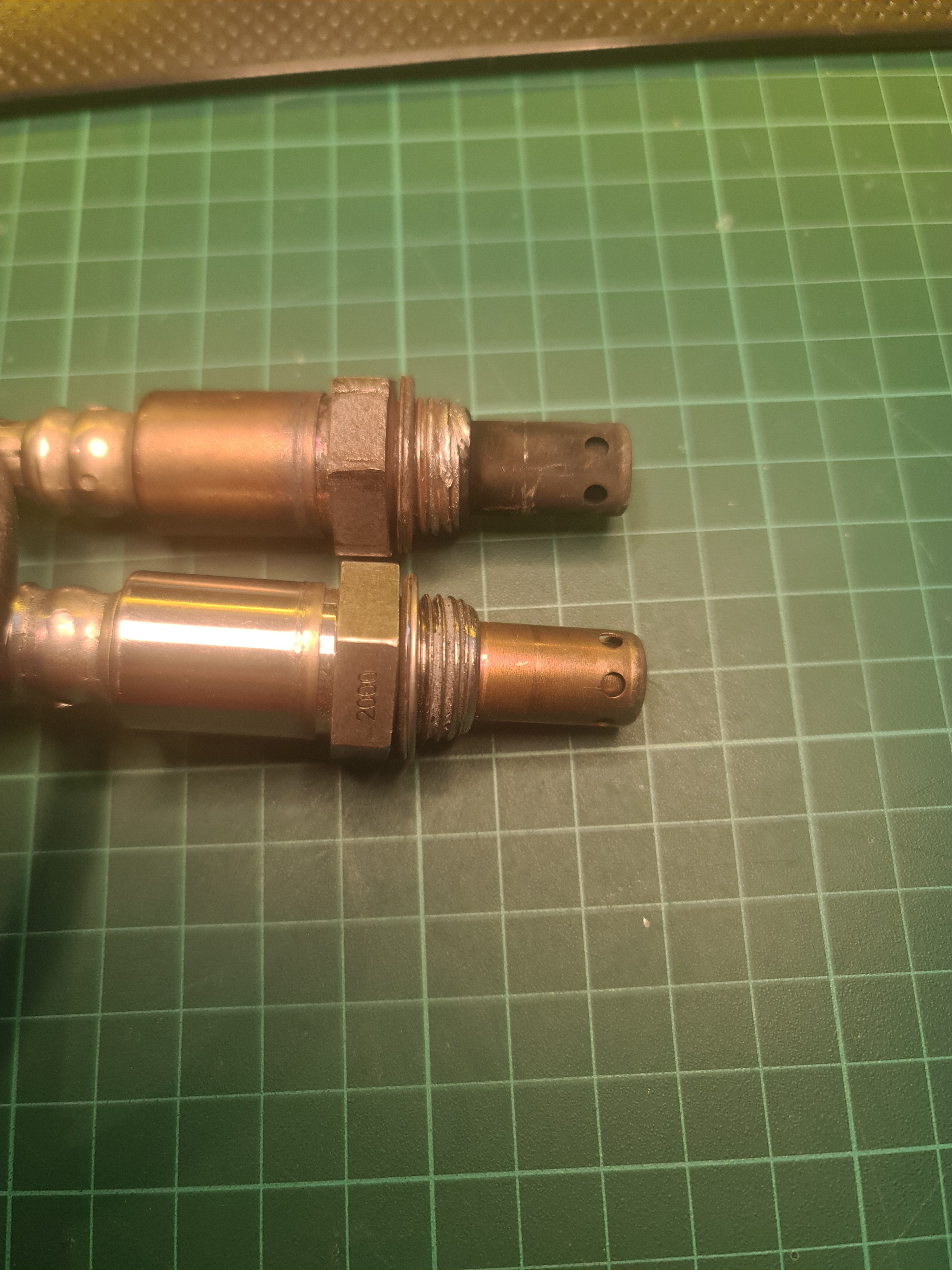

After struggling to get my front lambda sensor out it came out with less than a full turn all told.
It's difficult to see but the thread on the old one is essentially stripped and the new sensor can't get started on the thread in the exhaust manifold.
I am thinking of getting a tap to cut out a decent thread but I'm not sure what size to go for - though my micrometer says 18mm on the outside (which got me to thinking that maybe it's the same size as a spark plug) so i have ordered M14, M16 and M18 intermediate taps and see which fits.
Does anyone know what tap size I would need to cut the correct thread?

For anyone who is interested / in need I have found that for my 5/2005 2.4lts Alphards front Lambda sensor a M18 x1.5 tap is what you want. I cleared the exhaust hole, while the same die (M18 x1.5) cleaned up the threads on the Lambda sensor - all went together though I only tightened it up a bit as I didn't want to strip it 🙂

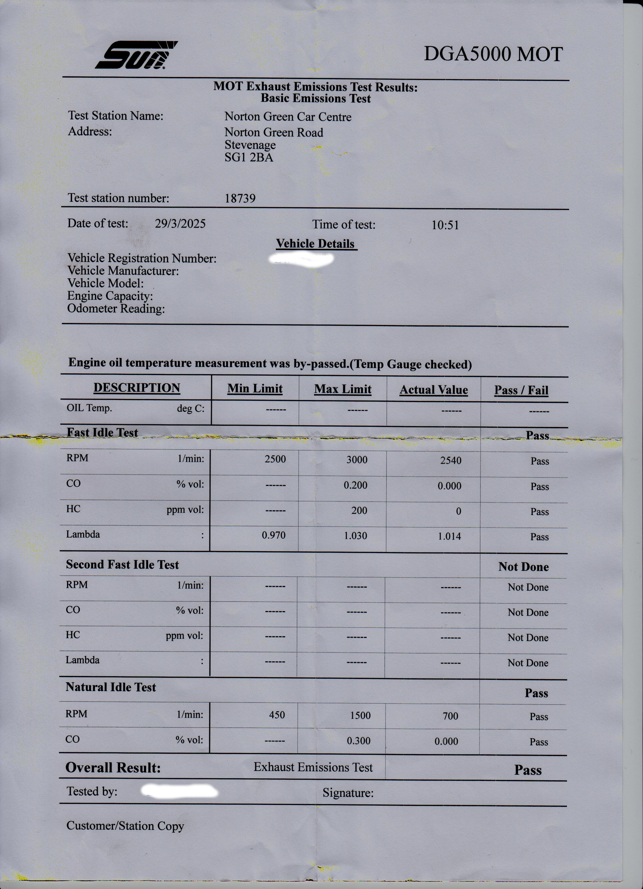

Yey - the emissions test passed!

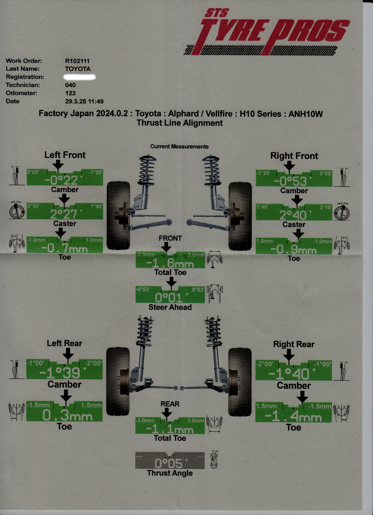

The tyre people did an alignment check and found everything was within spec, though both the offsides were right at the limit of the manufacturers spec.
I am rather pleased that the emissions look to be so clear cut - I don't know what the 'before' figures were but a CO and HC of 0 must be good. I'm not sure what Lambda is measuring but that is within spec also.
