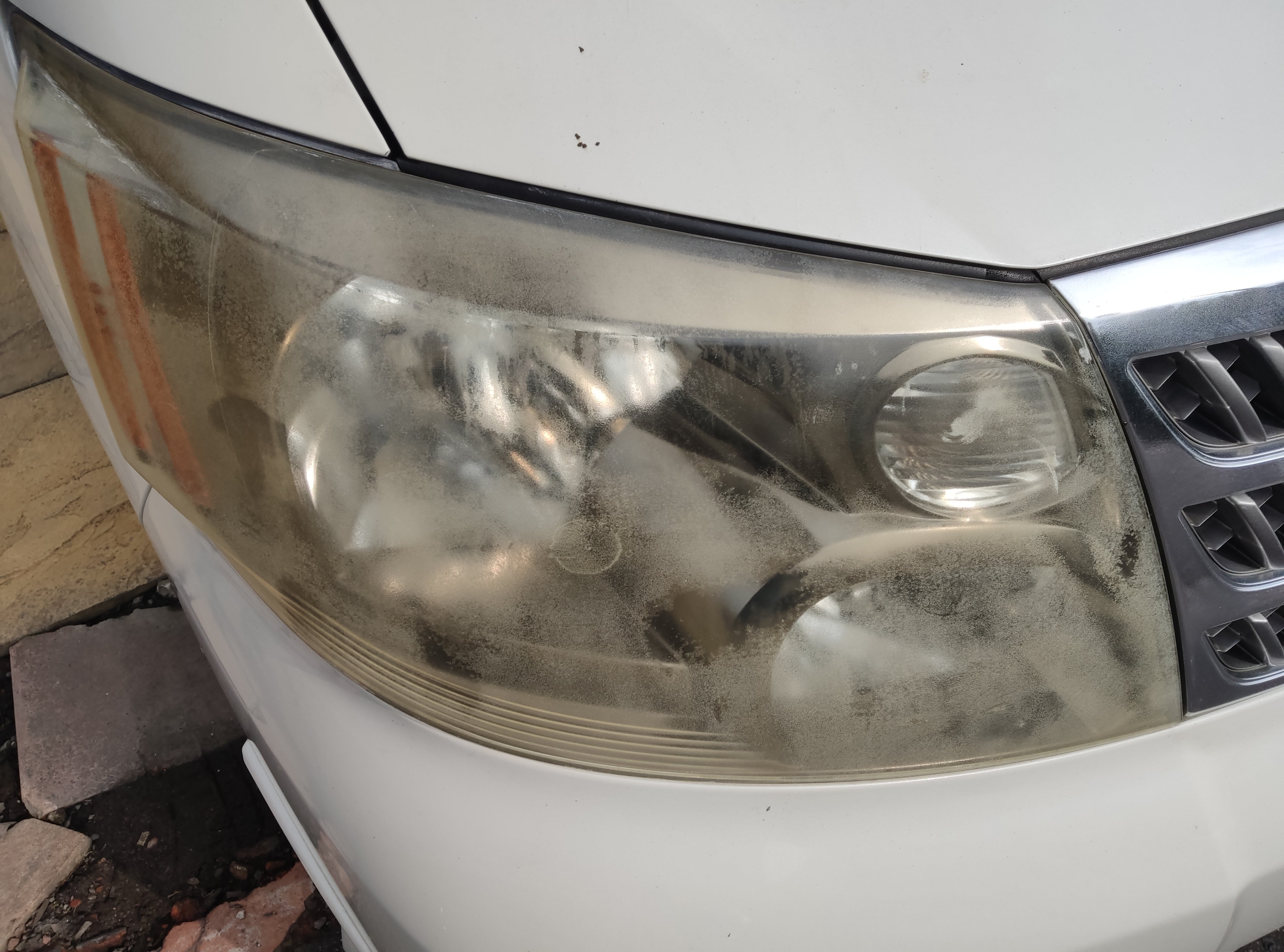

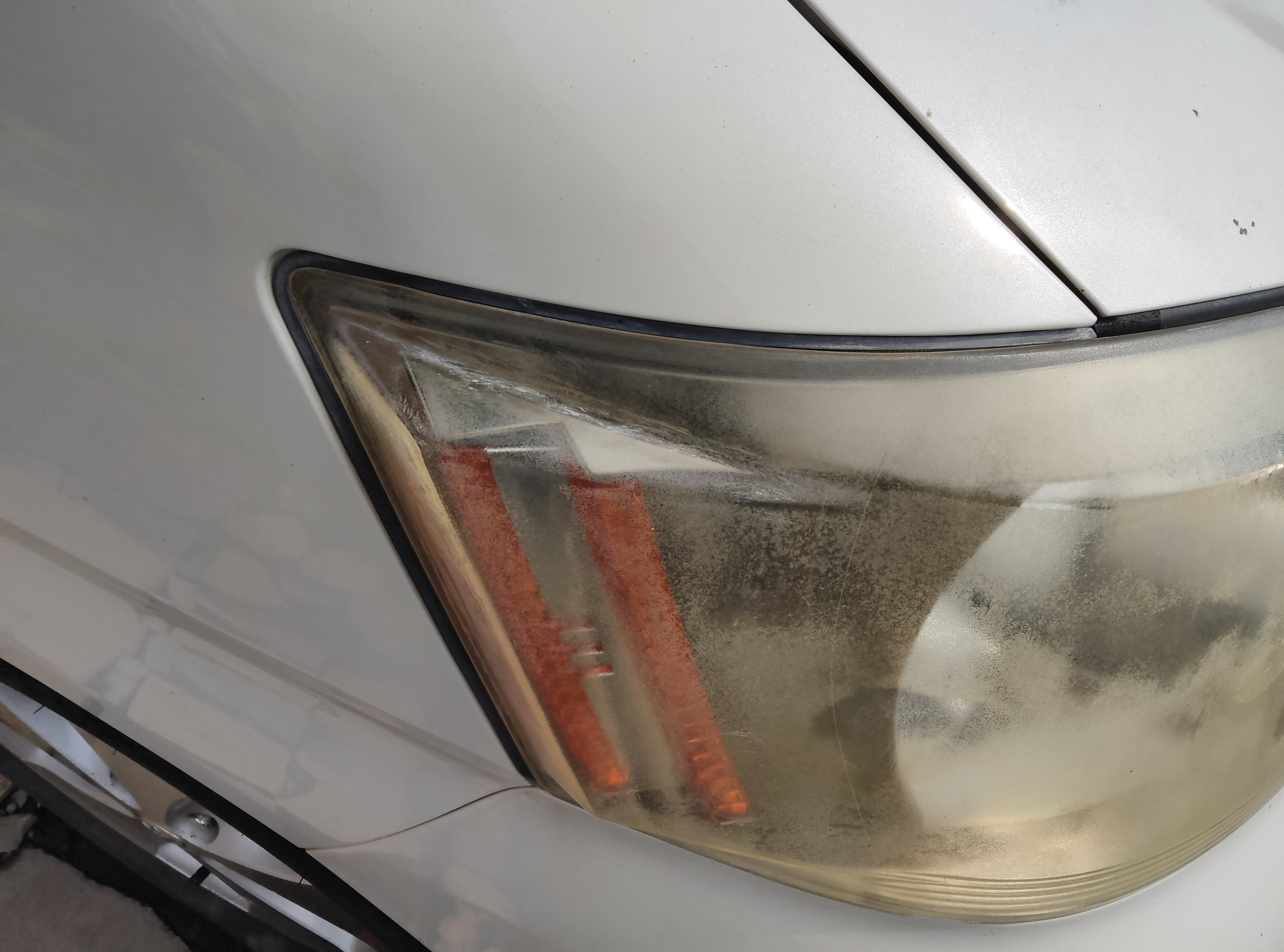

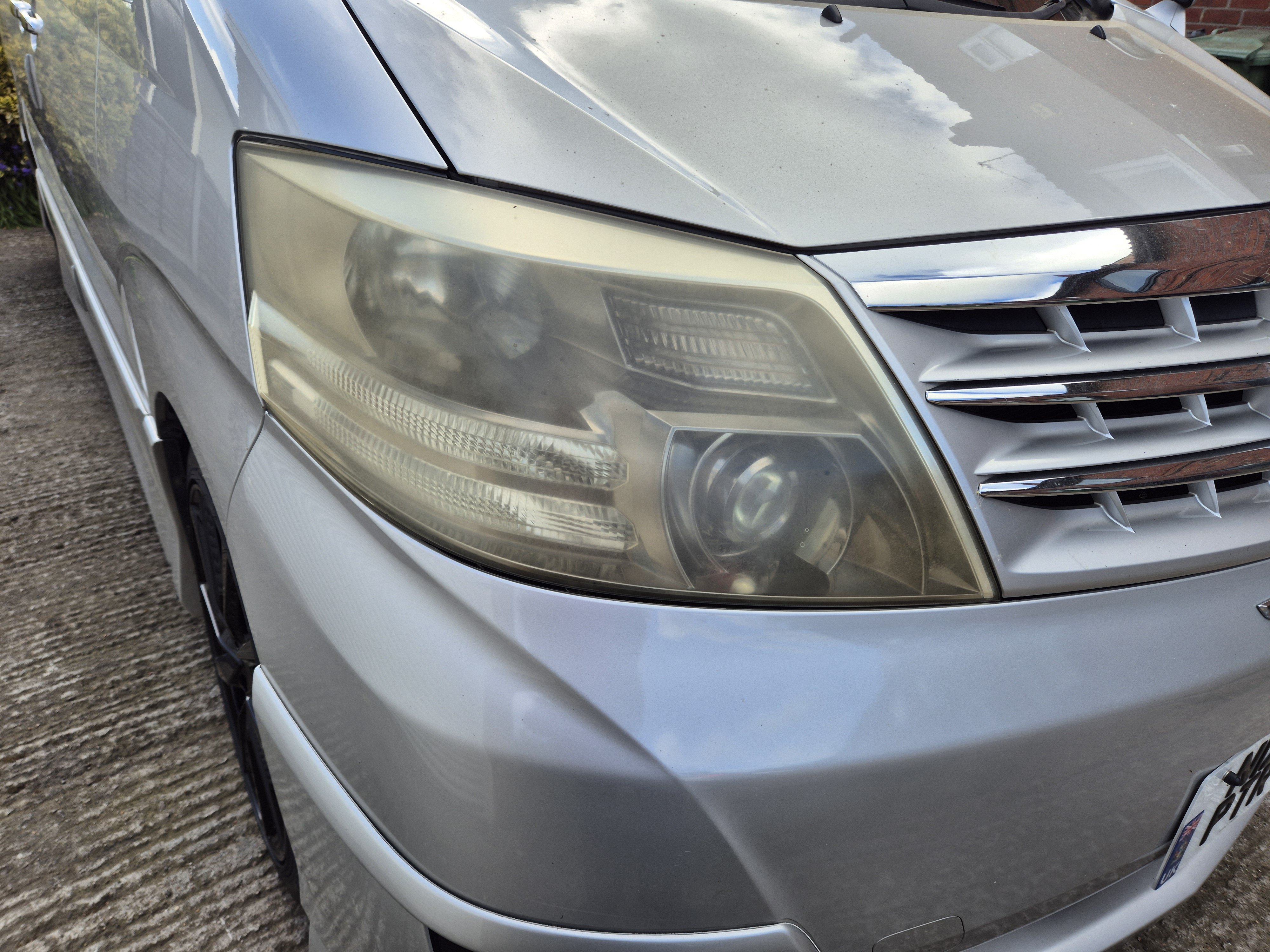

Hi All,
So my headlight lenses are shot, i spent an hour trying to sand down again but they still look the same.
Anyone replaced their lenses at sll. Ive seen on aliexpress people selling replacement lenses but wonder if they are any good.
Whats your thoughts?

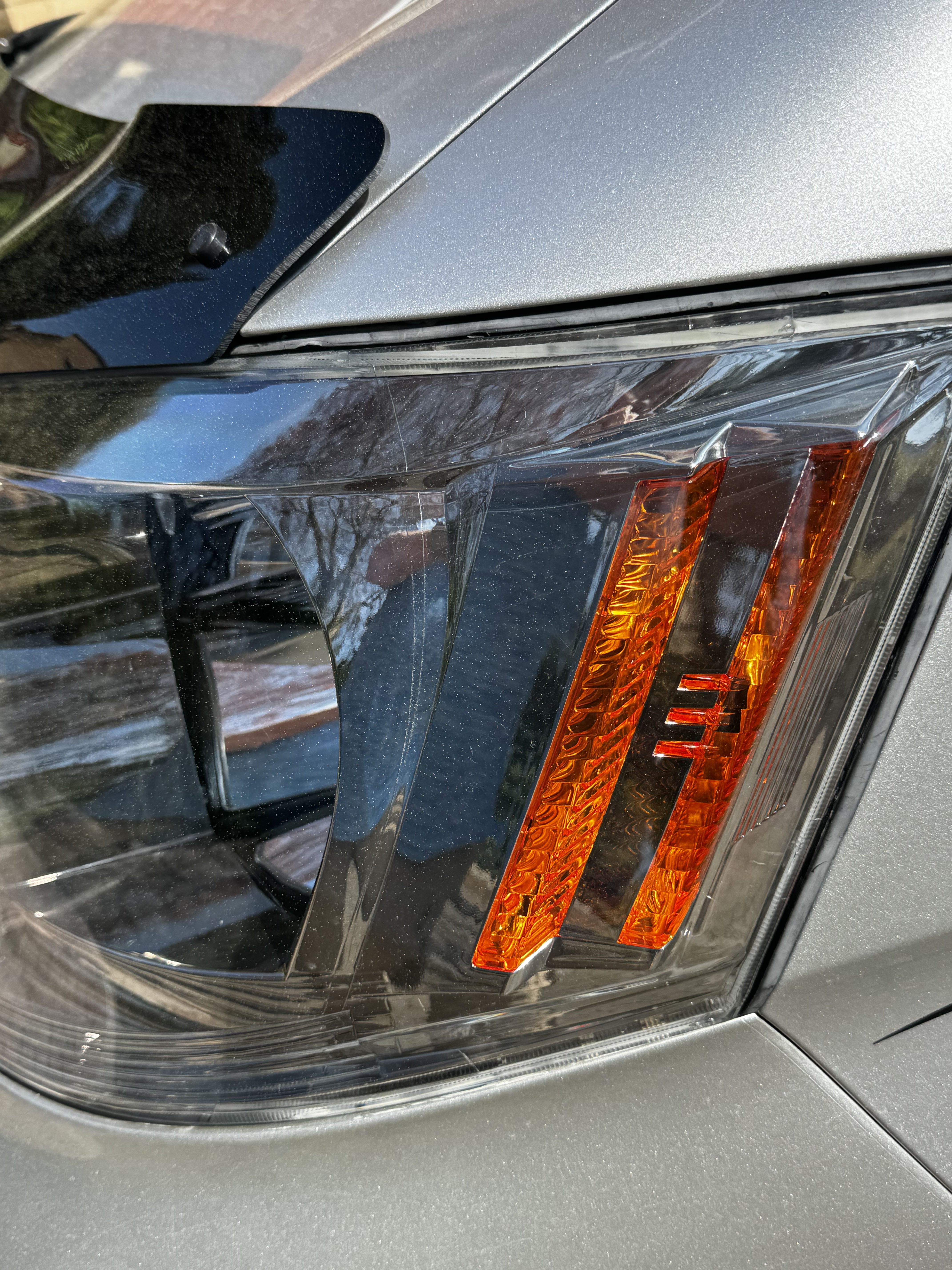

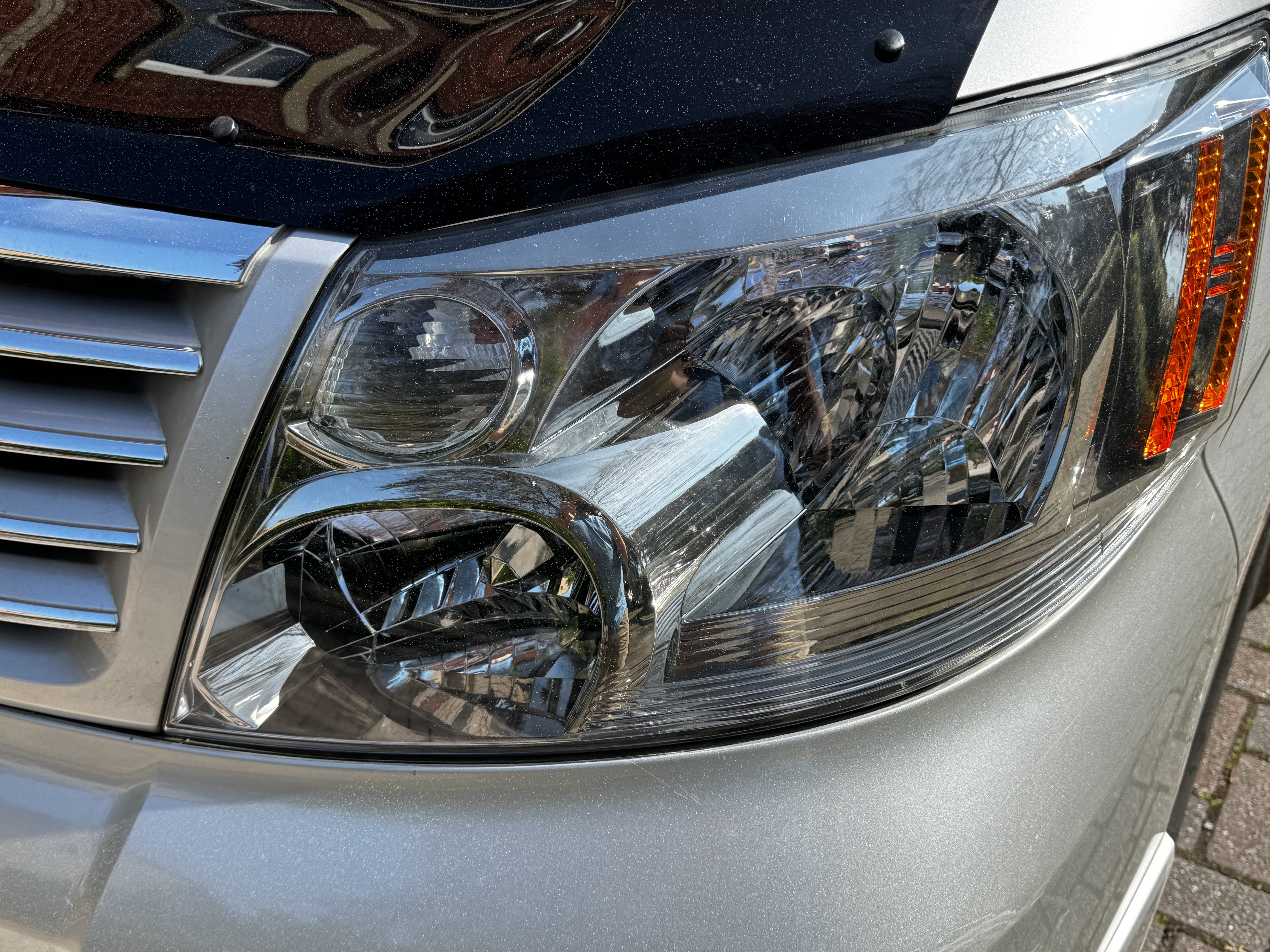

I've recently changed the lenses on my alphard. I purchased them off Temu. They took a little while to get over here, but we're well packed and look great now I've fitted them. Changing them was a little difficult due to the sealer used. A heat gun to soften it and a gentle leverage was needed. I'll get some photos of them.if you like and I could send you a link from were I got them.

A full morning. Once I'd done one it was quicker.

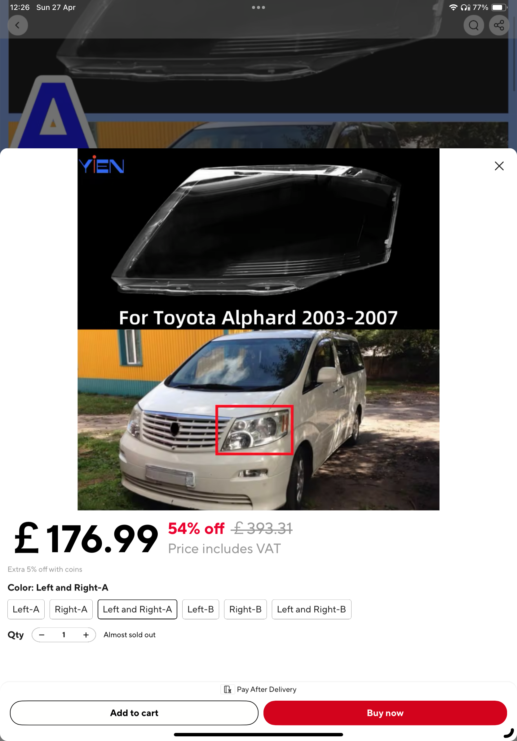

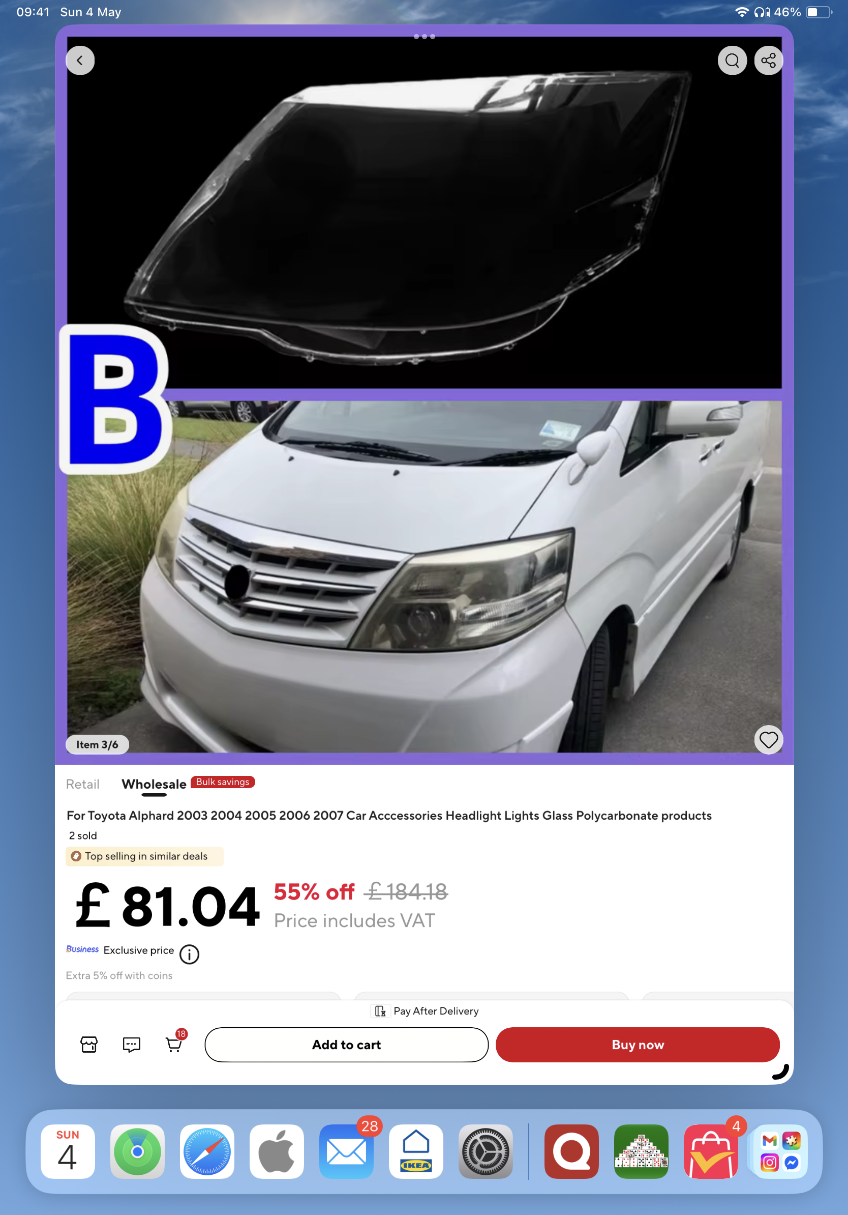

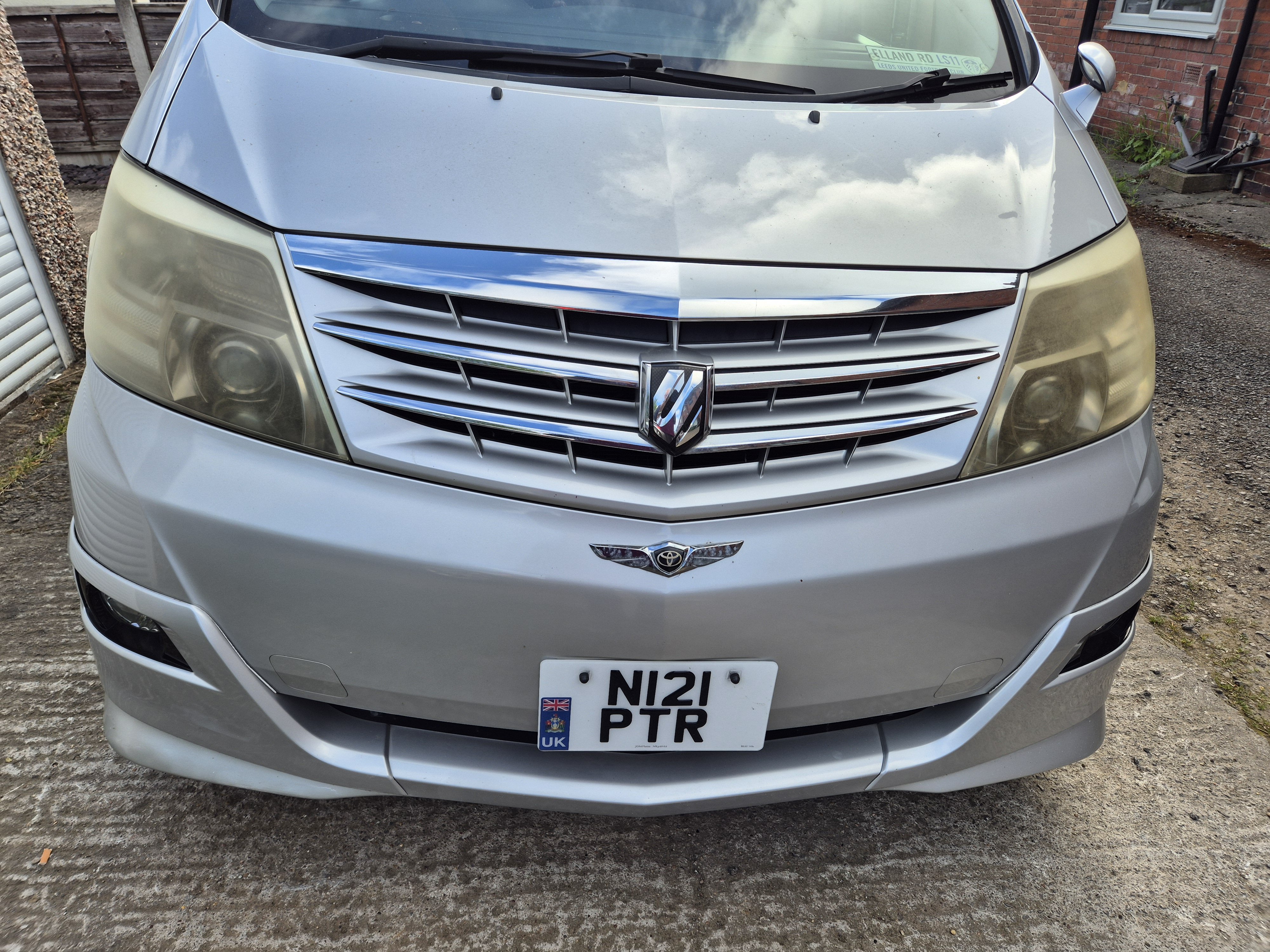

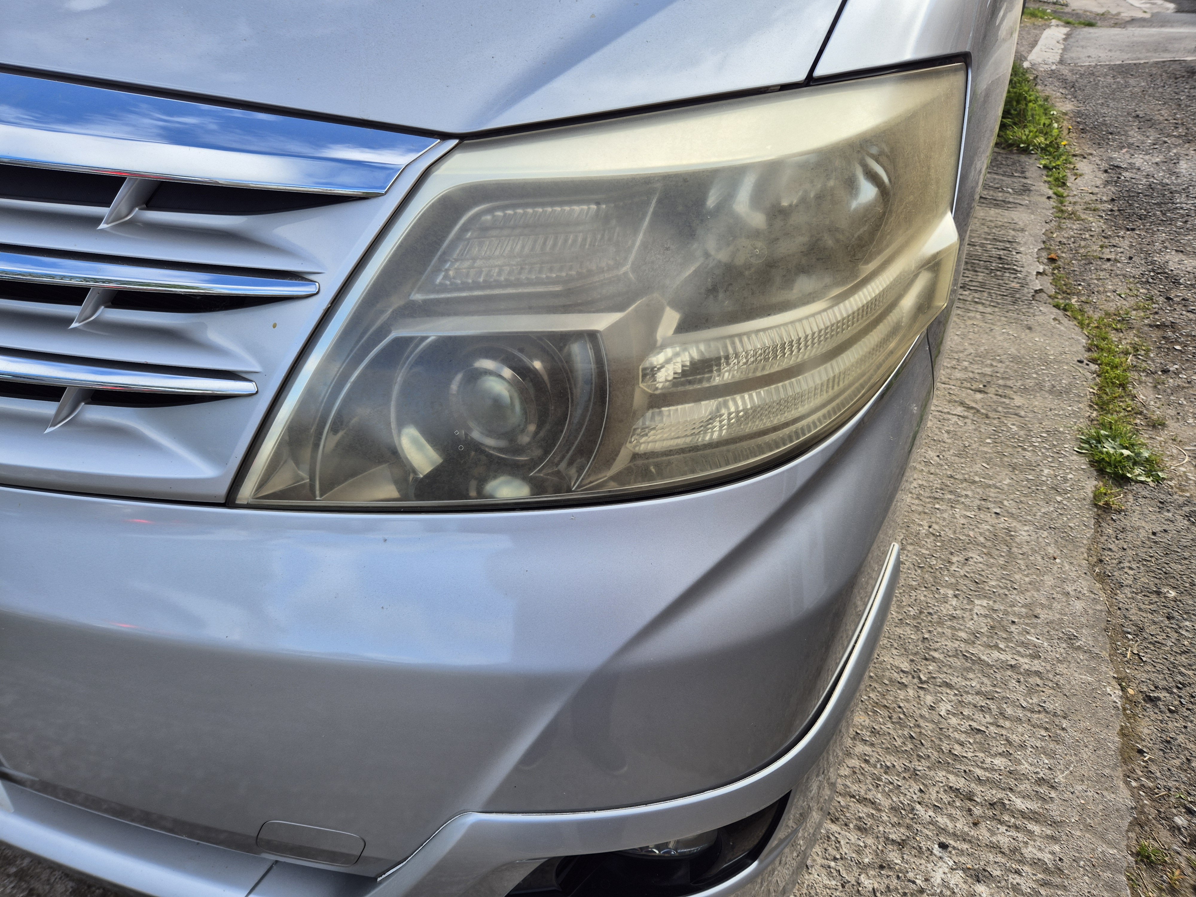

Hi there looking great. I'm not sure which type to get for mine as there is two different ones on aliexpress A andB. Pics of mine 2005 Alfie.

Okay, so i've managed to clean it right up, but it took about an hour for just one.
1. mask off all paint work
2. get the following grit sand papers on a drill 250, 400, 600, 800, 1000, 1500, 1800, 2000, 2500, 3000
3. work with each one going one way and then the next one the other. (keep it wet)
4. then use polish to buff the head light and finally clear UV paint spray to clear coat it.
They turned out like new. Took some elbow grease and some time. :)
