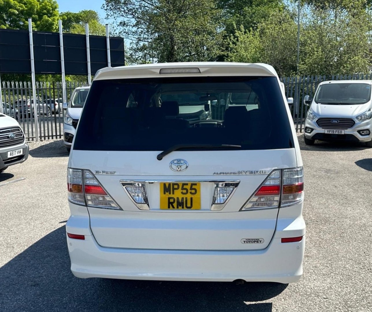

If you photograph the rear light clusters, we should be able to tell you which variant you have.
The early vans have smaller light clusters.
My guess is yours is facelifted; and, if so, should be compliant.
Check your registration on TfL, Transport for London.
There are photos of the rear light cluster further up the thread.
I've just checked and the Ulez charges and congestion charges apply to this one.  I live in the North West, so currently we don't get penalized for driving older cars round here.  I do have an EV if we needed to go somewhere that did charge.
Edited by Bracey
Sorry, so there are. Gen 1 non-facelift.
