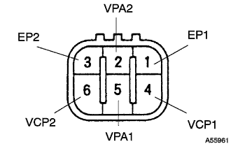

As I don't think there is a kick down as such, you could check the accelerator pedal connector:
  1. Accelerator position sensor resistance check
    ../../img/a055961.png
    1. Use a Toyota electrical tester to measure the resistance between each terminal of the connector.
      SST
      09082-00030
      09083-00150
      Reference value:
      Terminal number Reference value
      2 (VPA2) ←→ 1 (EP1) 5.0kΩ or less
      5 (VPA1) ←→ 3 (EP2) 5.0kΩ or less
      4 (VCP1) ←→ 1 (EP1) 1.5-6.0 kΩ
      6 (VCP2) ←→ 3 (EP2) 1.5-6.0 kΩ
The code appear when i run a car with kick down up to the lamp.
So it is abnormal from accelerator pedal ?
Because I start engine 30 minutes without driving, the code did not show up.
The engine is normal, Air condition is normal.
After checked , below is show data to low. just only 0.519 kΩ
Can you help me to clarify , What I should do?
If the result is not match to your data, How should i do next?
