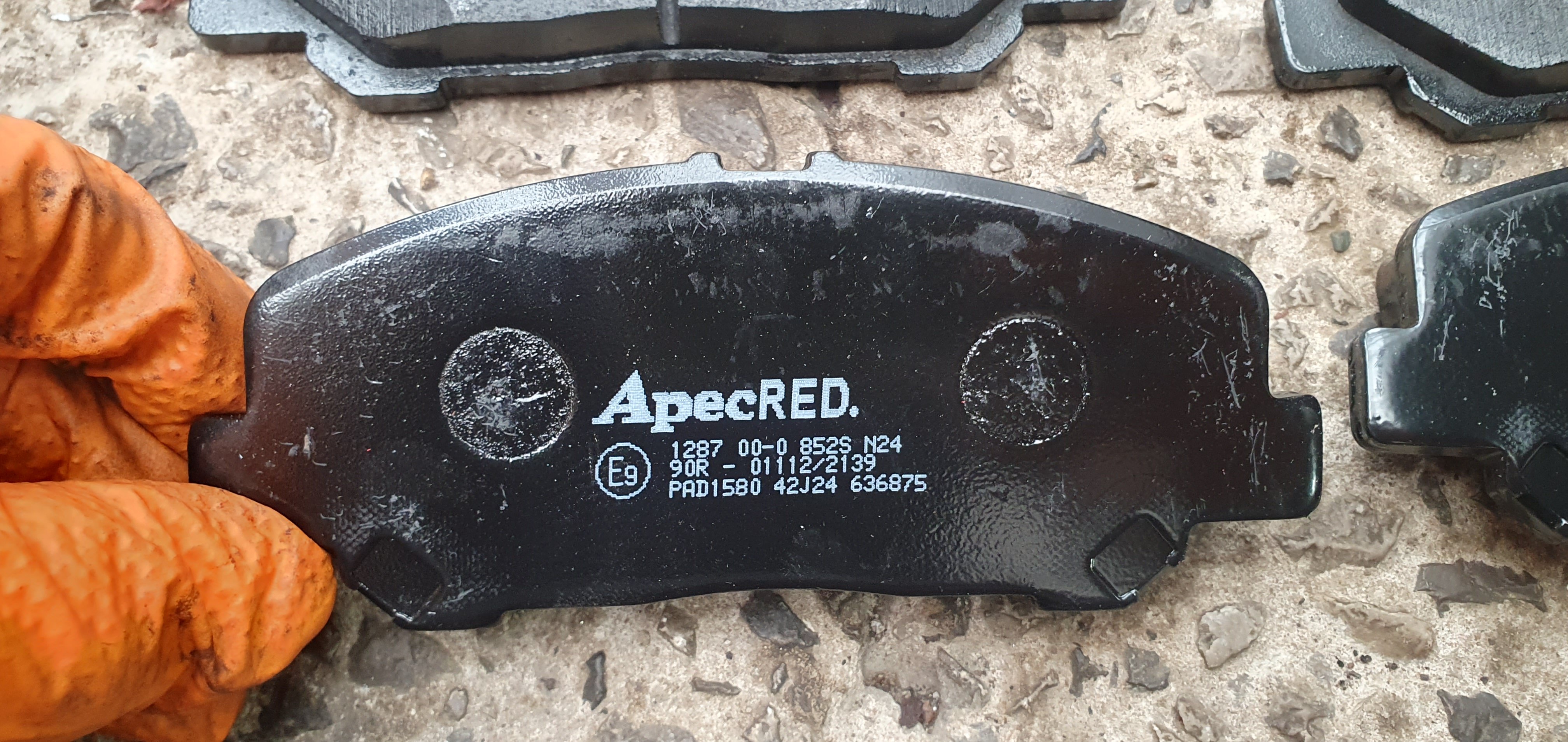

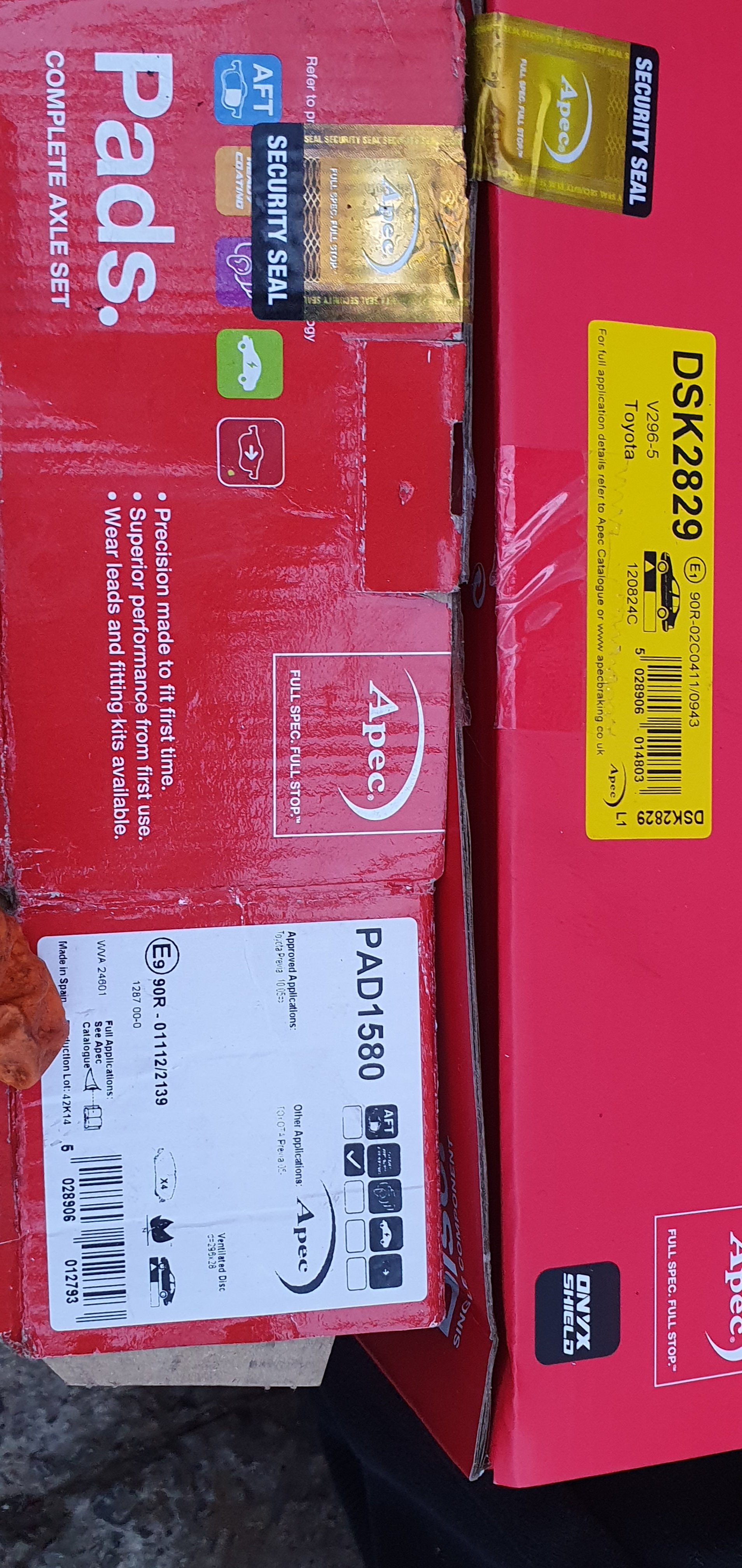

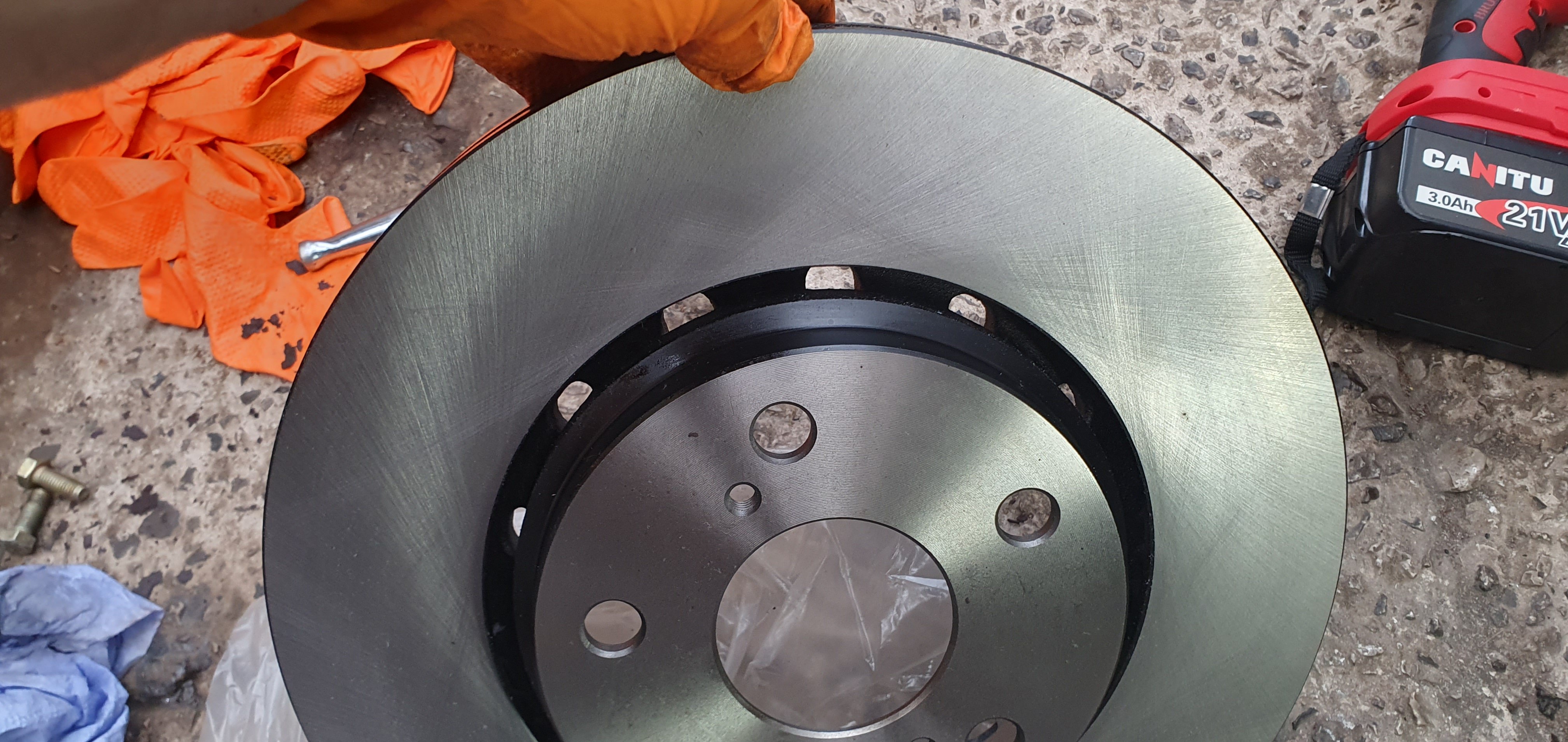

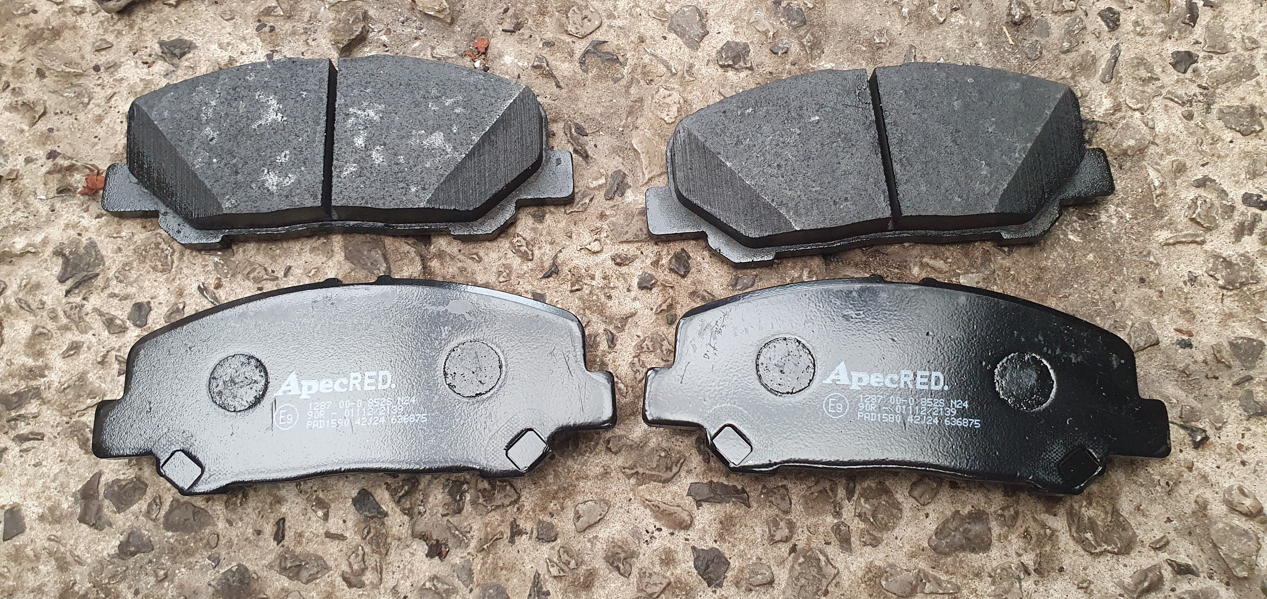

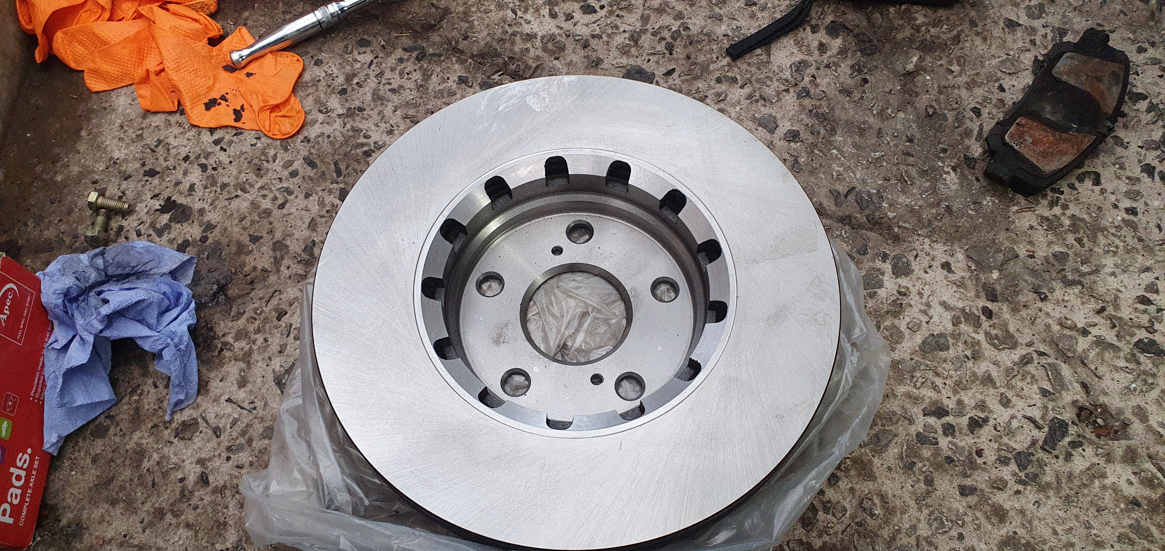

I have only done the front, and I used Apec discs DSK2829, 296mm diameter, Toyota 43512 28190, and Apec pads PAD1580, Toyota 04465 28520, and have found them absolutely sound.
They are certainly a heavy piece of kit!
From those numbers - but only if Lee confirms the originals for yours are those - you can cross reference to other manufacturers.
