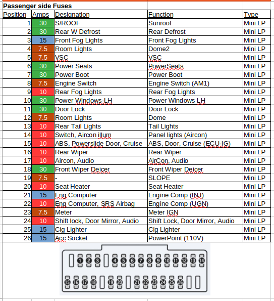

Looks like it's a 15A fuse in the passenger side - fuse no. 3.

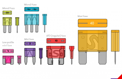

You will need a low-profile mini (bottom left) fuse:
Thank you.  I have changed the fuse and checked the nearside bulb, which is good.  Hence wondered if there was a relay for the 55w bulbs.
