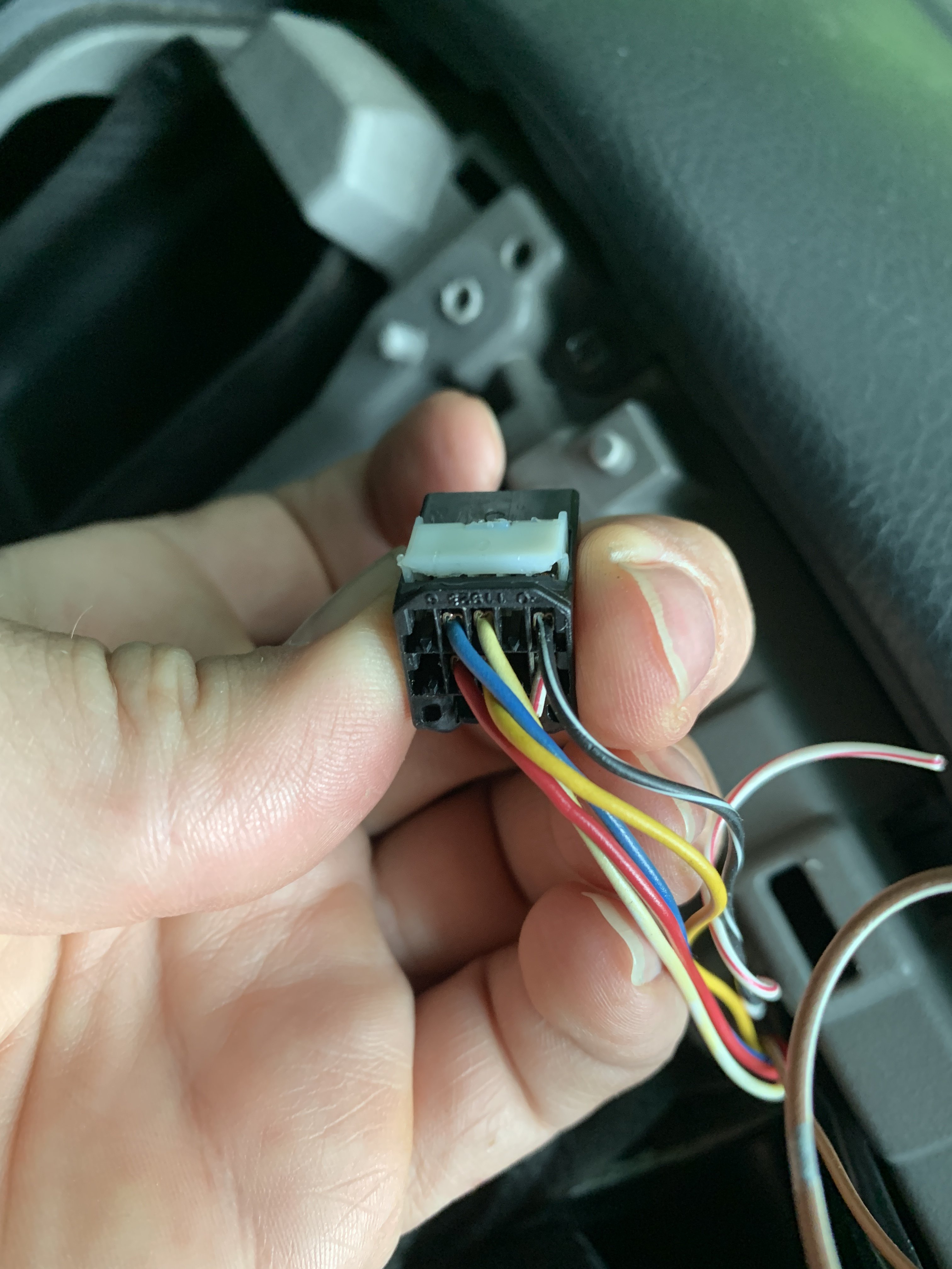

i bought a converter from incartec but its for a different plug type (4 pin) my original head unit uses a black 10 pin connector with 8 wires fitted

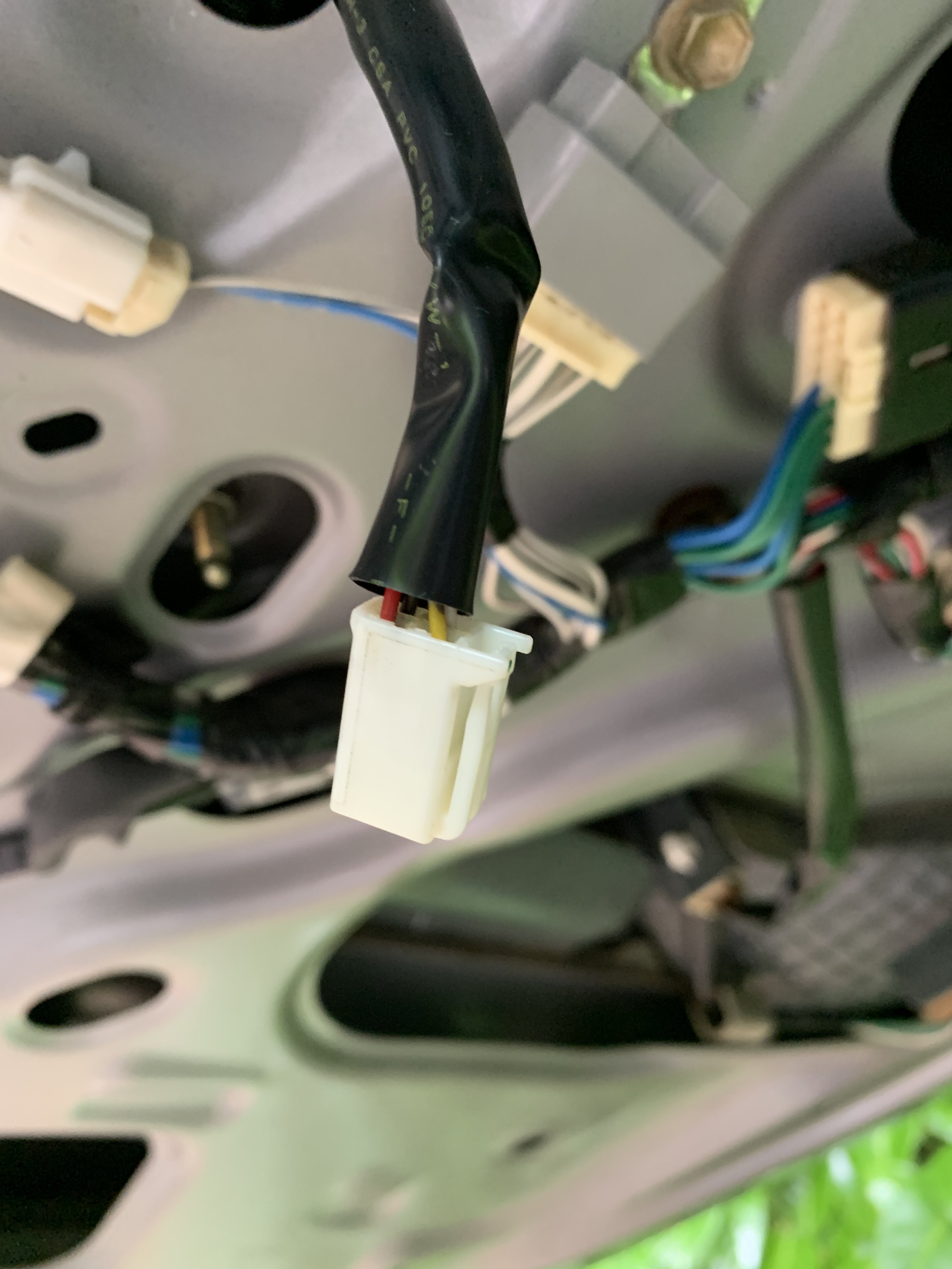

i cant figure out a combo that will work with the 4 wire input so want to remove the camera and cut out the loom just to confirm the camera will work at all with the pioneer. Under the tailgate panel the camera uses the same 4 pin plug that the incartec kit came with so i feel hopeful
if that all fails ill buy a new camera and hopefully fit it in place of the stock one
Edited by Hario
Here are the plugs, in case anyone can suggest which wires are which
the black connector also had 2 brown wires which are removed in the pic
