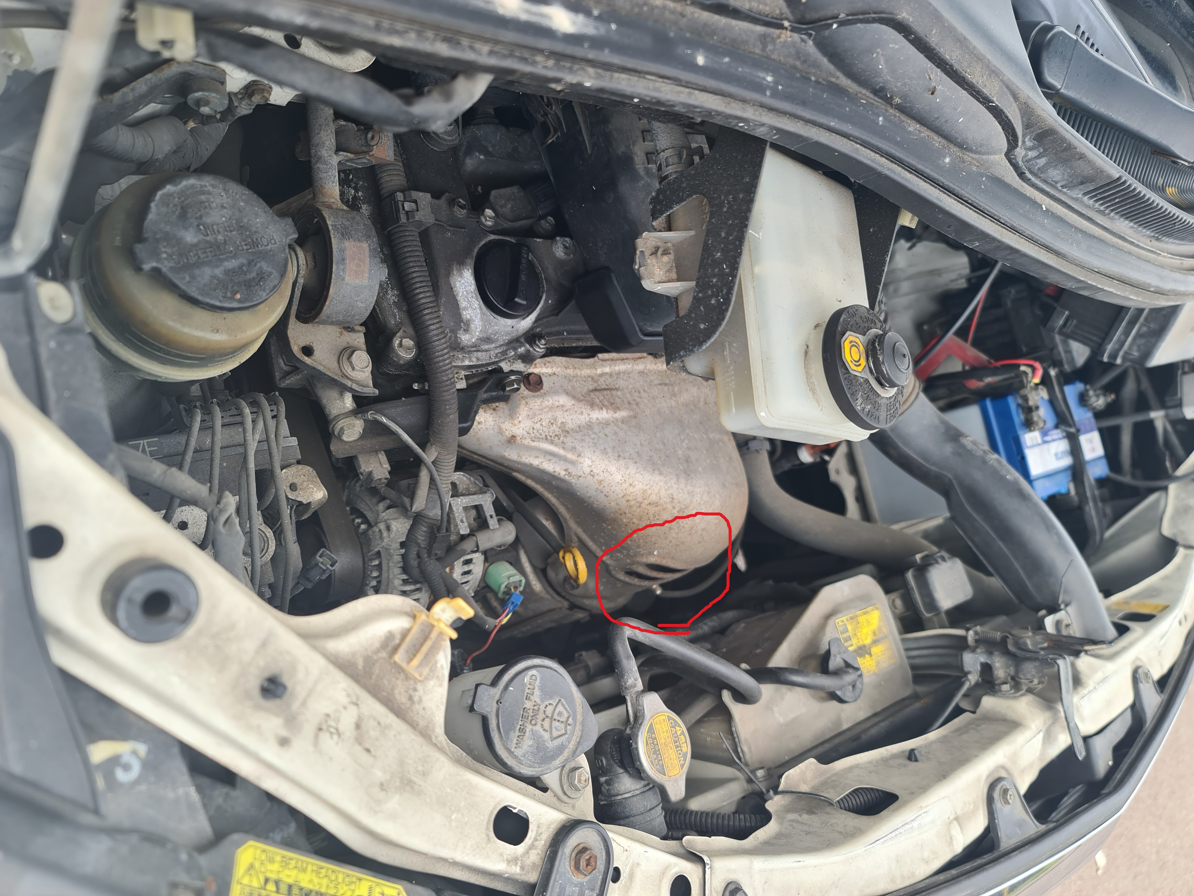

If you haven't located the fuel lambda sensor look at the exhaust manifold cover behind the radiator.
I also changed the fuel filter and the air filter - which may have helped but less so that the sensor I would say.

Hello Kate you got 2 sensors one is called a fuel ratio sensor which is top one close to manifold this is the most common one to bring the code up if this failing it will run rich if you pm me your reg no. I will give you part no. And drawing where located and link where you can buy it
