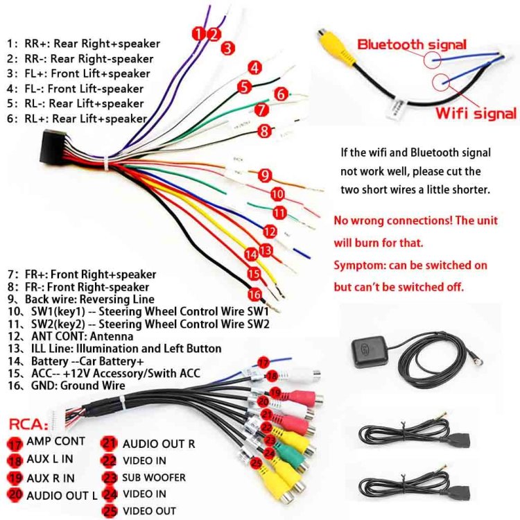

This is your standard style loom for Android, Can you share a photo of what you are working with in the dash?  If you have the factory amp it will be hiding under the passenger seat, If you have an aftermarket amp hiding in there just pop the bonnet and see if there is a power cable and fuse.. Would at least be 8 Gauge so easy to identify.
