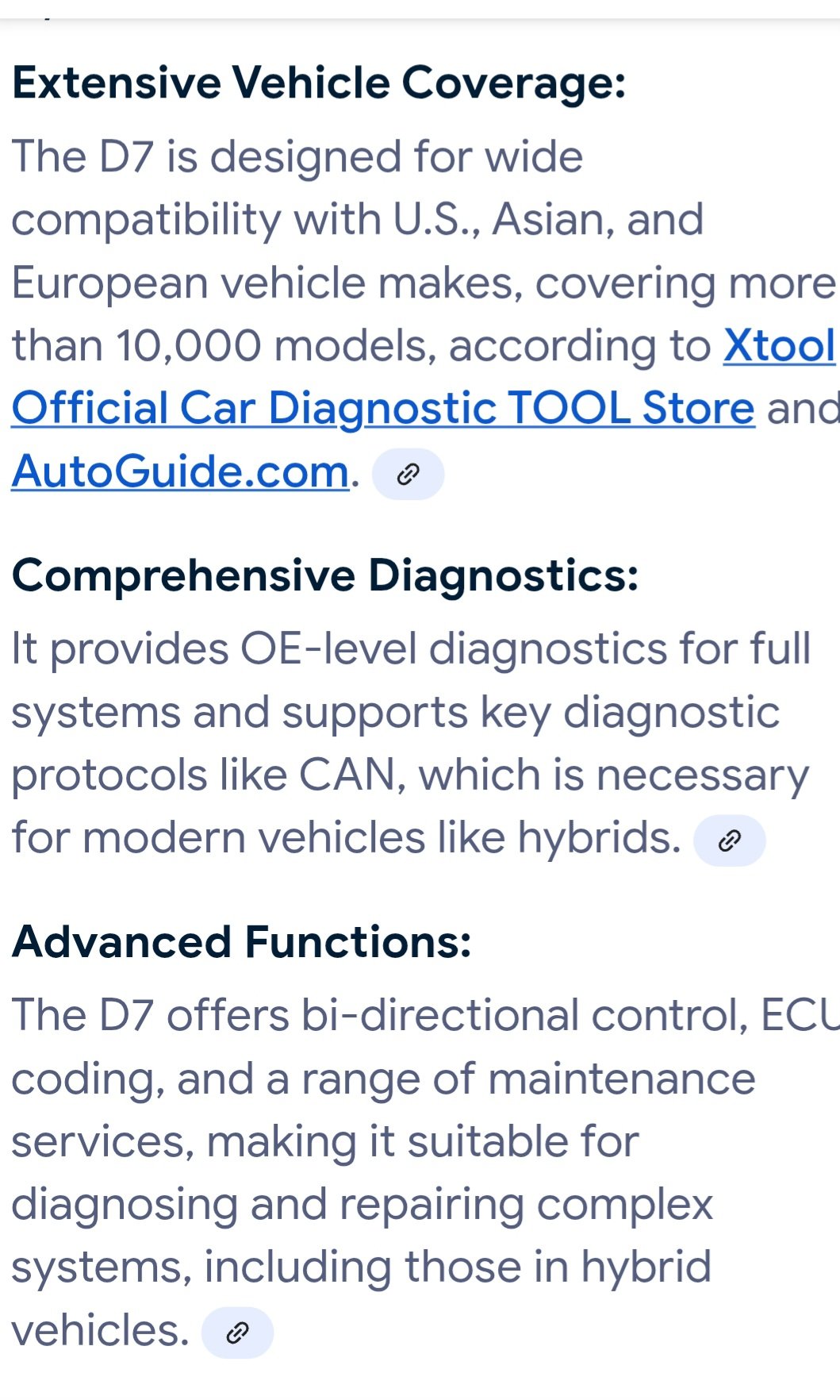

I have a D7 diagnostic unit by Xtool, and it works with our 08 Alphard 3.5.
"I have a D7 diagnostic unit by Xtool, and it works with our 08 Alphard 3.5."
Thanks for the tip - is your Alphard a hybrid? - I was told by one garage that their code readers worked with the standard models but couldnt read hybrid codes.
Ours not a hybrid
It would be worth getting Toyota Techstream on a laptop as I suspect the code readers won't work with early hybrids. The new Topdon reader is said to work on most Alphards but hybrids only from 2013.
