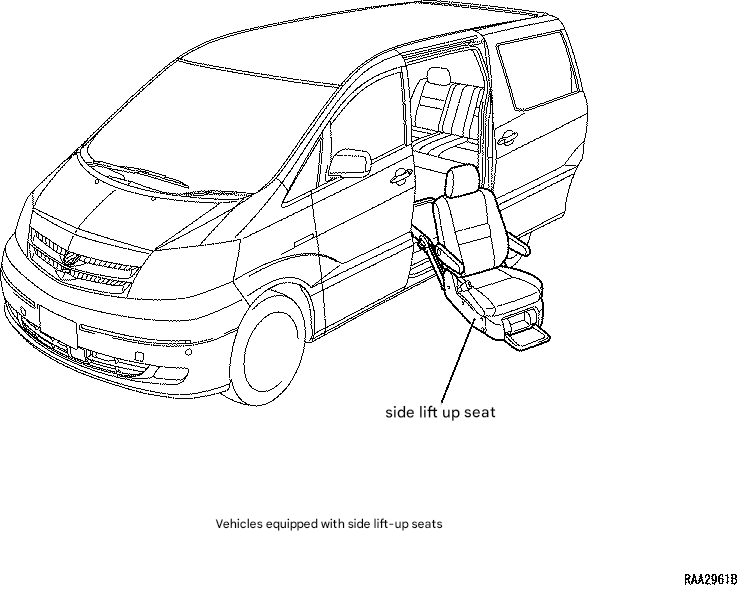

A power seat mechanism and side lift-up mechanism are available on the left side of the captain's seat as a manufacturer option.
