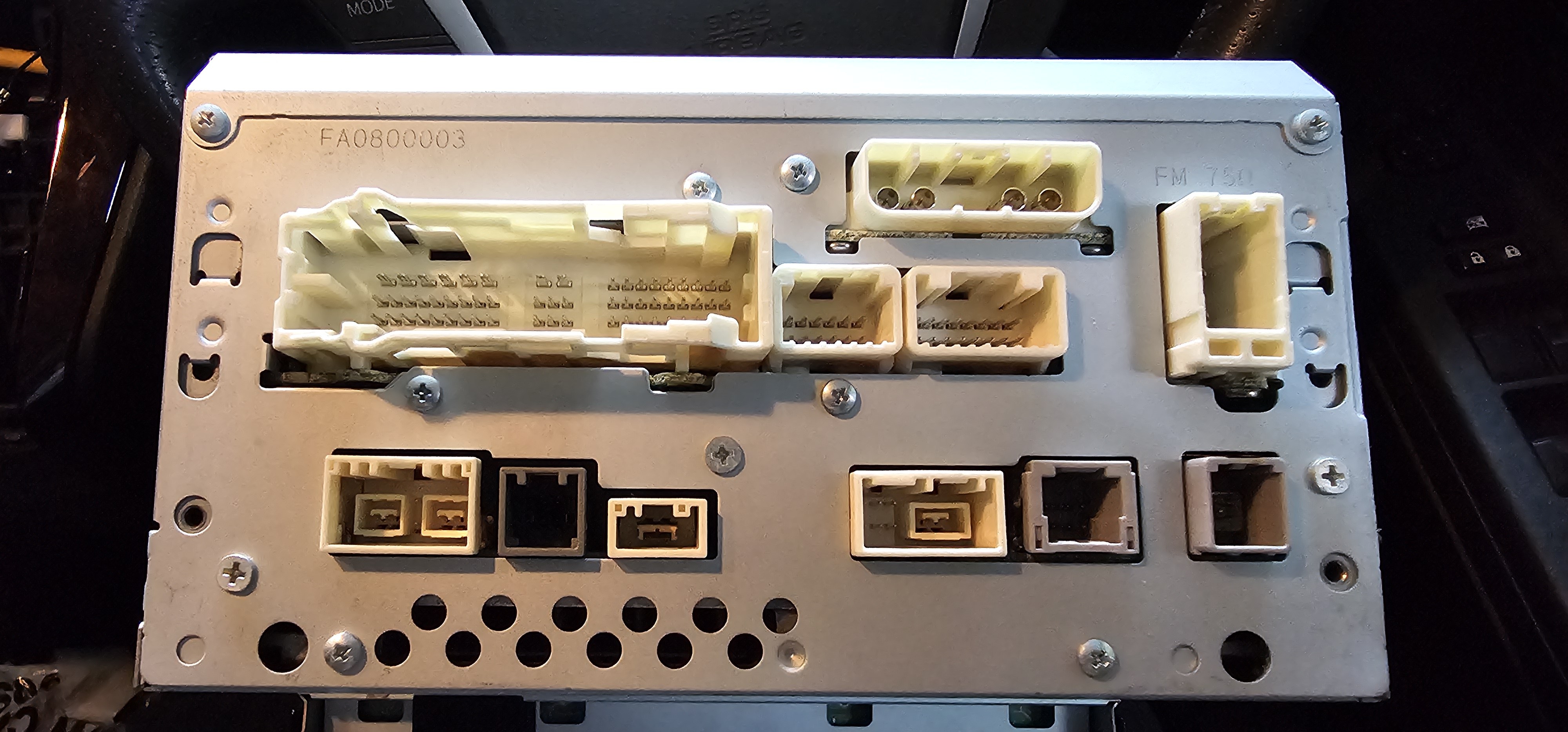

Little side note the wiring at the back of the Panasonic unit was not what I was expecting, instead of a dedicated "video out" it has a piggy back plug going into one of the smaller plugs and out of that has some rcas heading into a splitter black box with rca from the Alpine rear screen.

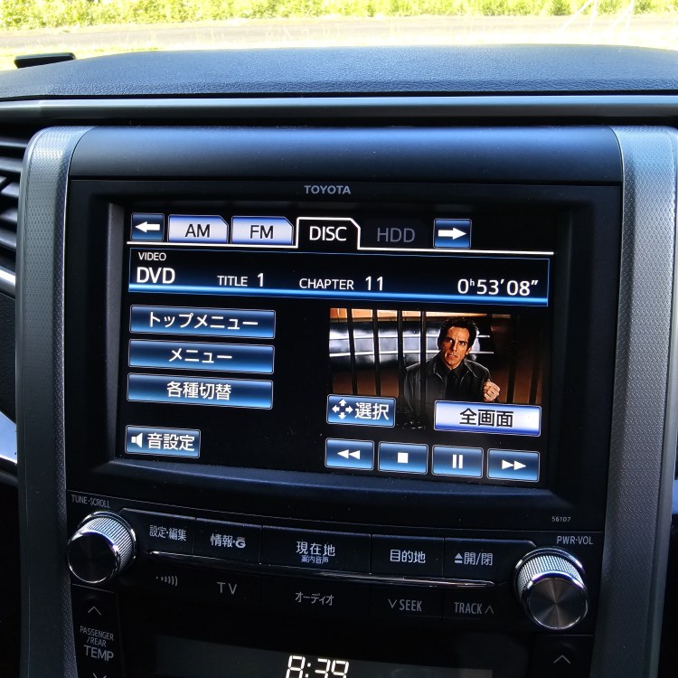

So now the head unit screen just shows blue, no changing with the foot brake on or off or standing still or moving, and I thought that obviously the rear screen would show whatever the front screen was showing, as before...
So I opened the screen and blow me down it's playing the damn video and audio is working fine (it always kept working previously). So off I went for a drive and yep still working! AND no pesky buzzer or dash light either. WINNING!
Some of you might have cottoned on to the one and only problem here, I can't see the front screen at all no matter what so can't access DVD menus, the DVD does auto play so it's not all bad but going forward I will reinstate the micro switch at the pedal but I will cut the wire and join it with a simple toggle switch running up to somewhere within reach, so that when parked I can toggle it back to standard setup and can see the front screen as normal.

Here's a photo of the back.

Yes that's how I would have thought it would be like, that the rear screen would continue to play while only the front screen turned off while in motion, makes sense to me but because the rear turned off as well it was very frustrating for that to be the case, and I thought it was because of the way it was wired - no front output = no back output but that obviously is not the case as I have just proved.

The front screen is branded toyota in the outside but it is Panasonic when you take it out so it's definitely the factory radio. The Alpine could be a factory or dealer option, the vehicle is a Jap import into New Zealand. The wiring inside tells me it's not factory but the unit "looks" factory as in its a great install, there is also an av input at the base of the centre console which doesn't work but I haven't actually checked if it's hooked to anything.
