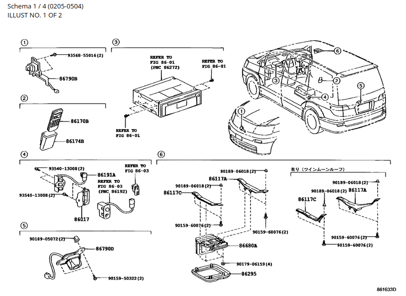

Have you tried amayama.com to find part numbers? For mine (2005 facelift) the part number looks to be '86790B - CAMERA ASSY, TELEVISION, FR' with additional codes for different colours
From: https://www.amayama.com/en/genuine-catalogs/epc/toyota-japan/alphard/ANH10W/36377/body/8606

I've finally found the part number on amayama - thanks for the suggestion. The price is quite eye-watering especially as I have no idea if it'll actually work with the HU I have. I'll have to some more investigation before committing.
For future reference:
86790-58090 / 86790-58091 - 2008-2011
86790-58091 - 09.2011 - 10.2011
86790-58130 - 10.2011 -- 2015
(0804-1110)
My Alphard is built 07.2011 but has a facelift bumper (and grille I guess) which makes things even more difficult. Could have been the reason it was removed in the first place...
