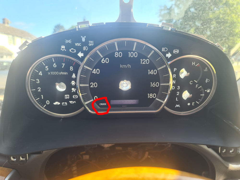

In case you don't already know - this is what the graphic looks like (on my 2005 dashboard).
Taken when I had removed the dashboard to look for blow bulbs, only to find out they are all soldered LEDs (doh!)
