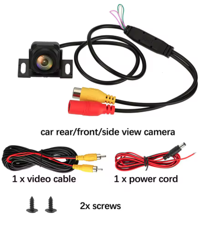

The one that I have that works is this one (170° Car Front/Rear View Reverse Parking Camera Waterproof Night Vision Camera):

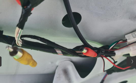

The ends in the car are these:

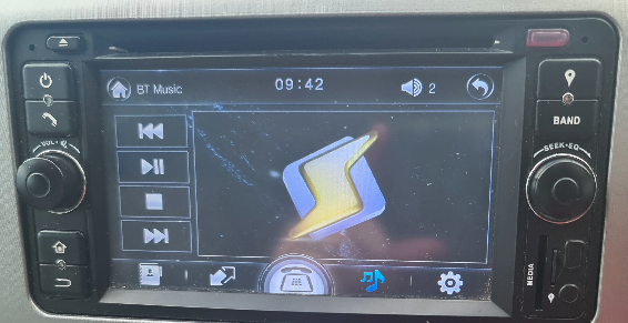

The head unit is rather old by the looks of it:

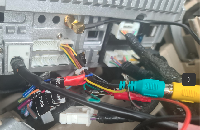

and the back of it has the expected tangle of wires:
So this has more to do with video output types than anything else - is 'AHD' a new format that uses the same physical connectors or something?
Can anyone tell me what camera features I should be looking for, or maybe the head unit replacement journey is about to happen?
