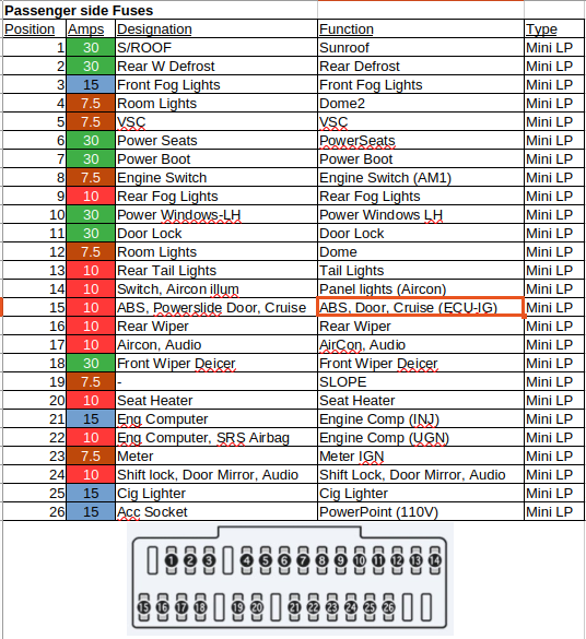

On my 2.4l 2005 I have the following fuses on the passenger side:

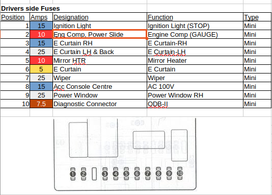

And these for the drivers side:
So if your cruise control and ABS are working try looking at the engine computer (though I suspect this would be obvious if they weren't working).
