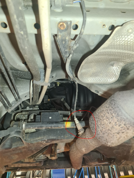

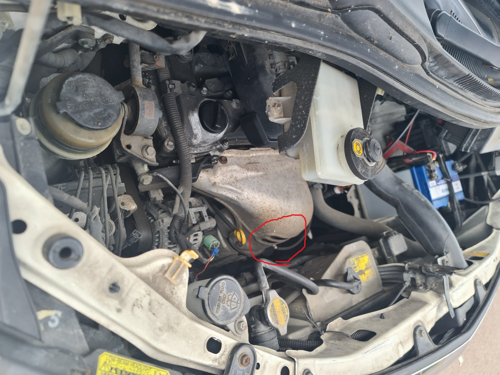

If you haven't located the fuel lambda sensor look at the exhaust manifold cover behind the radiator, that would be the bank 1 sensor. As one of yours is saying bank 2 that will be underneath - see the second picture, on the exhaust under the car - trickier to get to.
Thanks Paul, mines the 3.5L V6 so I have 2 'banks' of 3 cylinders but trying to find the 'pre and post cat sensors has been confusing. I've ended up ordering them all, even though the codes pointed at one, I'd rather not be off the road for 2 months waiting for parts! Cheers I'll share when it's fixed (fingers crossed)

Ah - good point, that would mean a different bank 2 then :-) Good luck in getting the replacements fitted.
