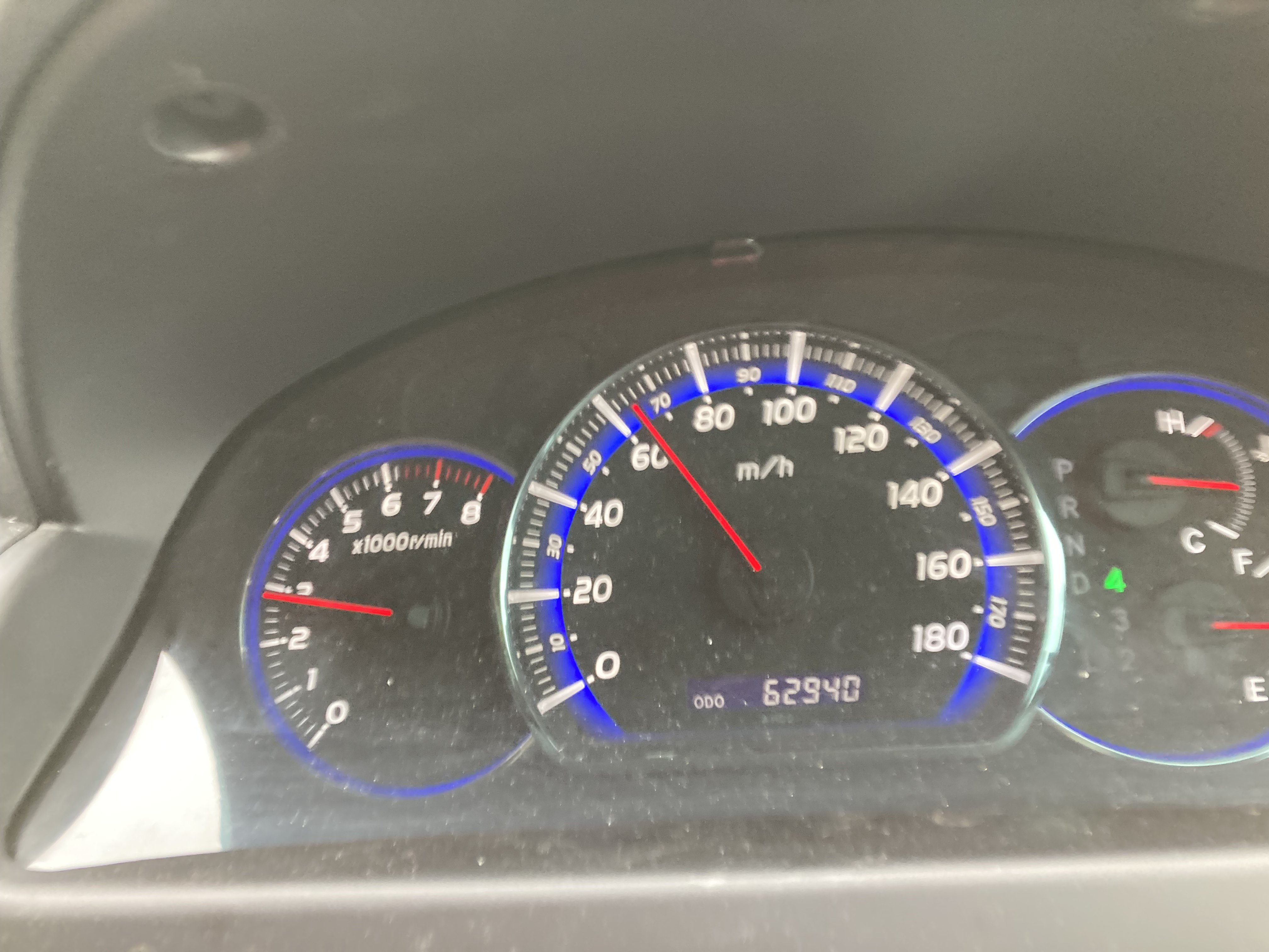

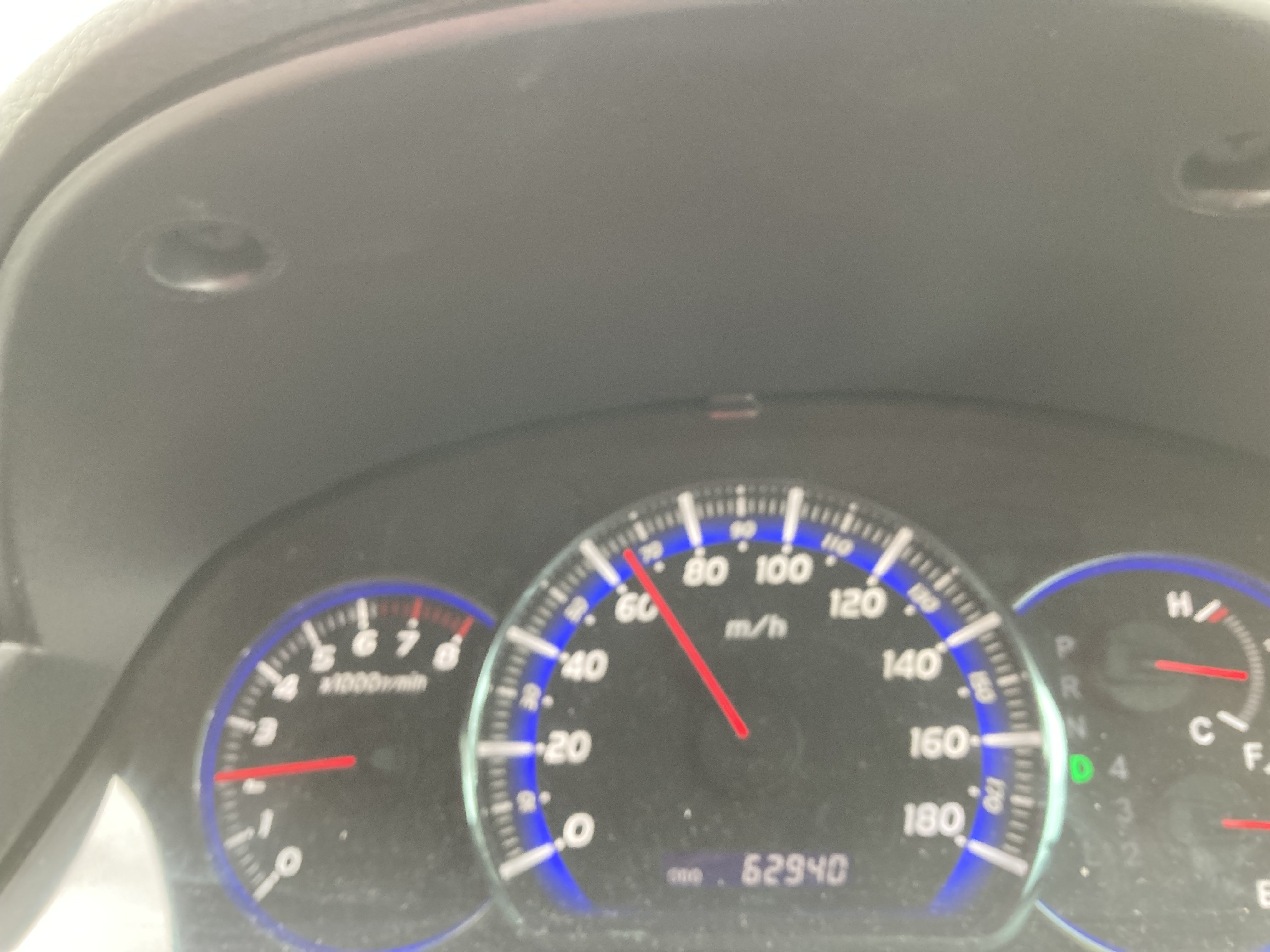

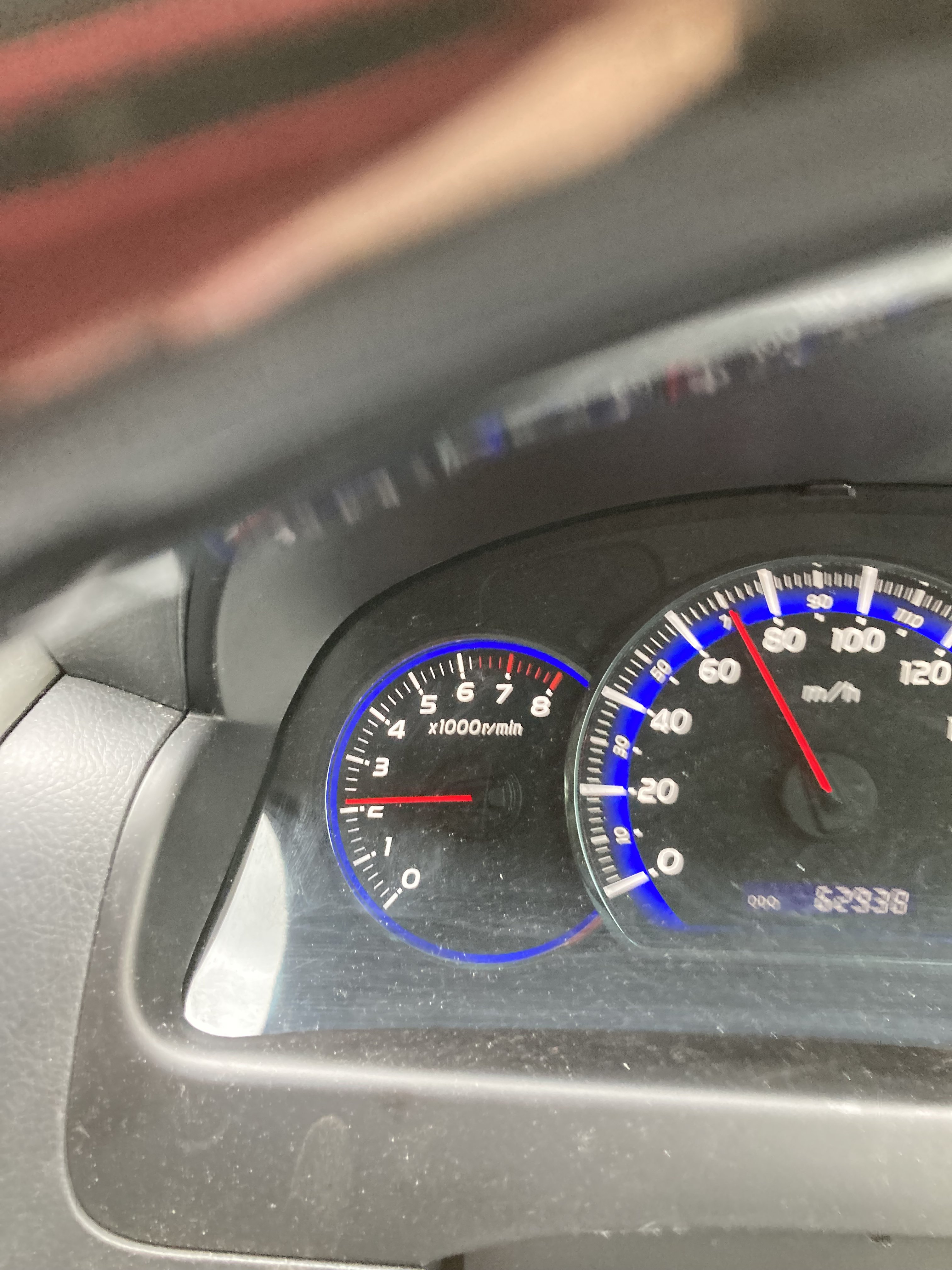

Hi shawn
make Shure you have shift stick in d mode not d4 this will reduce revs you should be able to do 70 mph at 2100rpm
photo1 shows correct drive mode 2 is showing d4 ,hope this helps
