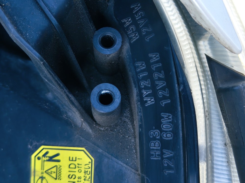

Hi. I've had my Alphard less than 2 years and now need a replacement bulb for dipped headlight. Have discovered (by visiting Halfords and reading my English version handbook) that this isn't simple. Does anyone know how to buy these bulbs and the procedure for fitting one of these - thro a Toyoya garage.
I also want to carry spare bulbs for front /rear lights. Can I buy these thro EBay or Amazon? Or Halfords for the more usual bulbs if I can identify what I need?

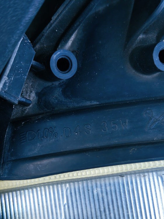

Thanks for that info. I wouldn't have thought to see it embossed in the bodywork. Fancy the Manager of Chichester Halfords not knowing this!

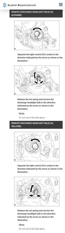

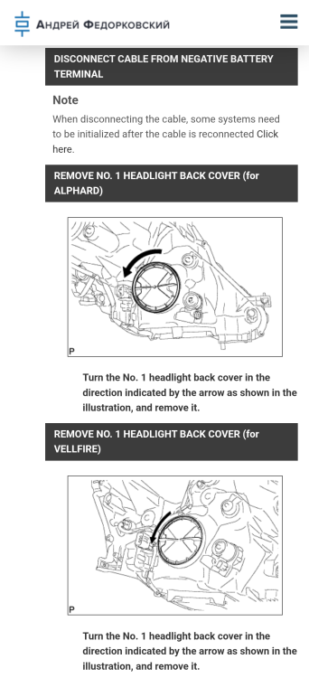

Can I fit it myself? (as in can my son fit this bulb?) I am an older female Alphard owner & don't want o attempt changing bulbs. The handbook says I must go to Toyota garage!

Yes you can fit it, it's a doddle for anyone remotely handy.
Also, check your local autofactors, you will be able to get them from there, and should be a good price.
But then I got a pair of D4S from Aliexpress for £15, by Sukioto from Japan, and they've been in and working since September, all through winter, every early morning on my wife's drive to work.
PLEASE do not go to ANY garage for that job!!!
Cheers, Nev
