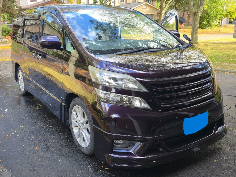

Since I'm new here I figured ill post a picture of my baby. I call it the eggplant. )
