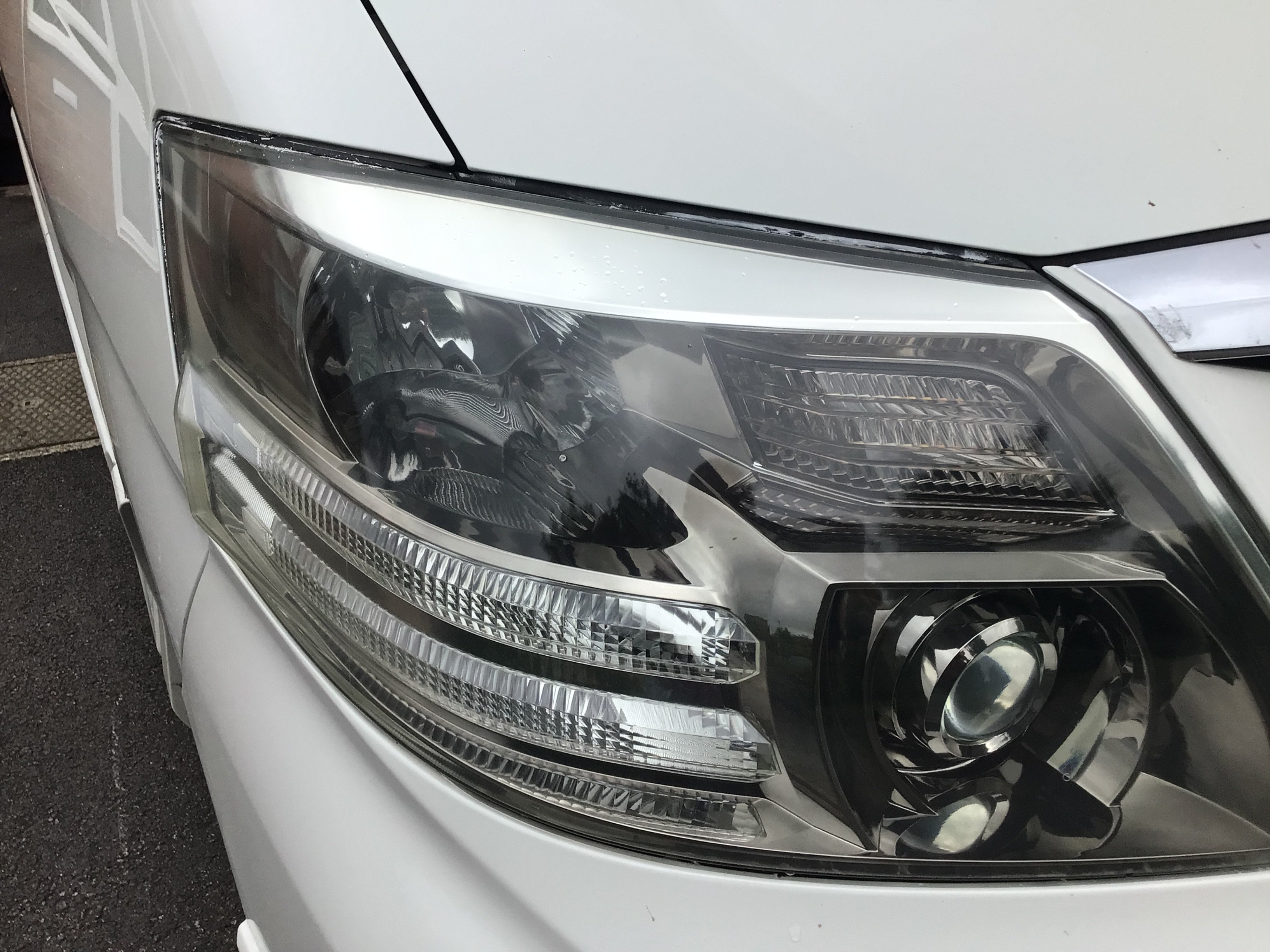

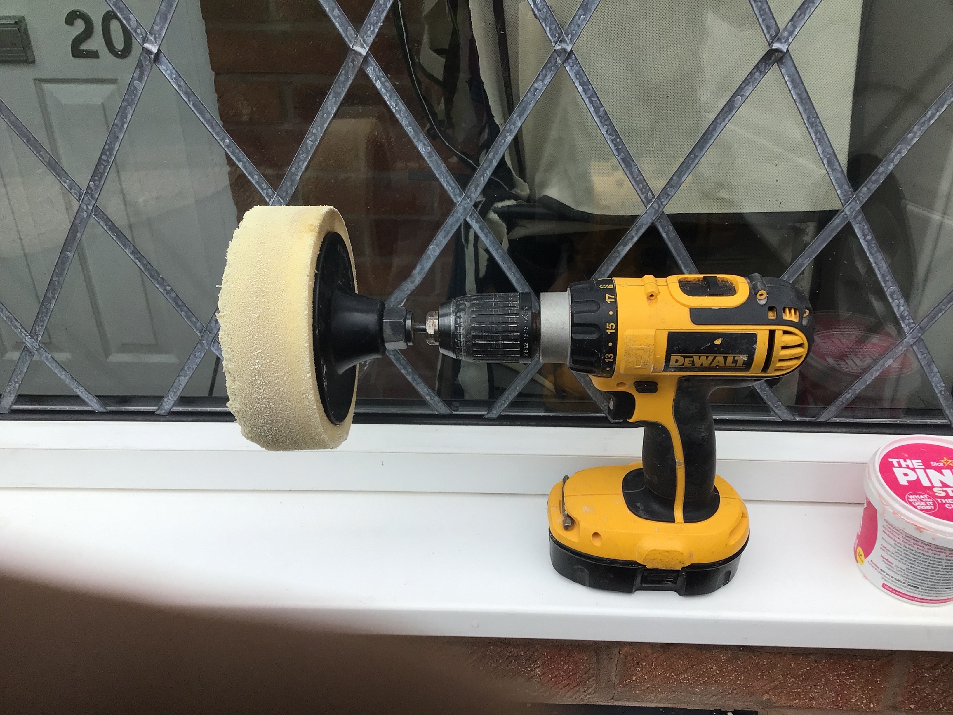

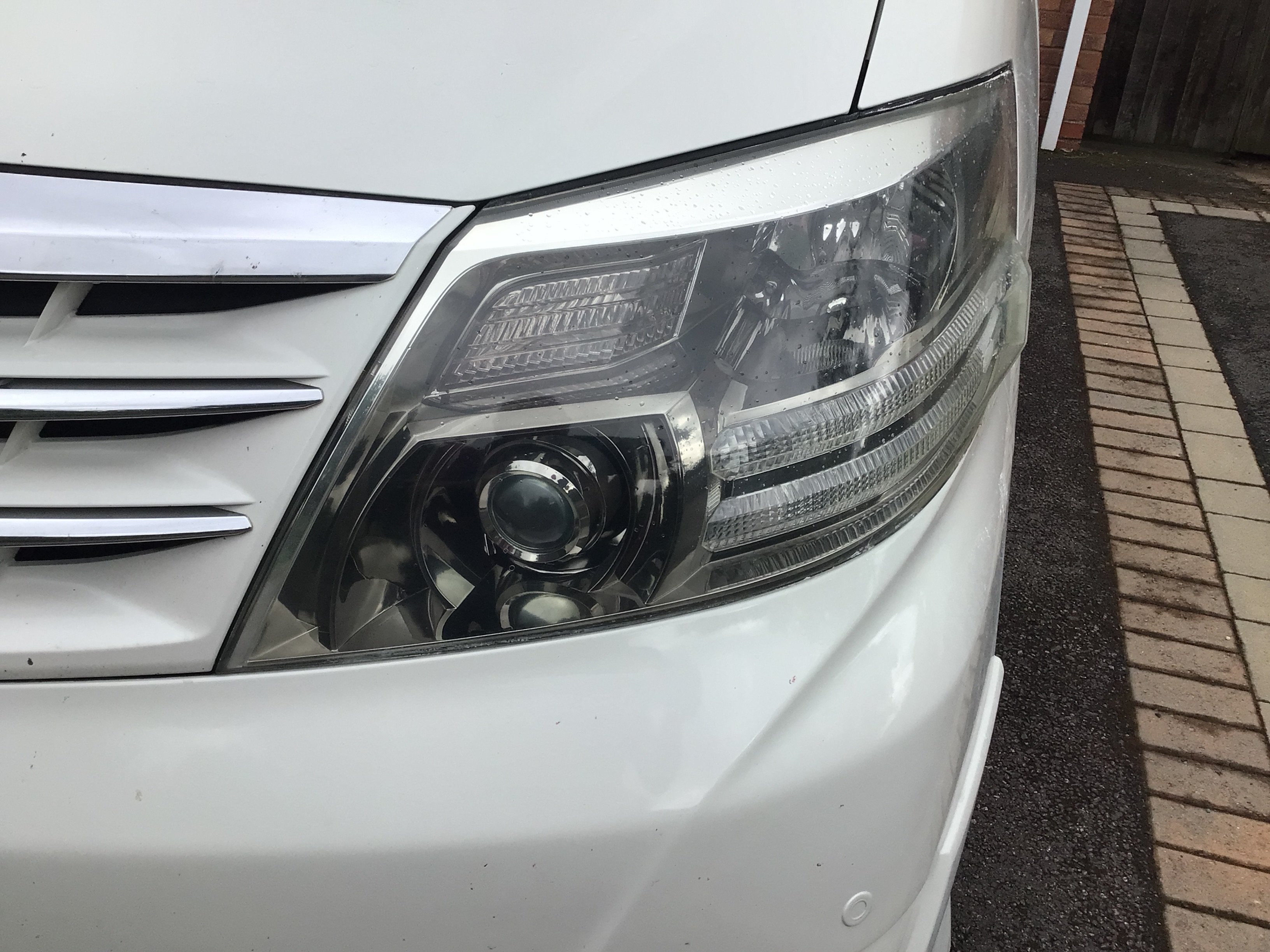

Just finished cleaning up yellowing headlights, started with 1000 grade wet and dry by hand moderate pressure with plenty of water this was followed by the same process with 1500 grade. Using a polishing pad on a drill used something called (Pink Stuff) worked this in well reapplying regularly. Satisfied that this had flattened any blemishes from the wet&dry I then used cutting in compound using a soft pad and drill moderate pressure the results were pretty outstanding.
Great job Mike. much better than mine came out after 2 hours of sanding and polishing...the drill kept bucking and did my head in towards the end.
