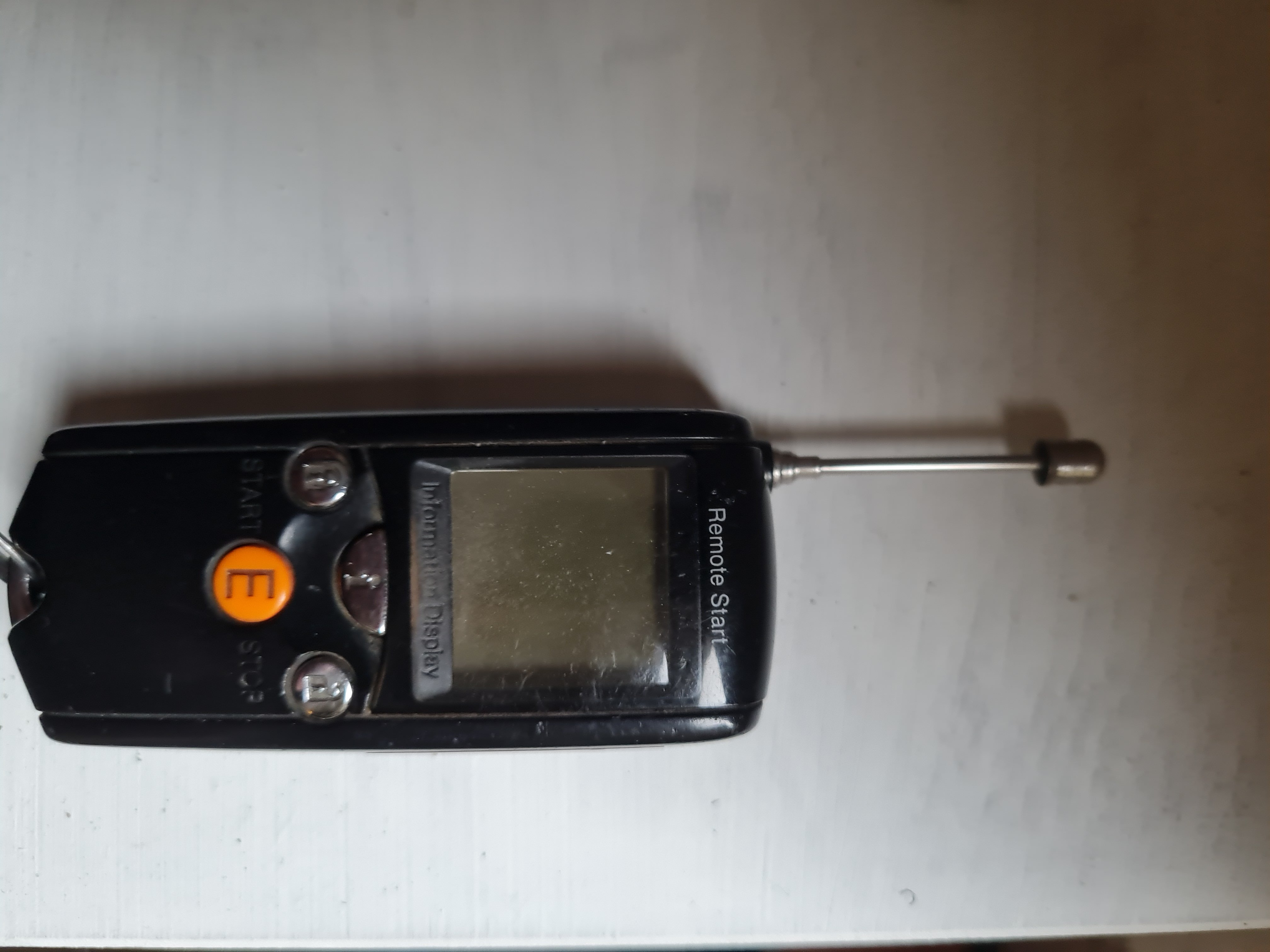

Just purchased a MZ 2006 with the same areal starter. I have pressed the Ii key and the engine shows off with communication to the vehicle. Can you tell me the key press sequence, are there any other required conditions to make it start.

Hi Andy,
You've probably figured it out by now, but for the benefit of others who might need to know:
On your black fob with the pull out radio, you have 4 buttons:
i
Padlock Locked 🔒
Padlock Open 🔓
E (orange button)
To remote start:
Press E, then press Padlock Locked 🔒. If you look below the Paddlock buttons, there is Start and Stop written into black plastic.
The vehicle should now start. If you open a door, the engine switches itself off automatically.
To remote switch of the engine:
Press E, then press Padlock open 🔓
The Padlock keys will remote lock and unlock your doors if you do not press the E button first.
This function is so good on cold mornings - your car warms up and melts the ice on the windscreen whilst you have your breakfast.
