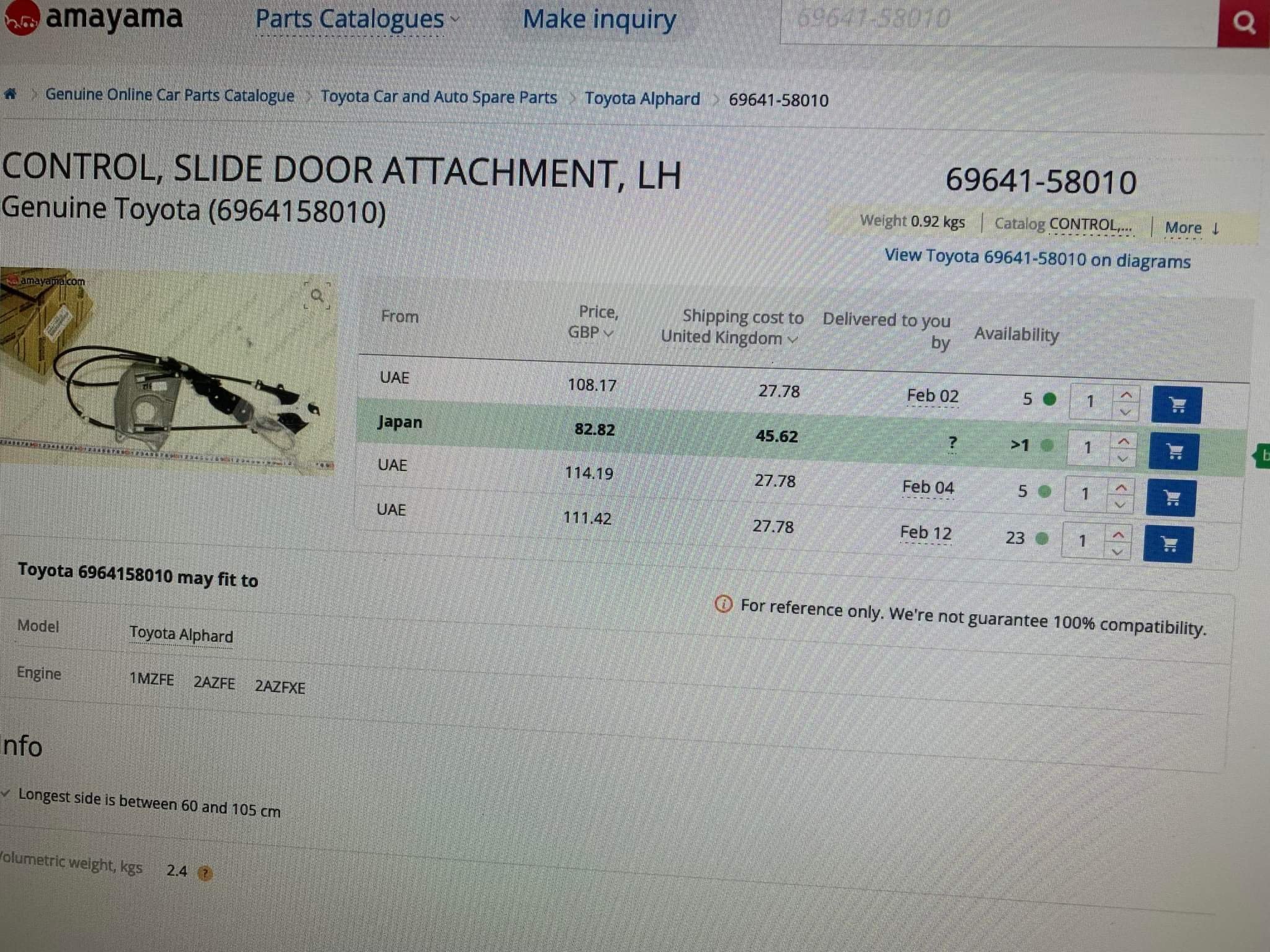

Please forgive me as I'm new to these cars. Bit is this the cable that is referred to above?
The problem with Amayama is shipping costs.
Now you have the part number try Toyota Direct.
They can only say yes or no.
Shipping will be more reasonable.
Thank you. Is that the correct part that fails and causes the door to be stiff etc?
I wouldn't know.
I suggest you send a PM to Picasso. He should be able to help you.
